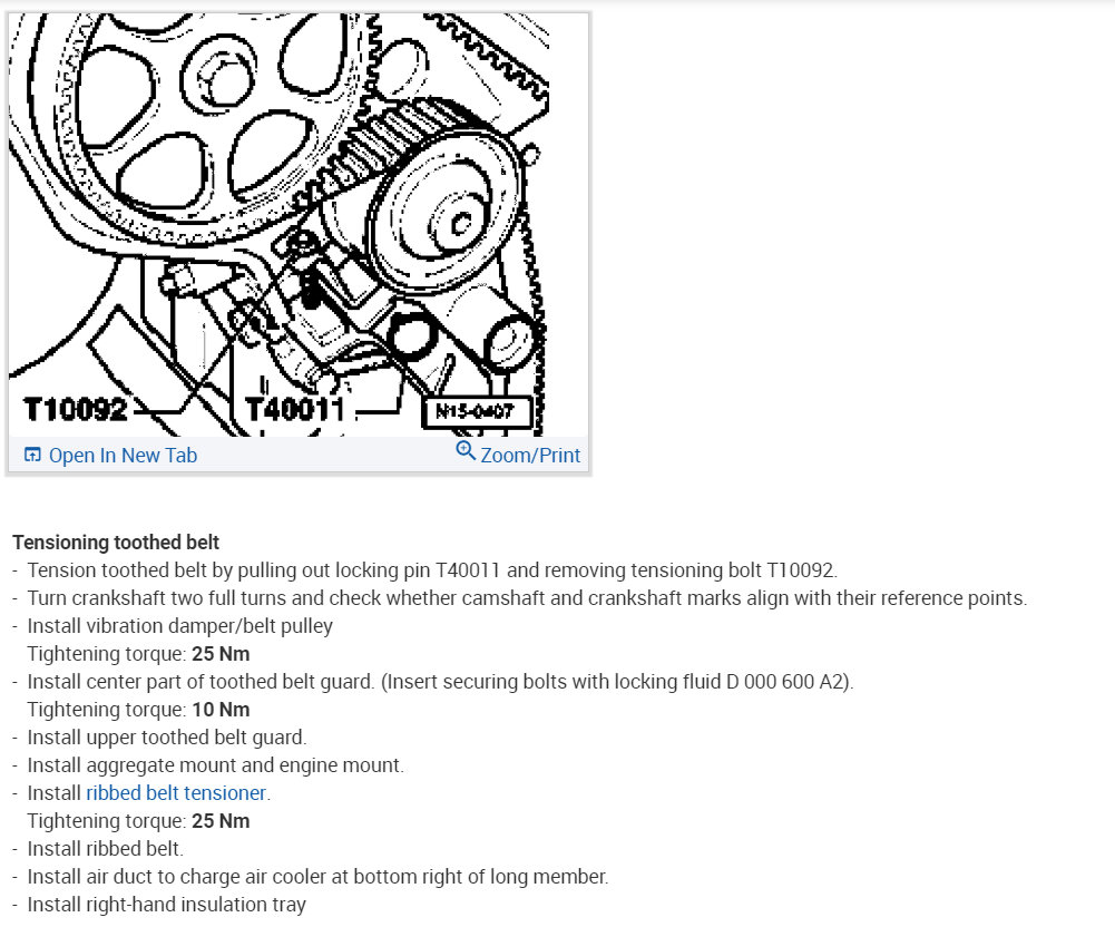

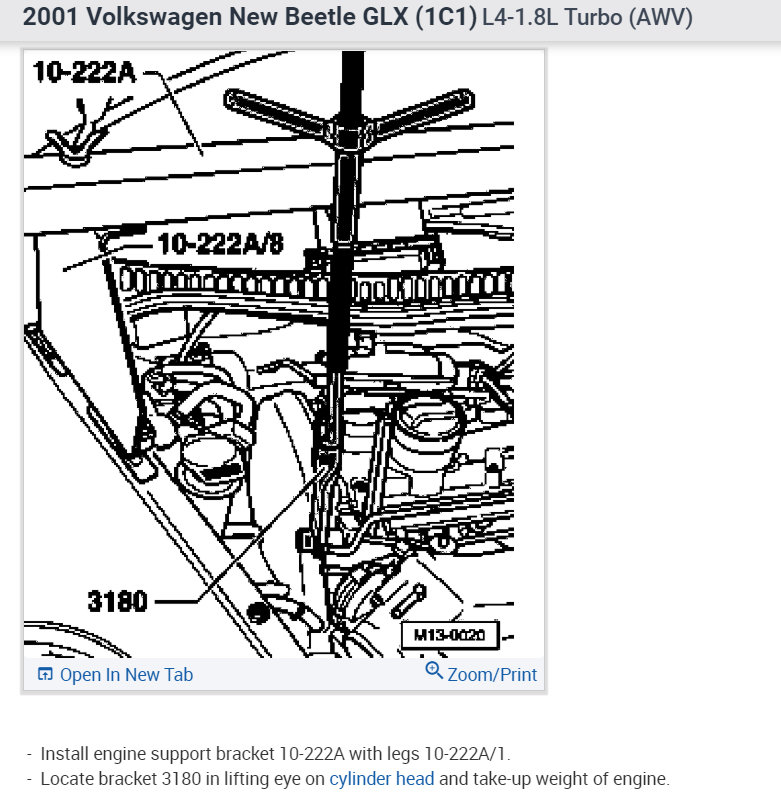

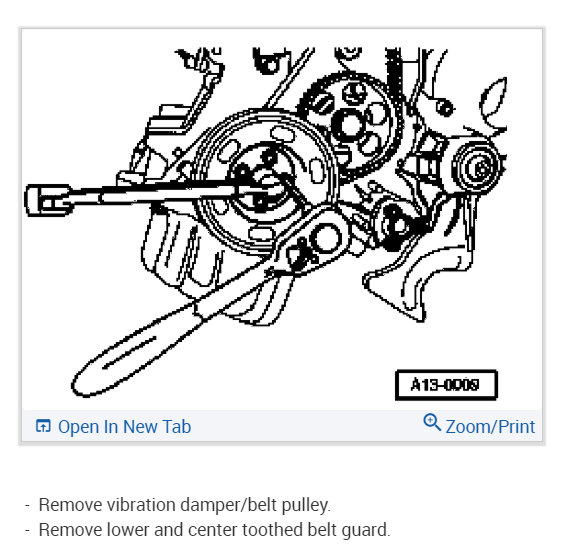

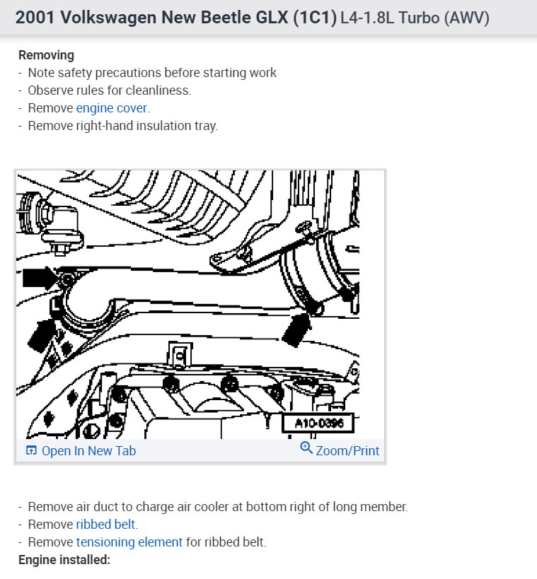

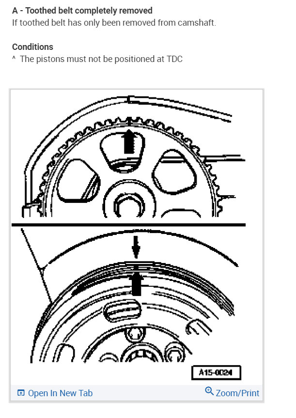

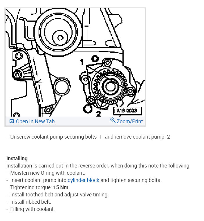

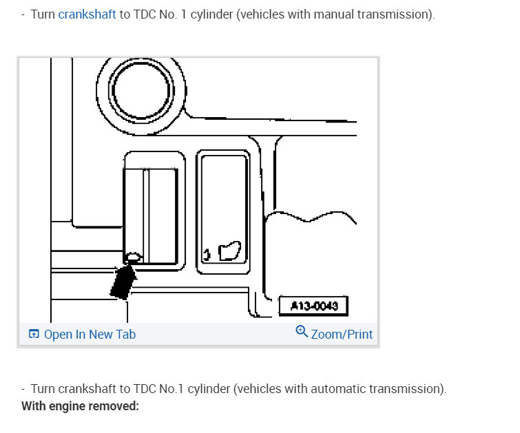

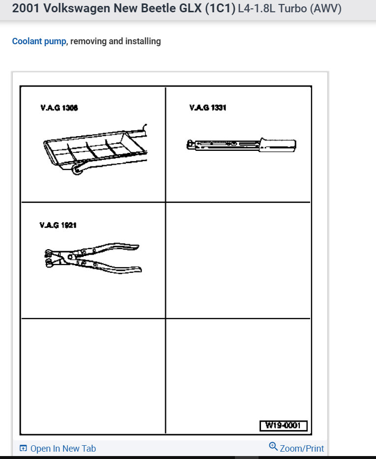

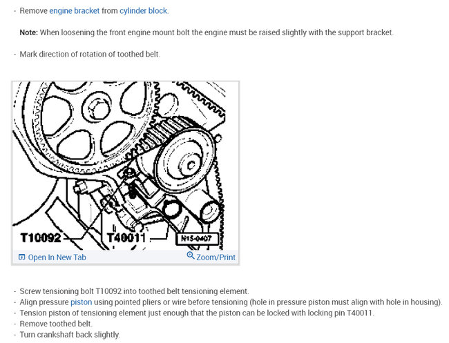

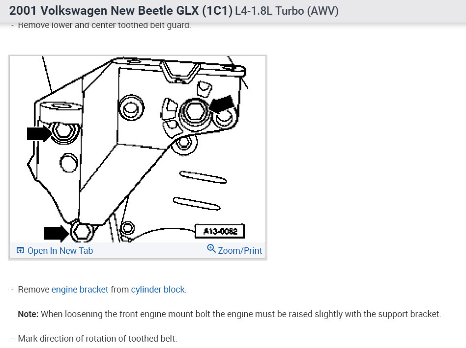

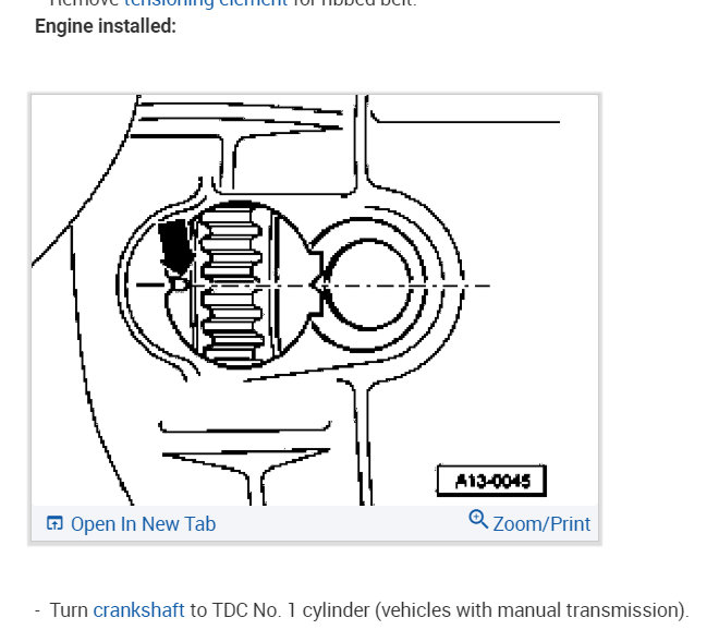

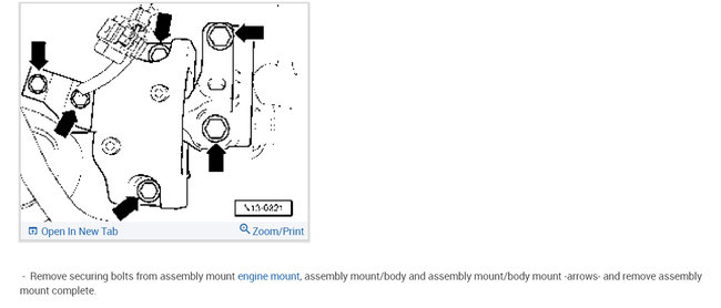

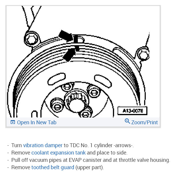

Here is a guide that will help walk him through the steps with diagrams and instructions to do the job on your car below. I would replace the timing belt as well, if it makes a whining sounds when complete the timing belt is too tight.
https://www.2carpros.com/articles/water-pump-replacement
Check out the diagrams (Below). Please let us know what you find. We are interested to see what it is.
