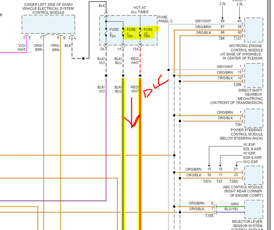

I am sure the radiator fan comes on when needed but neither fans come on when I turn on the A/C. Compressor kicking, and it's cold only while driving. No overheating issue. Where are the fuses? I see a fuse box under the hood on driver side but nothing is labeled.

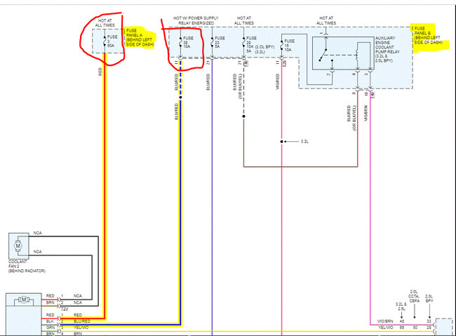

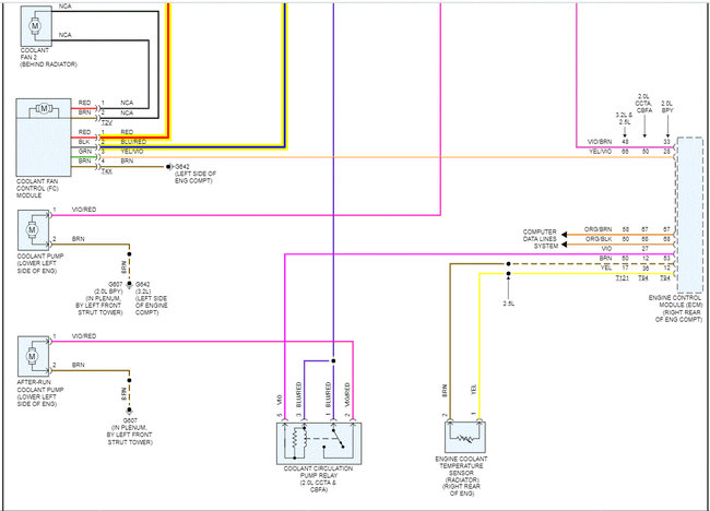

Naser,
I attached two pics below showing the entire cooling fan circuit. There are two fuses that power the cooling fan module. I circled the fuses and highlighted locations.
Take a look through the schematic and let me know if it helps.

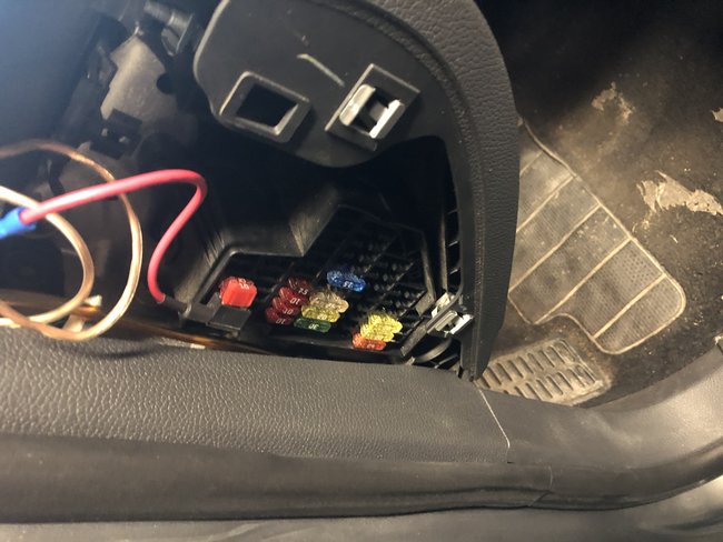

Only two fuse boxes. i see one behind the small panel cover on left side of the steering, but there s no 50A fuse there. all smaller fuses and there is no fuse number 38 in that one. Says panel b but i don't see it.

Found 38 in engine fuse box and its good, numbers 22 and 40 per the book show fan fuses one has a fuse and one doesn't both are 40a .i inserted the other one in the empty slot and both have power. Number 2 behind left side panel is one that someone has wired two fuses to take power from it i think it was for the aftermarket sound system, number 3 next to it is 5a fuse which the book shows nothing.

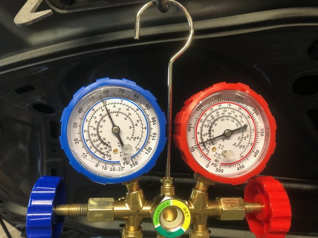

Finally, after checking the wires, checked the connector going to the fans, has both negative and positive.. tried giving the connector a couple of pumps nothing happened, traced the wire going from the connector to the smaller A/C fan, which is behind the shroud, and gave it a couple of slaps and both fans worked. Checked Freon levels and it was decent, can you see if the gauges look okay? driver side is not as cold as passenger but it is good enough, I added Freon and they are both cold bit not sure if it needs anymore. Also, why is it that all my gauges, whenever I disconnect them from the A/C ports they don't go back to zero, reset? How am I supposed to know what the new reading is if it doesn't go to zero and I go check another car?

If you open the valves on the tester once it is disconnected, it should release pressure in the gauge.
As far as the pressure is concerned. Is that static pressure? (AC off engine off)?
Apr 25, 2020 at 4:16 PM

No engine running and A/C on. Also when i turn off the car and come back next time to start it both fans off again. I have to it the connector for it to work. Does that usually indicate an issue with the fans or the connector?

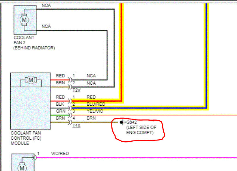

  • 110,248 POSTS
I attached a pic and circled the ground. It doesn't make sense you lose ground with it running and have it when it is off. Make sure that connection is clean and tight.
Apr 26, 2020 at 12:56 PM

No the ground i have is always there at the main fan, but i don't have ground at the smaller one which feeds from the main fan, whether car in or off.
Apr 26, 2020 at 1:12 PM
  • 110,248 POSTS
The control module provides the ground in that case. If you have no ground, suspect the module is the problem or you have a broken ground wire between the module and the second fan motor. Have you checked for that?

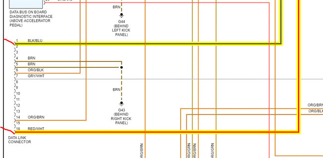

  • 110,248 POSTS
Okay, lets step back and check two fuses. See picture 1. If the fuses are good, check pins 1 and 16 on the DLC for power. See picture 2.
