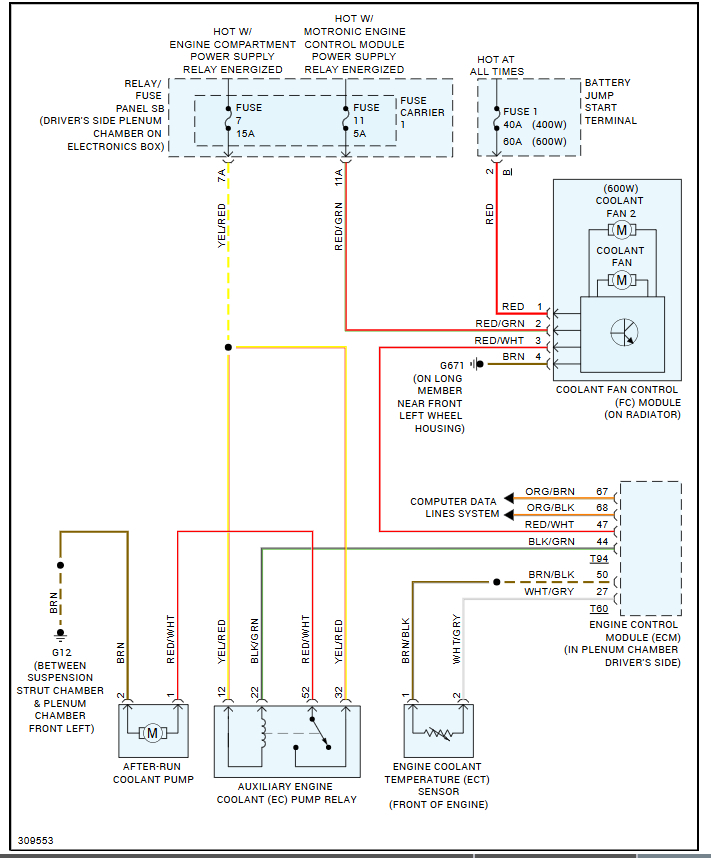

TURNING AC ON FANS DON'T COME ON, ANYWAY YOU CAN FIND FOR ME WHERE THE FUSE IS IN CASE ITS BLOWN, I CANNOT SEE ANY LABELING ON FUSE BOXES ANYWHERE, THIS IS THE 3.2L ONE

Chances are the the fan motors has gone out but yes there are 3 fuses that run the system, please check the image below to see the wiring diagrams and which fuses you need to check. Check out the images (below). Let me know how it goes
