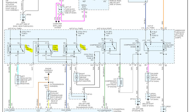

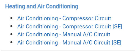

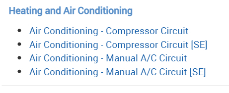

I just went to the wiring schematics, and I need to know if the vehicle is an SE or not. There is a difference in wiring. See pic below.
Let me know so I can further help.
May 9, 2023 at 8:14 PM

It is not an SE.

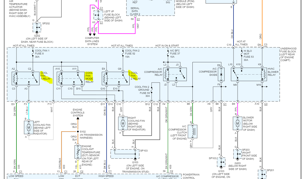

There are a few fuses and relays that need to be checked. When you check the fuses, make sure there is power to and from them.
Here is a link you may find helpful.
Also, we need to confirm the relays are getting power and working properly. Here is a link you may find helpful.

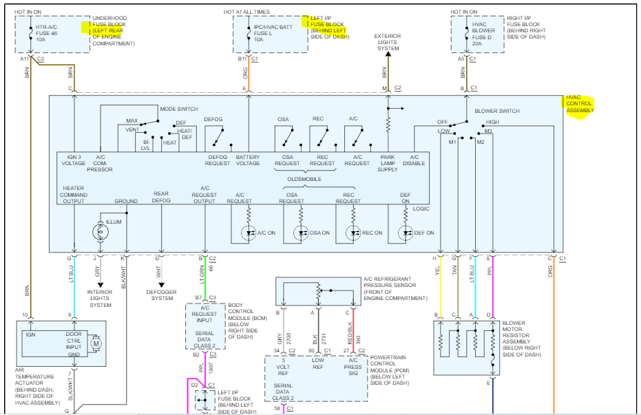

I attached the wiring schematic below which identifies the relays and fuses. Let me know if you find what is needed or if I can help.
See pics below. Note: I had to cut the schematic in two, so it was readable. I did overlap the two so you can follow from one to the next.
May 12, 2023 at 6:37 PM

I jumped the cool fan relays, and they came on so hopefully that's all it is. My multimeter sucks and I need to get a test light so I'm going to replace the relays and see what happens. I've heard these 3.4's just run that hot and fans won't kick on until it goes over 230, but even when I turn the defrost or A/C on the fans still don't work. Mabey after replacing the relays they'll work. I will let you know what they do then I can figure out the A/C problem. Thanks

  • 110,194 POSTS
The fan should come on when you turn the AC on. As far as the temperature is concerned, 230 is a bit higher than I would like to see it. The thermostat fully opens at 195.
Let me know if the relays make a difference and if you checked if the relay locations are functioning properly.

Everything checks out with my cooling fans except when I turn my AC on. No fan, no clutch and just hooked up my gauges and zero pressure. I have a leak. I was going to fill the system with air from compressor and see if the clutch would engage for a split second, then turn it right off but not sure about doing that. I could find the leak too. Kinda stuck at the moment.
