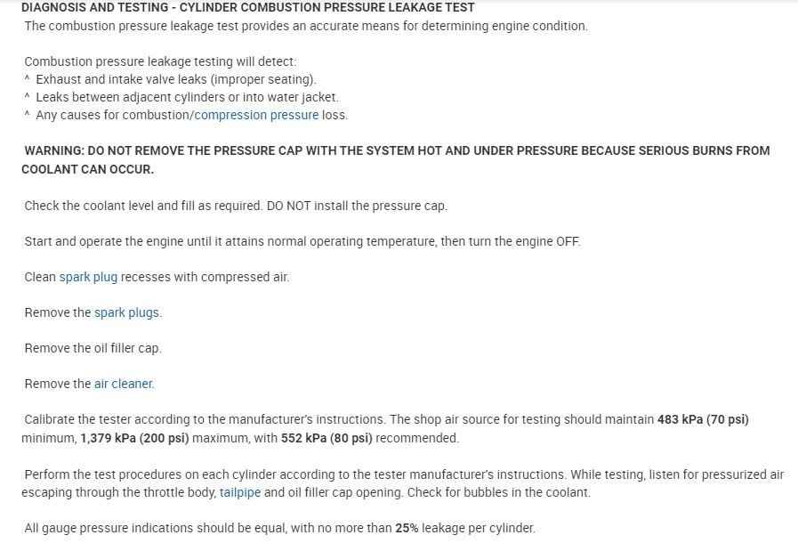

After driving for a while and you shut it off you can hear the water like boiling
188,000 MILES • 2.0L • 4 CYL • 2WD • AUTOMATIC
CHUCKRD

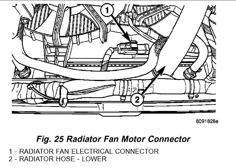

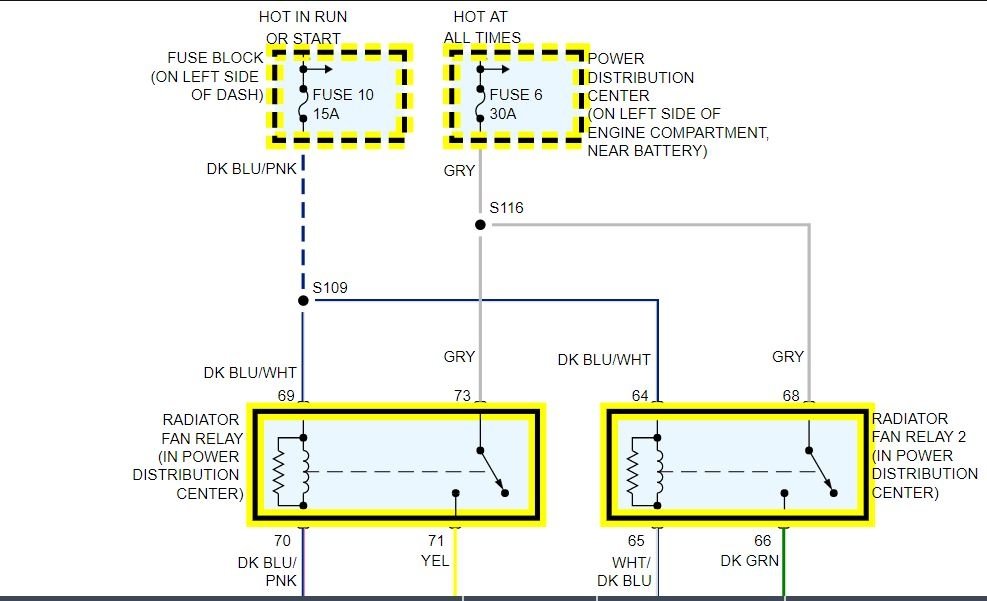

But it can sit in my yard running for hours and not run hot. changed thermostat and can't see any leaks. No water in the oil. After driving for a while and you shut it off you can hear the water like boiling in the overflow reservoir (at least that's where it sounds like it is). One of the fans runs all the time but one comes on and goes off.
Feb 19, 2020 at 6:25 AM
Good evening,
This could be either a clogged radiator or a leaking head gasket. You will not see water in the oil until there is a large amount in the oil.
https://www.2carpros.com/articles/how-an-electric-cooling-fan-works
I would have a leak down test done on the cylinders to see if there is a head gasket failure.
