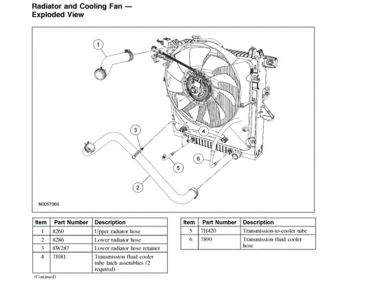

Replacement of radiator and fan. I just need to take the fan off.
Oct 12, 2018 at 5:22 AM

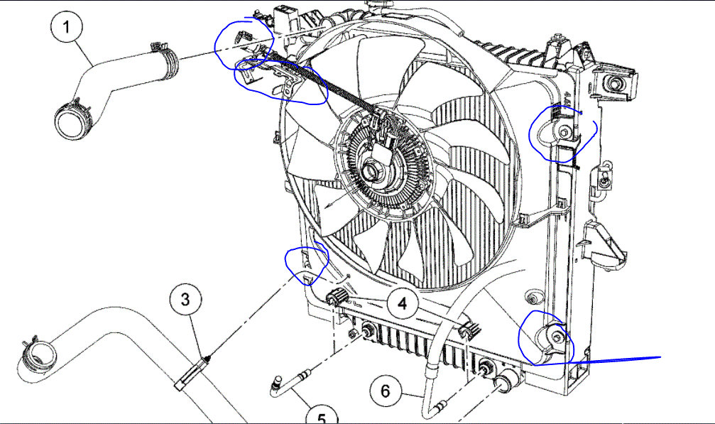

I attached pictures for you of the cooling fan. There are 4 mounting bolts and an electrical connector.
https://www.2carpros.com/articles/replace-electric-fan-motor
