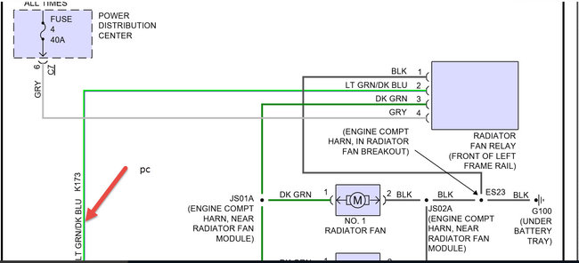

I need the wiring diagram for my fan relay. I replaced the relay switch and the pig tail for it too, but I am not sure if the wires are correct. The fans stopped working a long time ago.
Please help

see picture wire going to pcm is marked I cannot get it all in picture.

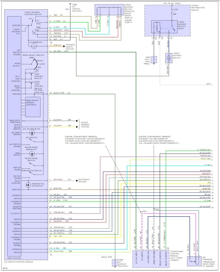

I i's not giving me the full correct information.

1 is ground the dark green goes to motor and gray is power the light green goes to pcm.

Hi Tim,
Here is the information you need, sorry for the delay
Let me know if you need anything else.
