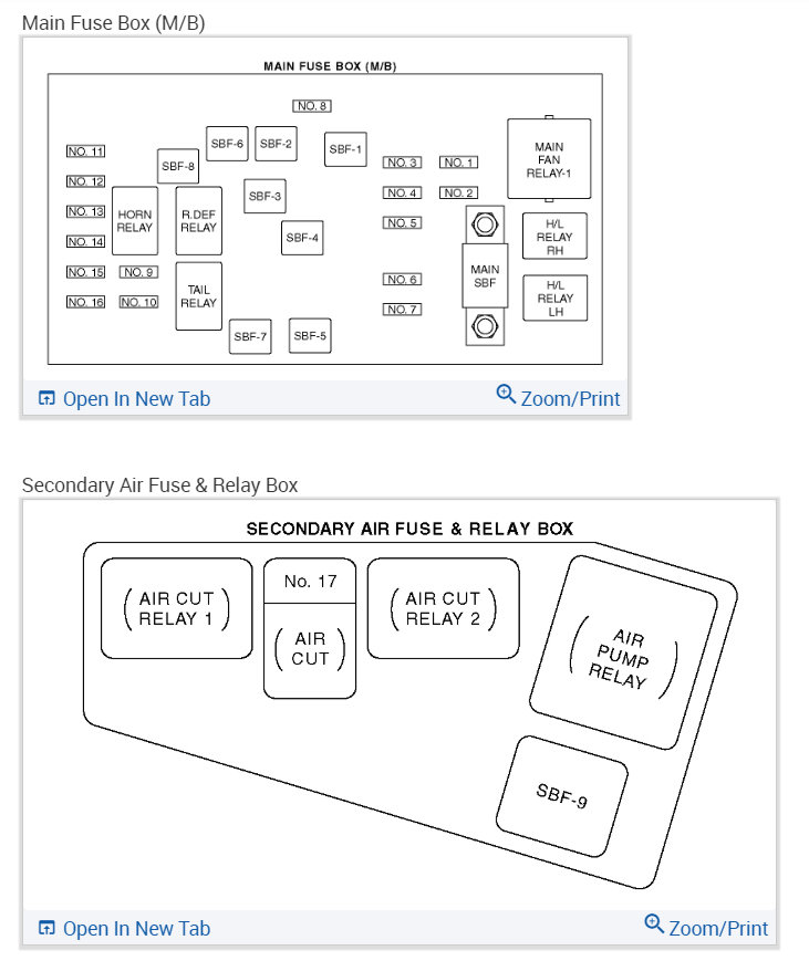

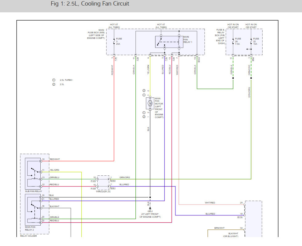

P0483 code came up on my car. My mechanic hasn't seen this code before. My car isn't overheating or anything the only issue is my heater isn't working, the fan won't blow any air. Is there any idea what this might mean I have to fix?
Oct 18, 2019 at 11:05 PM
  • 55,711 POSTS

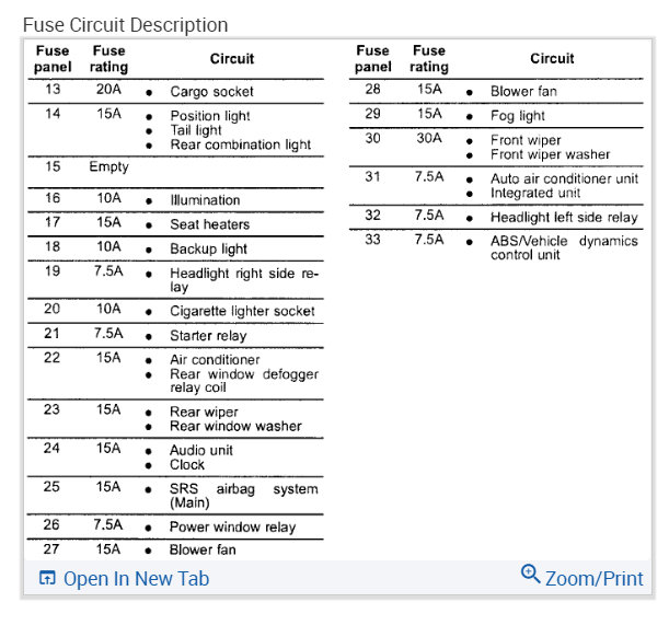

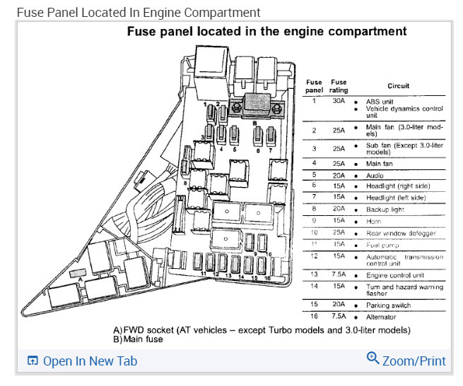

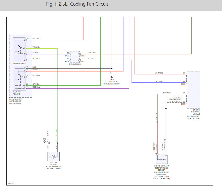

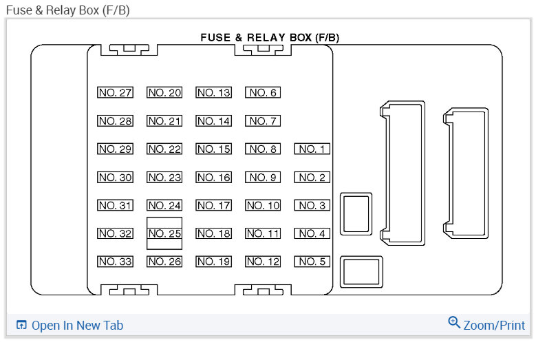

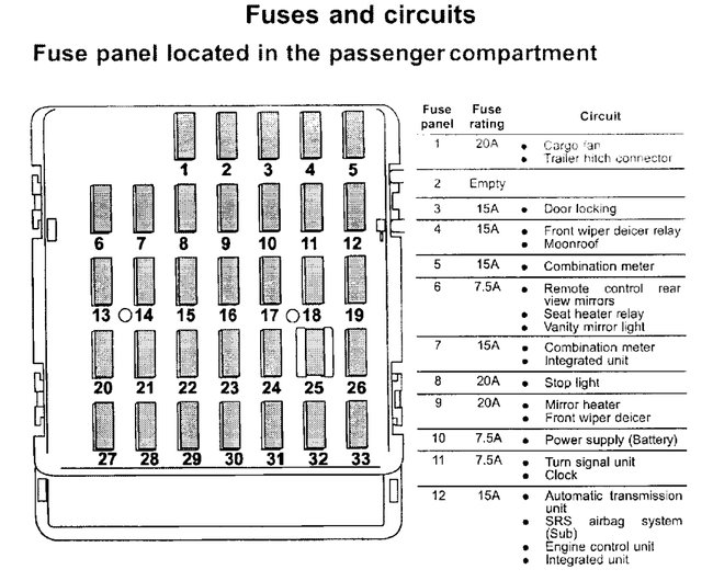

The code P0483 Cooling Fan Rationality Check Malfunction is the definition. There are three fuses and two relays that needs to be checked. here is the cooling fan wiring diagrams so you can see how the stem works and which fuses to check. These guides will help. Also does the cooling fan come on when you turn the AC on?
and
Here are the fuse panel and relay locations. Check out the diagrams (below). Please let us know what you find. We are interested to see what it is.
