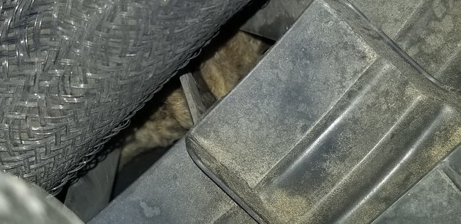

A couple of months ago I took it to the shop because my radiator went bad and had them replace it. After they replaced it and I took it home I notice to that whenever I would turn the heat on it would randomly make a very loud noise like the fan was messed up. They told me it was a relay so I replaced it. The very loud noise coming from the fan continued after I replaced it. Now today I turned my air conditioning on and notice to that same very loud noise continued and is louder with the air conditioning on. When I turn the heat on the noise is not as loud and it stops after a small period of time. Did the shop mess something up or is there something else wrong. I've already talked to the shop and they just keep saying it is the relays.

This sounds like the cooling fan motor for the radiator.
Open the hood and look at the fan by the radiator and see if there is anything stuck in the blades.

Okay, lol. so I looked and I looked and I looked and I finally saw then the fan. I think it's a rat, lmao. I was not expecting that. I can only see of the butt I think.

Do I pull it out or do I have to take something apart to get it out?

Oh, man. Yes, that looks like it.
Mar 19, 2019 at 11:02 AM
Probably saw it but did not want to deal with it.
You should remove it.
