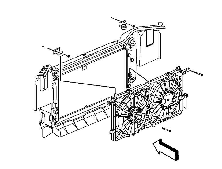

This sounds like the cooling fan motor for the radiator.
Open the hood and look at the fan by the radiator and see if there is anything stuck in the blades.

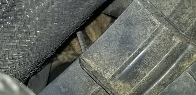

Okay, lol. So I looked and I looked and I looked and I finally saw then the fan. I think it's a rat, lmao. I was not expecting that. I can only see of the butt I think.

Oh, man. Yes, that looks like it.
Tuesday, March 19th, 2019 AT 6:02 PM
  • 52,797 POSTS
Probably saw it but did not want to deal with it.
You should remove it.
