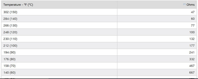

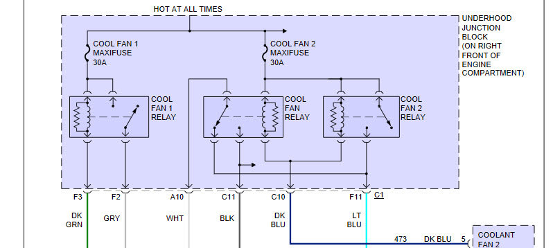

Fan problems temperature switch is not working
2001 CHEVROLET VENTURE
51,000 MILES • 6 CYL • MANUAL
ABDUR RAHMAN 123
I did the fan direct but the switch is there and it is not going off. so I want to remove the light the low fan for engine.
Jan 2, 2017 at 12:04 AM
ABDUR RAHMAN 123
Temperature switch is not working so what should I do?
Dec 18, 2018 at 10:32 AM
ABDUR RAHMAN 123
It is an automatic.
HMAC300
  • 48,601 POSTS

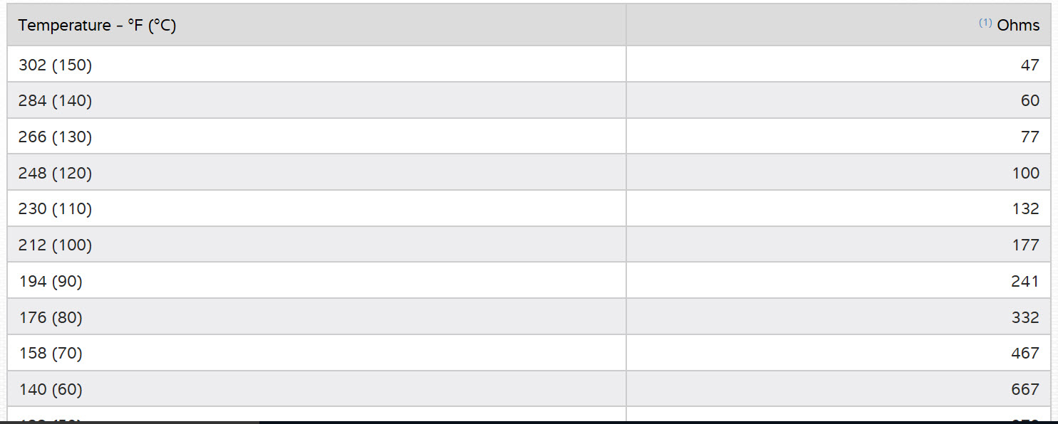

check fuses and relays in picture. then check resistance of engine cooling switch. See pictures. resistance is an example of what it should read, higher when cold.
