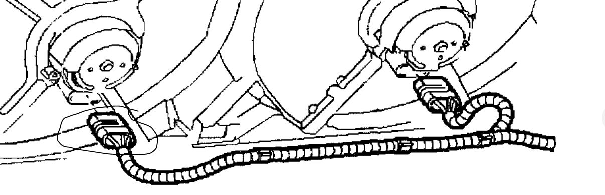

I have 2 individual fans blowing on the radiator and I can't for the life of me figure out how to pull the plug out of the bottom of either one electrical plug and I don't want you rip it out. The wiring is not long enough for me to pull it up to see!! The job was going great up until now.. . I'm trying to replace my radiator and I've never done it before.

I attached a picture for you to view. On the bottom of the connector is a tab that must be depressed to release the connector. The problem is you cannot see it. You have to feel it. You could use a mirror to view the tab before trying.

Thank you very much, but I don't get it. is the picture telling me I just have to pull the one plug because there in line? And still how do I pull it out when it's stuck tight and there's no room?
Aug 8, 2019 at 2:51 AM
No, it shows you how it goes. The lock is under the connector but is not shown in the picture.
Unfortunately, you need small hands to get to the connectors.
