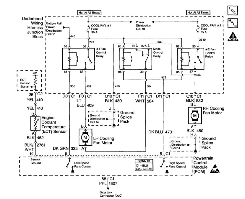

My radiator fans will not come on after the car reach operating temperature. I changed the ect plug. Plus put in a new thermostat now the car will keep operating temperature at 200 degrees but my fans still will not come on.

The cooling fan usually will not kick on until you reach about 210-240 degrees depending on the signal specs for low speed operation and high speed operation. That is why it is recommended when bleeding the cooling system to usually raise the rpm's to 2500 with heater on until the fans come on. If the fans do not come on then you will see the vehicle start to overheat. You just maybe trying to chase a problem that is not present? So try that first to see if the fans come on or if it overheats.

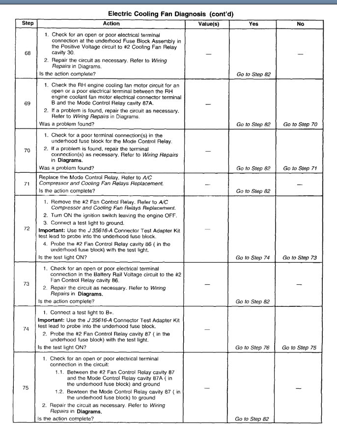

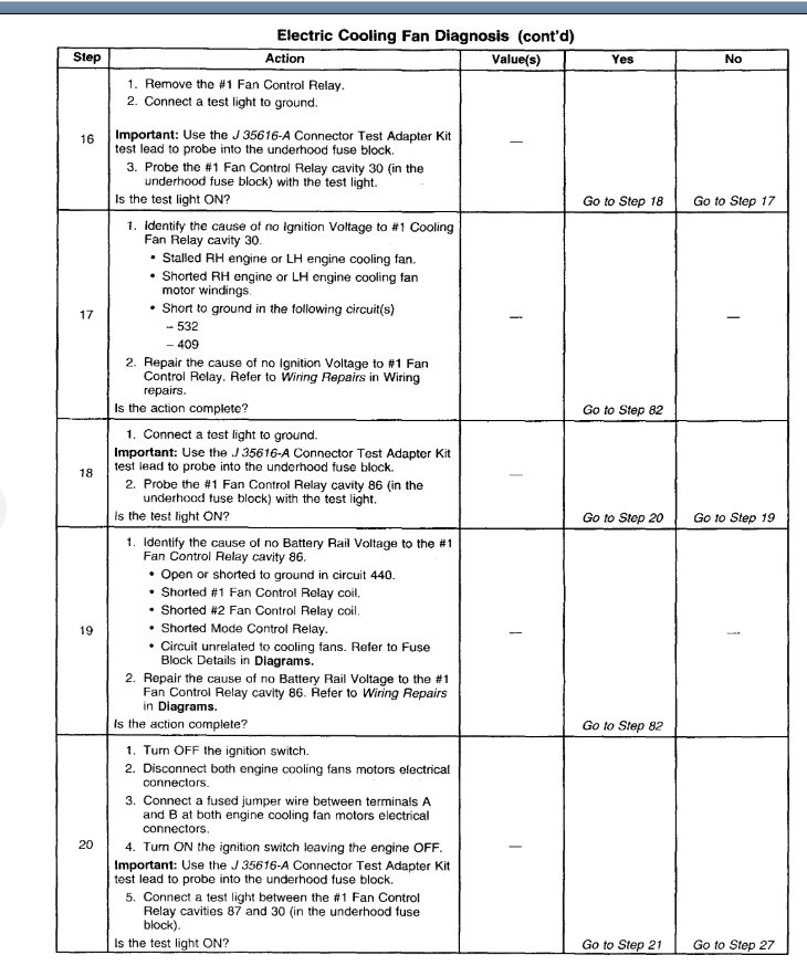

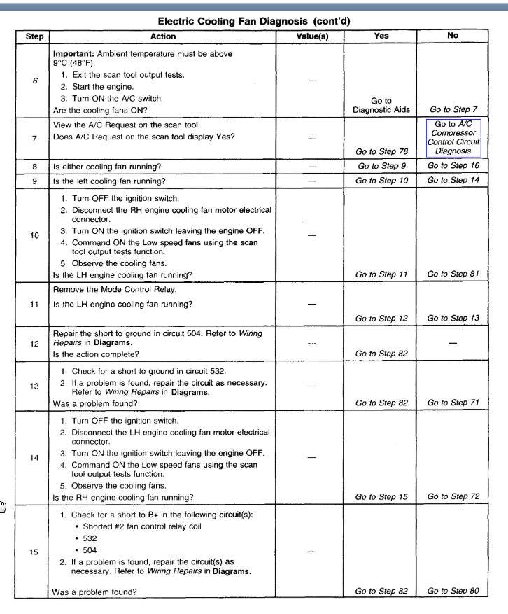

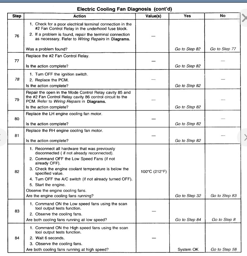

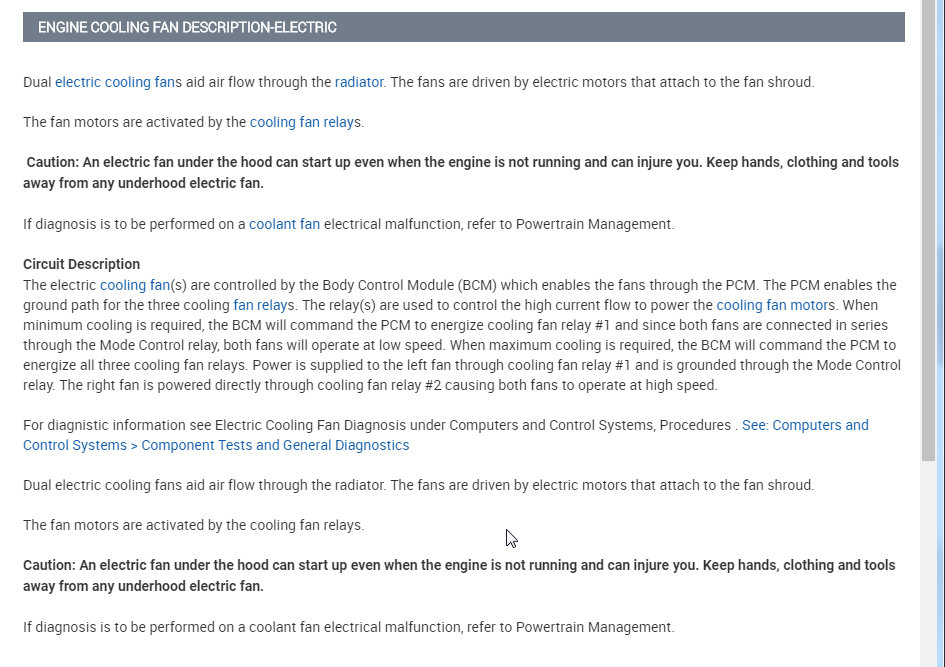

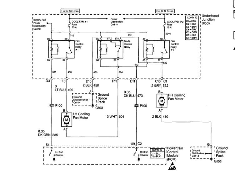

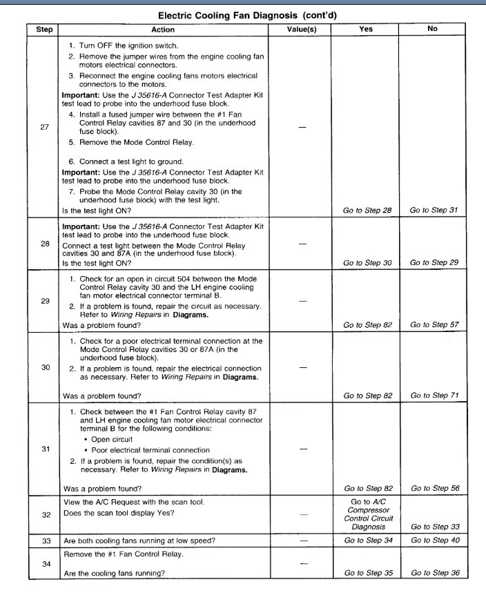

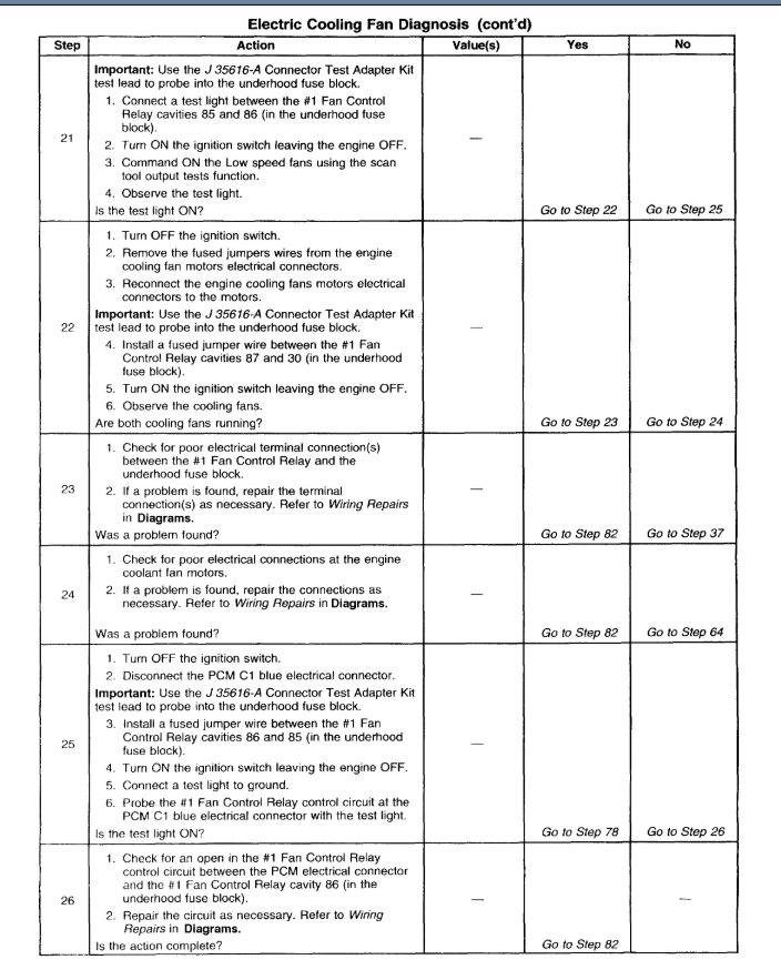

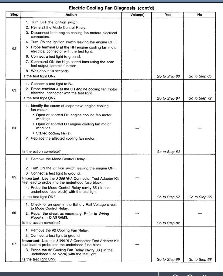

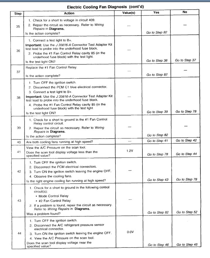

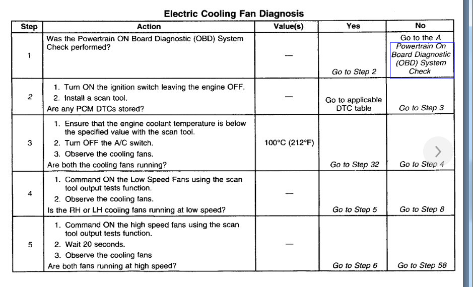

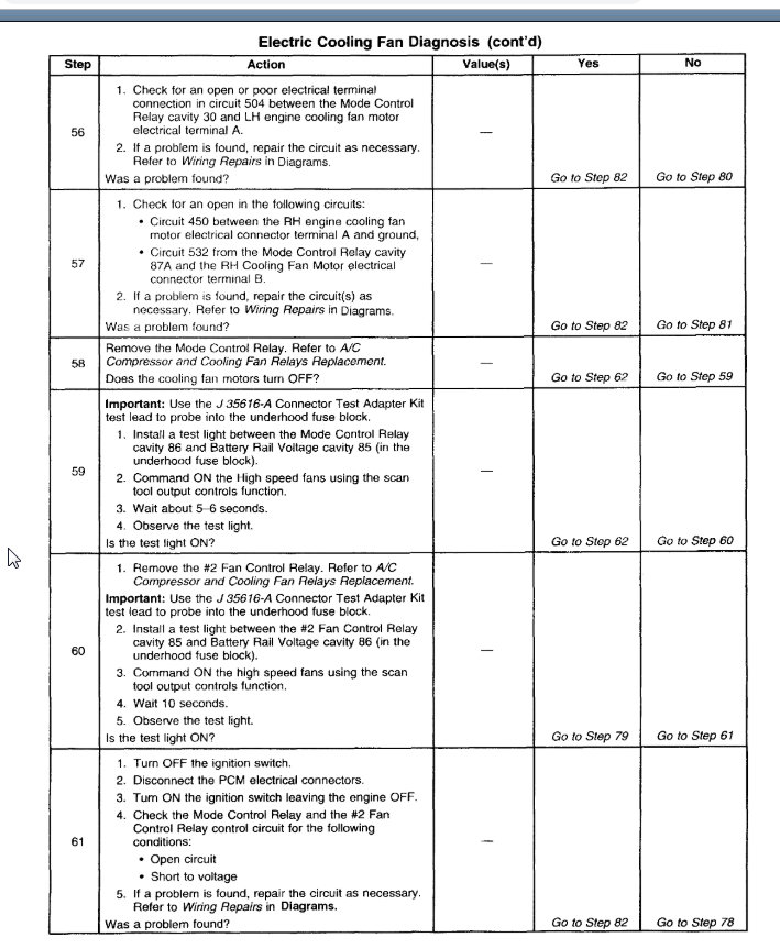

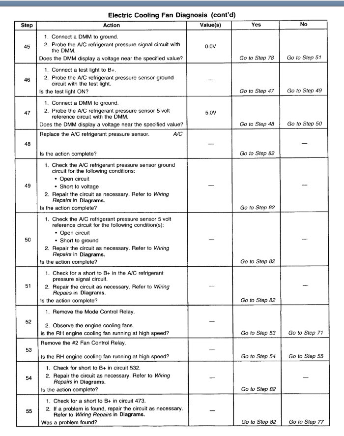

Okay. We need to start with what the BCM is seeing as the coolant temp. The way this works is the BCM monitors the temp and when it gets high it tells the PCM to ground the relays and turn the fans on. This means we need to see if the BCM is seeing the proper temp. If it is then we need to look at the PCM to see if it is getting the command to turn them on. If it is getting the command then we can assume that the PCM is the issue.
However, I attached the testing for the fans. It is lengthy but it will lead us to the issue as well.
Let me know if you have questions or what you find. Thanks

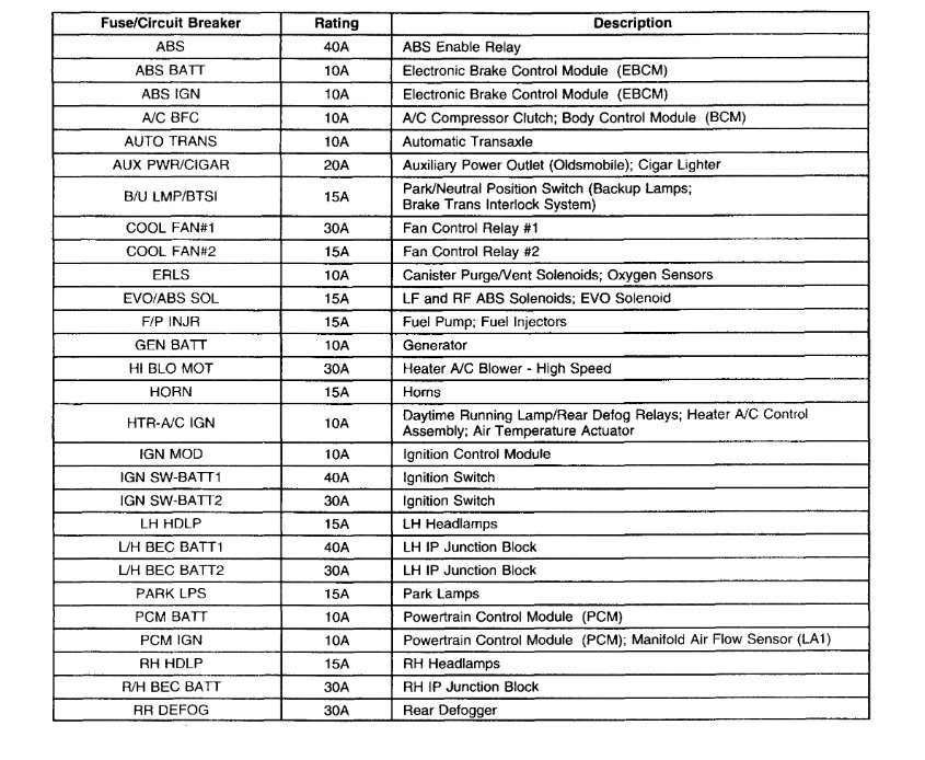

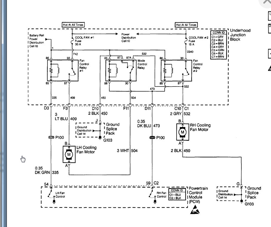

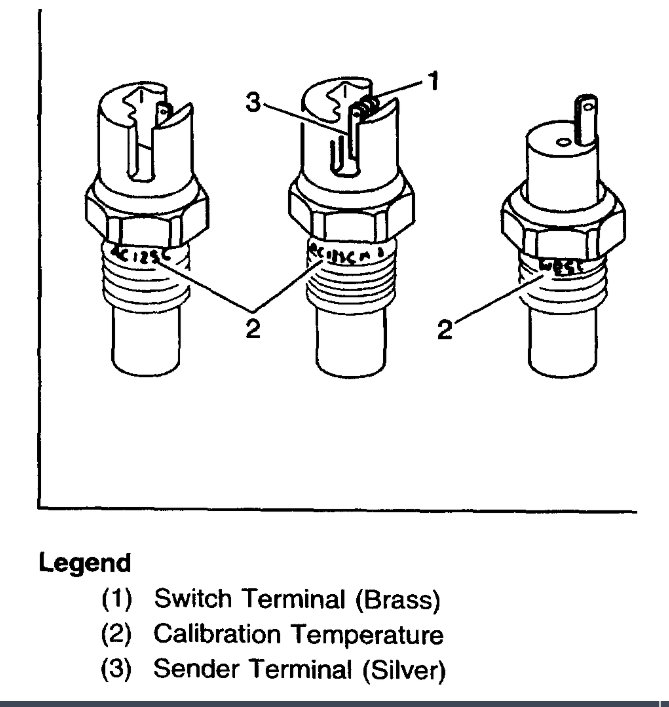

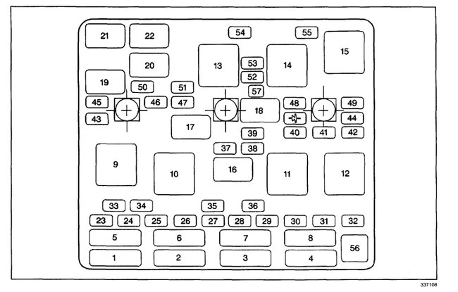

There are two coolant temperature sensors on the engine one on top and one on left side in the cylinder head for the cooling fan it has one wire and it grounds the relay when car overheats. You can ground it for a test be sure to check the fuses and relays first. I am attaching wiring diagrams fuse and relay location below for you to refer to. Let us know if this information was helpful and if you need more information.
Thank you
Joe T.
Dec 9, 2020 at 7:10 AM (Merged)

Okay, so it will not activate the fan for the A/C until the system is charged.
I sent you a diagram for the circuit.
Check the two listed fuses for power on both sides with a test light or voltmeter.

You have to realize that these fans are not supposed to turn on at that temperature. They are not programmed to turn on until approximately 223 degrees and that is low speed as they are two speed fans. High speed does not kick until 232 degrees. It is possible to have low speed circuit only burned out but you will not know at that temperature. that would be a fuse, wiring or relay problem.
