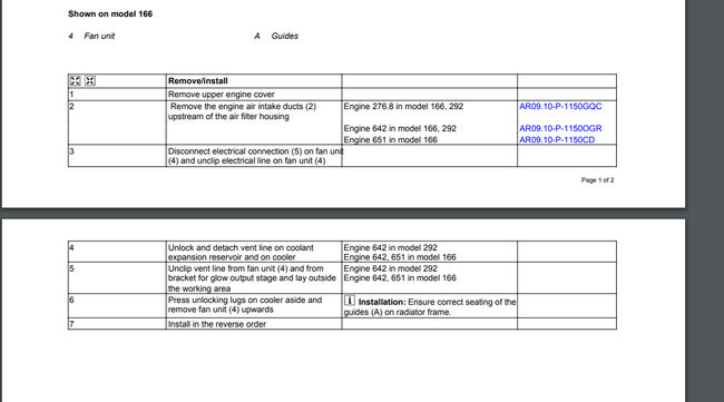

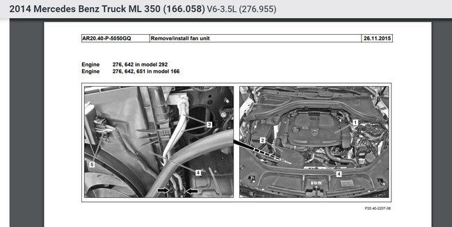

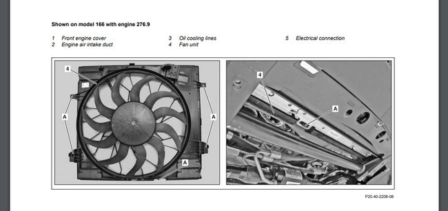

My coolant fan does not work. I have got code p048013: the output of electric fan 1 has an electrical fault or an open circuit. There is an open circuit.
May 14, 2023 at 8:46 AM
  • 55,728 POSTS
It sounds like the fan motor has gone out which is where I would start by removing the fan to test it by putting power and ground to the motor. I have included how to remove the fan for replacement in the images below.
Error Code: P0480 - Cooling Fan 1 Control Circuit Malfunction
