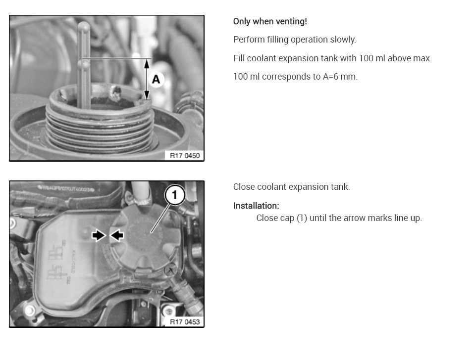

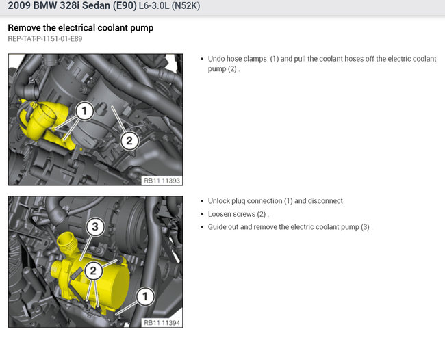

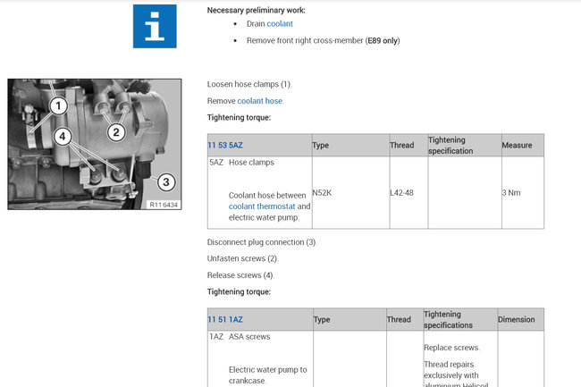

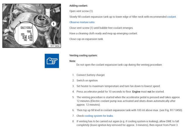

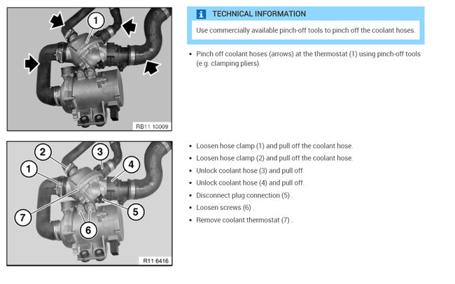

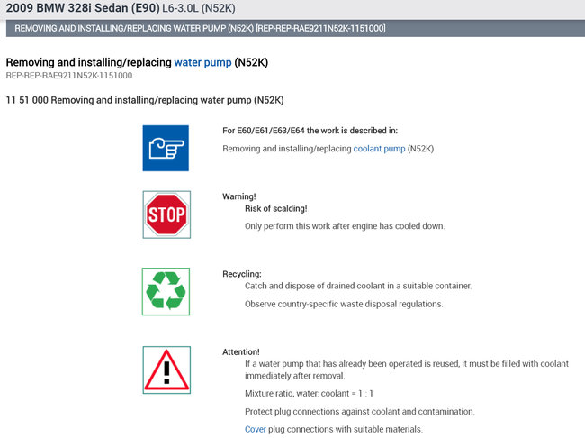

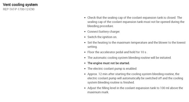

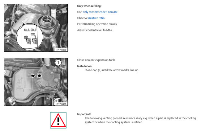

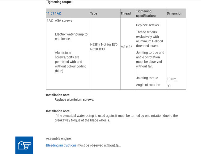

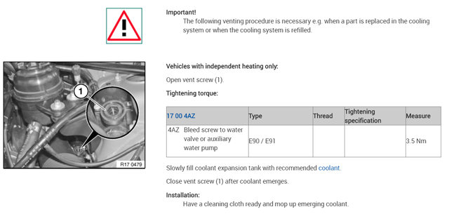

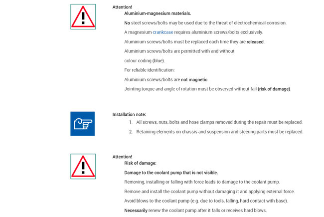

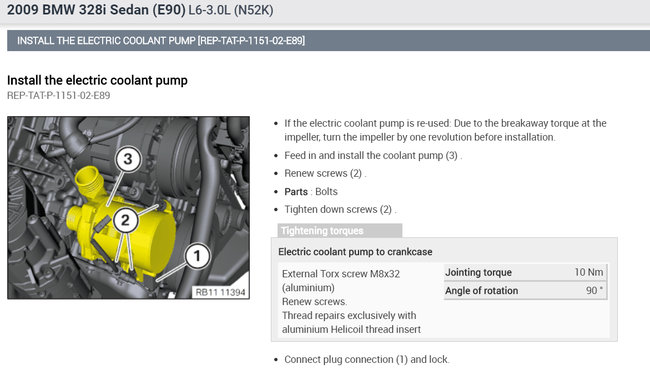

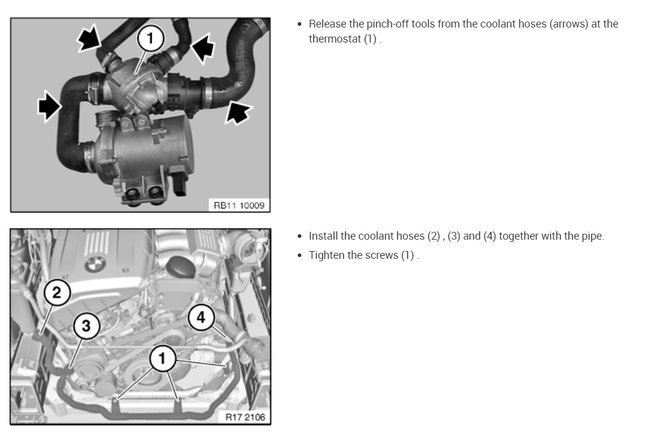

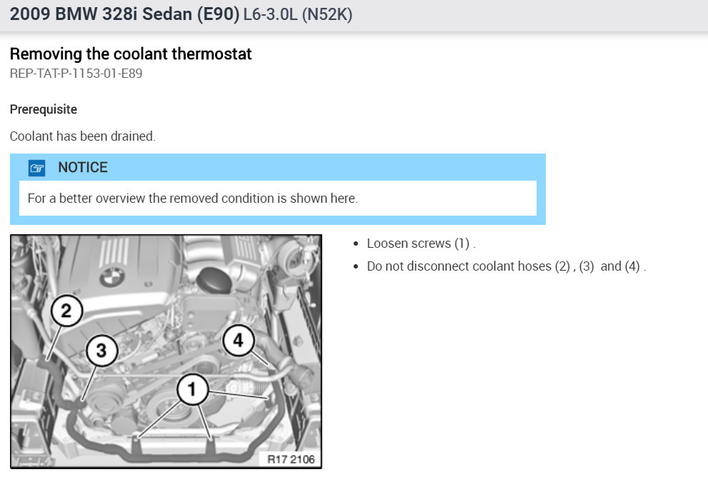

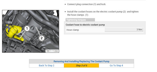

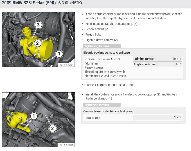

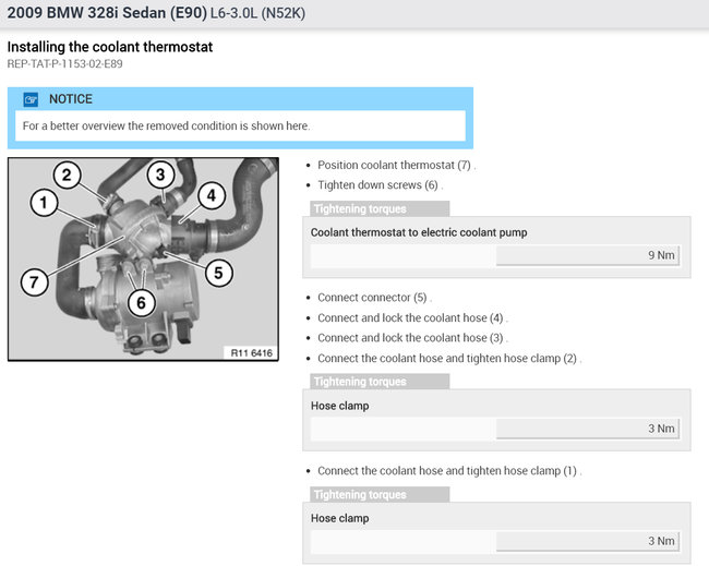

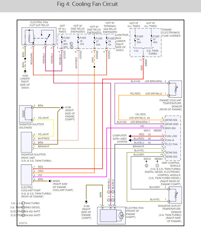

This water pump is powered by the #37 under the dash on the passenger's side fuse panel. Here is the water pump wiring diagrams so you can see how it works plus the instructions for replacing the pump to confirm the installation is correct in the diagrams below.

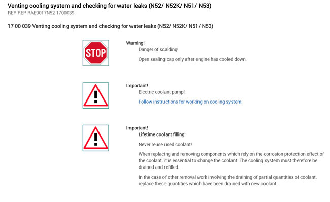

They speak of the thermostat and to vent the system without fail. Here is a guide to help check the electrical:

Thanks, checked all fuses a d they are good, pump not coming on at all when primed by scanner, the connector has 4 wires as the diagram shows, 2 show battery voltage and one (purple)shows nothing but the tester still gives a light. do you know what kr when its supposed to have power? 4 The is nothing which am guessing ground.

Brown is ground orange is power. it sounds like the pump is bad. was it an OEM part? Do you have power at fuse # 37?

yes the fuse has power. Am asking about the VIO wire, the first two have battery voltage, the fourth have ground, the third just shows a dim light and not showing voltage reading. I replaced the pump with aftermarket 3 months ago.

The VIO wire is the trigger it should turn the pump on. I would unplug the pump to see if the reading change, if so replace the pump. I would use OEM.

The test light I have has light and readings. with the first 2 wires I get a light and readings of voltage. the VIO only gives dim light but no reading, not even showing 0. that is with the ignition on and the connector unplugged.

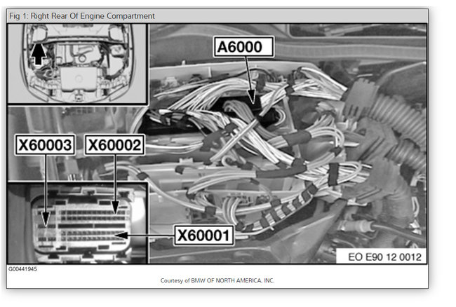

That does sounds right I would try the DME control module. Here is the location is the diagrams below. Check out the diagrams (below). Please let us know what you find.

Replacing it, if the water pump is good then its the only thing that could be wrong. a bad DME.

Am going to try that while she still on, which of the 4 pins would i supply positive to? The ground i know is number 4.

I would try to ground the violet wire to see if the pump comes on.
