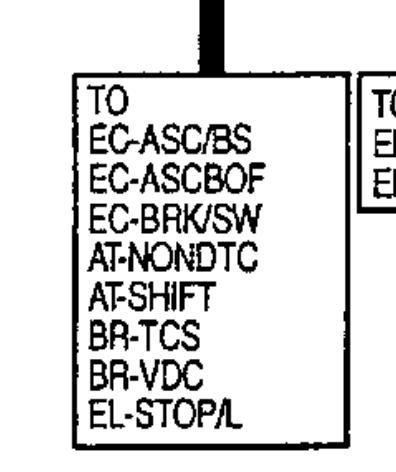

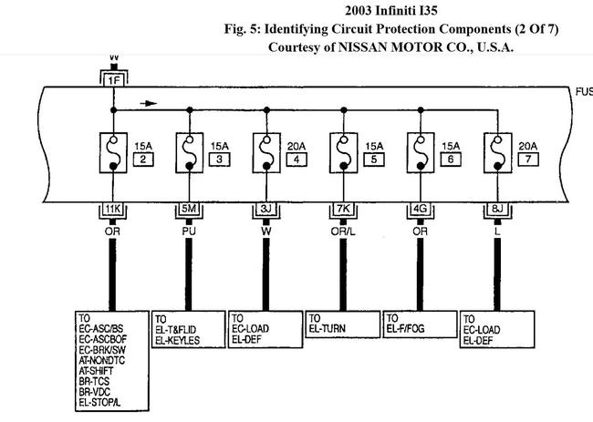

I have the same problem. I have discovered that if I pull the engine control fuse 2 15-A the noise stops. If I try to turn on the car without the fuse in the engine wont start. Could this be a valve or an issue with the fuel pump? Please help!
Aug 27, 2013 at 11:35 PM
KHLOW2008
  • 41,814 POSTS
Diagram shows what are the components linked to this fuse. I don;t see any problem why you can't start as the list does not indicate any reference to engine control.
Aug 27, 2013 at 11:58 PM
MEAGHANOLEARY
What could the noise be then? Because it seems to be an electrical problem. will it kill the battery? I am not sure if I should keep the fuse in and let it continue whatever it's doing when the car is off.
Aug 28, 2013 at 12:30 AM
KHLOW2008
  • 41,814 POSTS
You need to locate the source of the noise and find out which component is causing it.
It could be a motor, relay or solenoid.
If possible, get a scan done to check for trouble codes. Take note that scan tool must have all control system diagnostic capabilities, normal code readers would not work.
Keeping the fuse in and if it is a motor running, it would definitely drain the battery.
