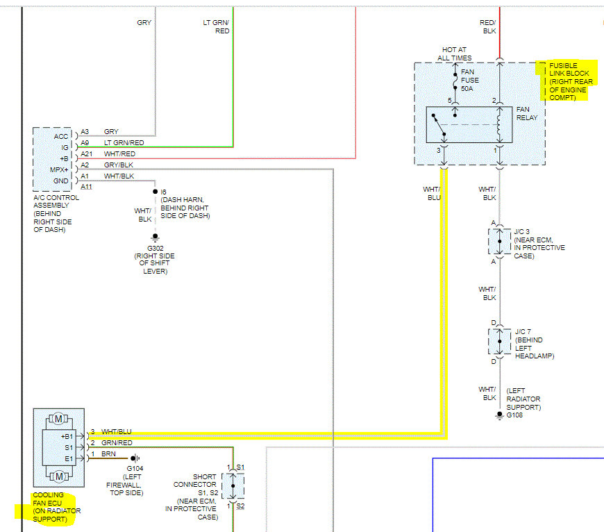

Two days ago our vehicle began to run real hot when at a stop light. It cooled right down when we were moving, and we were careful to make sure the engine didn't freeze.
I just checked the fans with the A/C on and the engine running, and the passenger side fan is on but the driver's side fan wasn't running.
I believe this model might have fan relays, so my questions are:
A. Can you list the diagnostic steps to make sure we identify the problem before ordering parts?

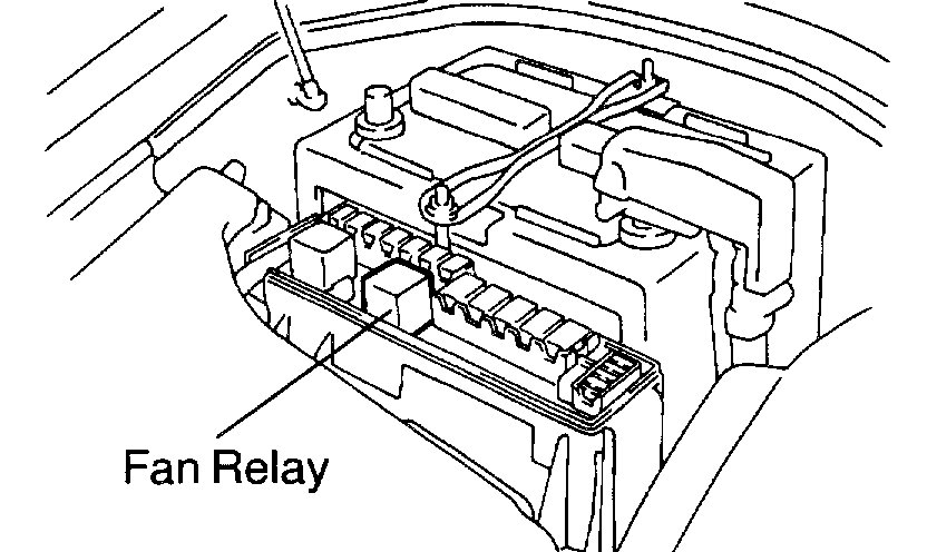

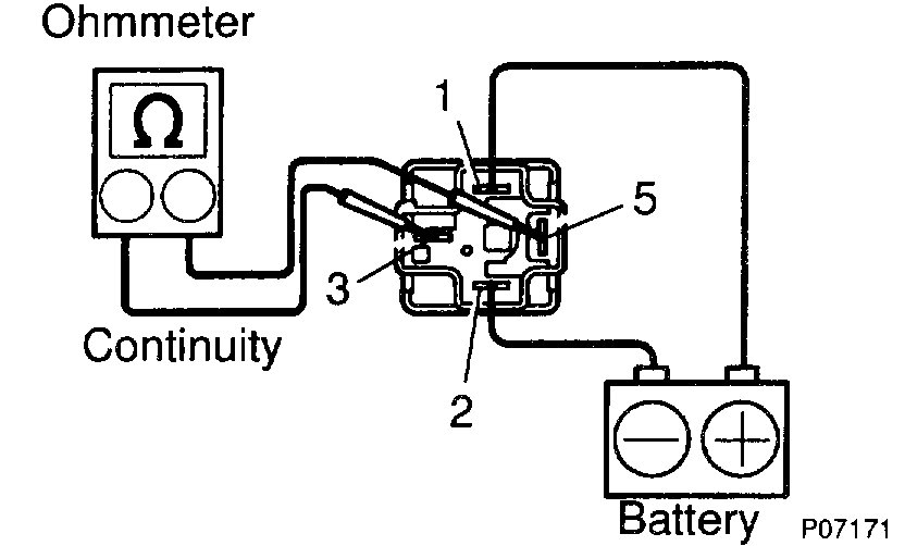

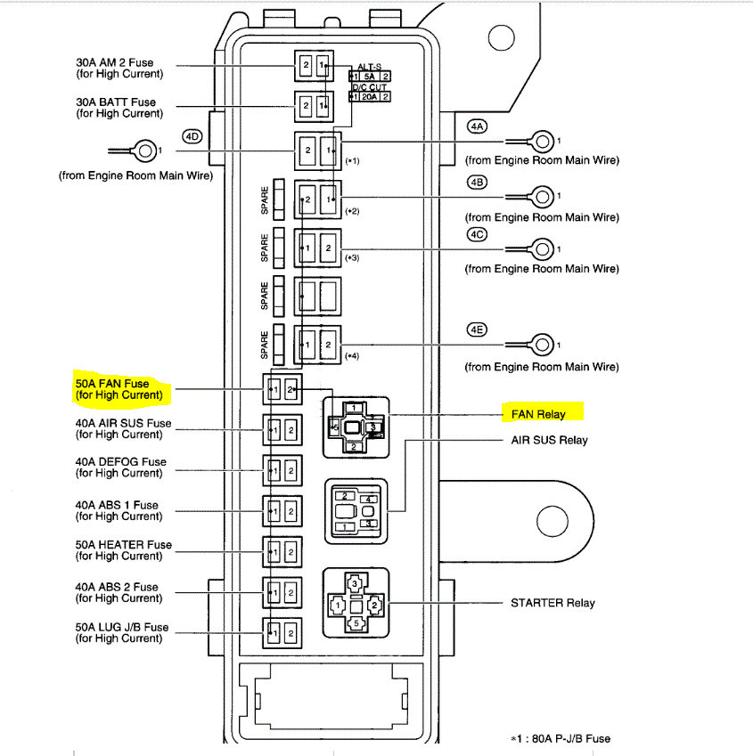

Here are the steps for checking the fan motor relay. The attached pics correlate with the directions.
_________________________________
2001 Lexus LS 430 V8-4.3L (3UZ-FE)
Component Tests and General Diagnostics
Vehicle Engine, Cooling and Exhaust Cooling System Radiator Cooling Fan Radiator Cooling Fan Motor Relay Testing and Inspection Component Tests and General Diagnostics
COMPONENT TESTS AND GENERAL DIAGNOSTICS
INSPECTION
pic 1
1. REMOVE FUSIBLE LINK BLOCK COVER
2. REMOVE FAN MAIN RELAY
pic 2

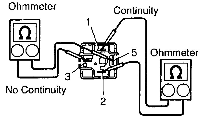

3. INSPECT FAN MAIN RELAY CONTINUITY
a. Using an ohmmeter, check that there is continuity between terminals 1 and 2.
If there is no continuity, replace the relay.
b. Check that there is continuity between terminals 3 and 5.
pic 3

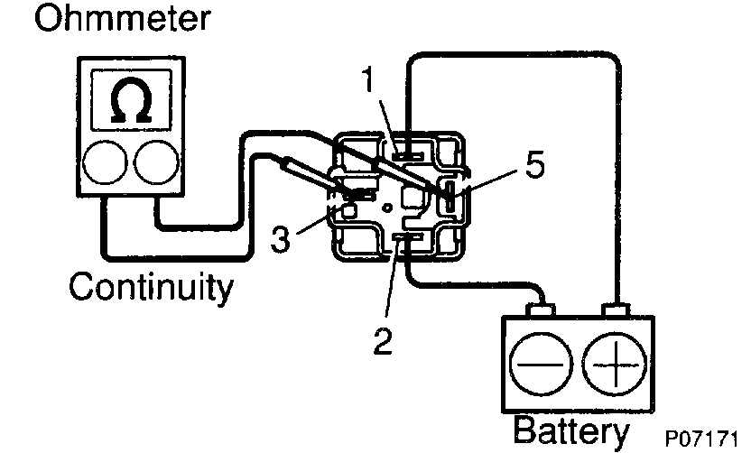

4. INSPECT FAN MAIN RELAY OPERATION
a. Apply battery positive voltage across terminals 1 and 2.
b. Using an ohmmeter, check that there is no continuity between terminals 3 and 5.
5. REINSTALL EFI MAIN RELAY
6. REINSTALL FAN MAIN RELAY
7. REINSTALL FUSIBLE LINK BLOCK COVER
__________________________________

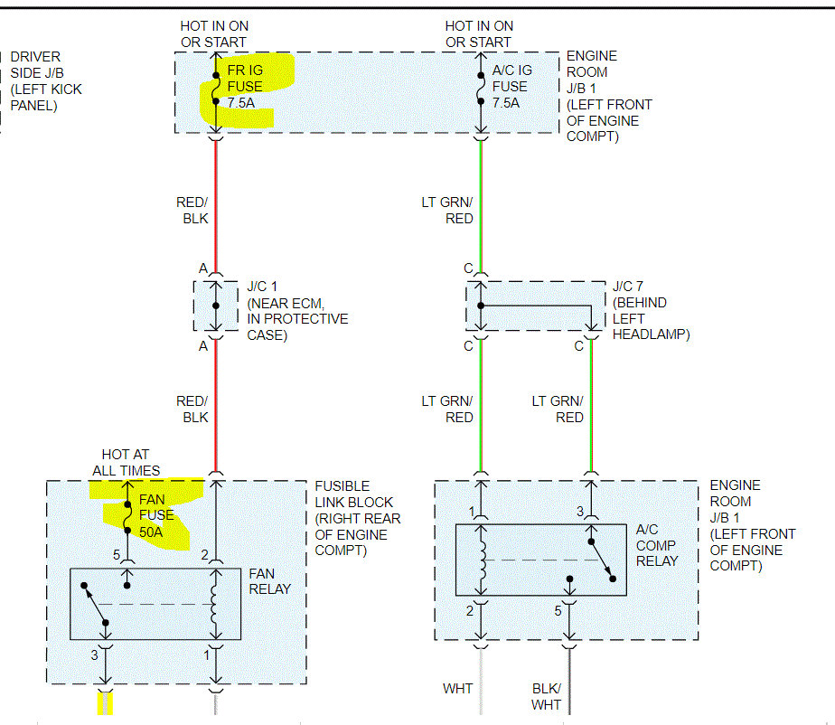

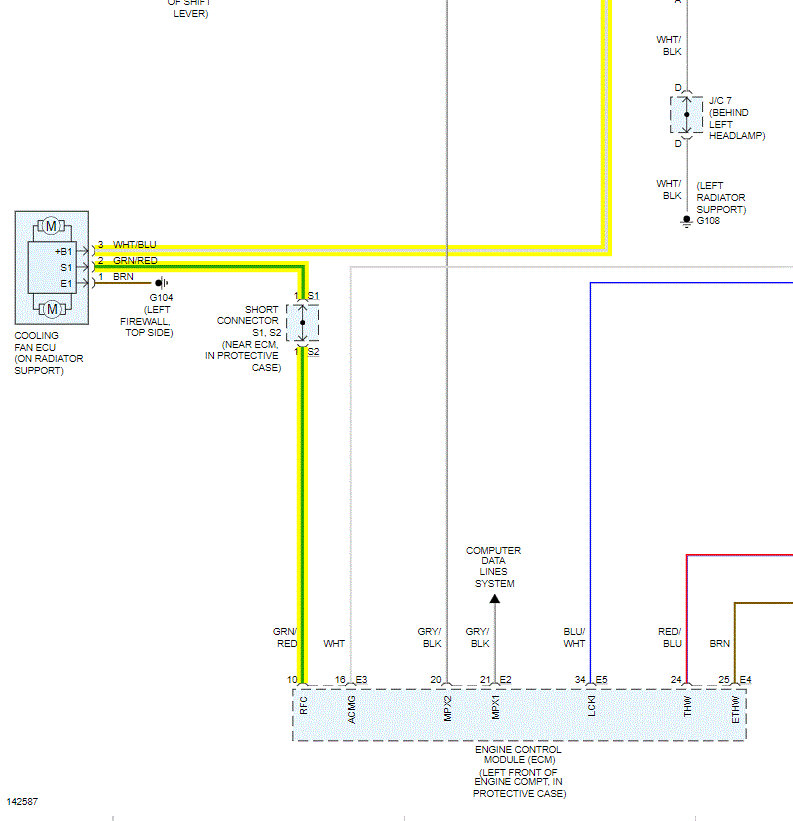

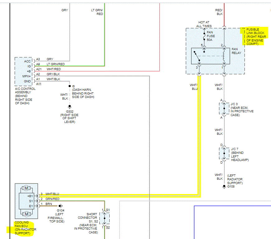

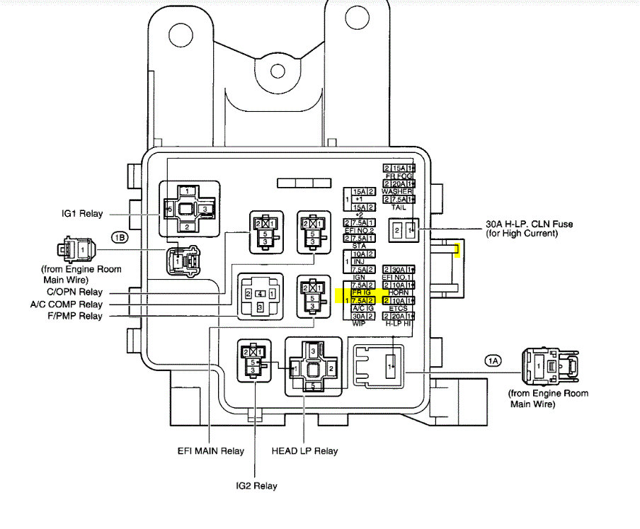

If the relay checks good, confirm there is power to and from the fuses. See the attached pics for fuse and relay location. Both are under the hood. The relay is in the fusible link box and the fuse (7.5 amp) is in the number 1 junction box (left side of engine compartment).
Here are a couple links you may find helpful:
Note if there is power making it to the fan motor, suspect the motor is bad.
Let me know if this helps and what you find.

So, we determined that the driver's side cooling fan motor is not functioning. Did it by using an external battery to test at the fan's connector, and validated by proving the passenger's side cooling fan worked (fan #2). Hard to believe the part is so expensive ($250.00 is the cheapest I could find, needs to be Lexus part only, bummer). Can you send me the remove and replace directions, with pictures?

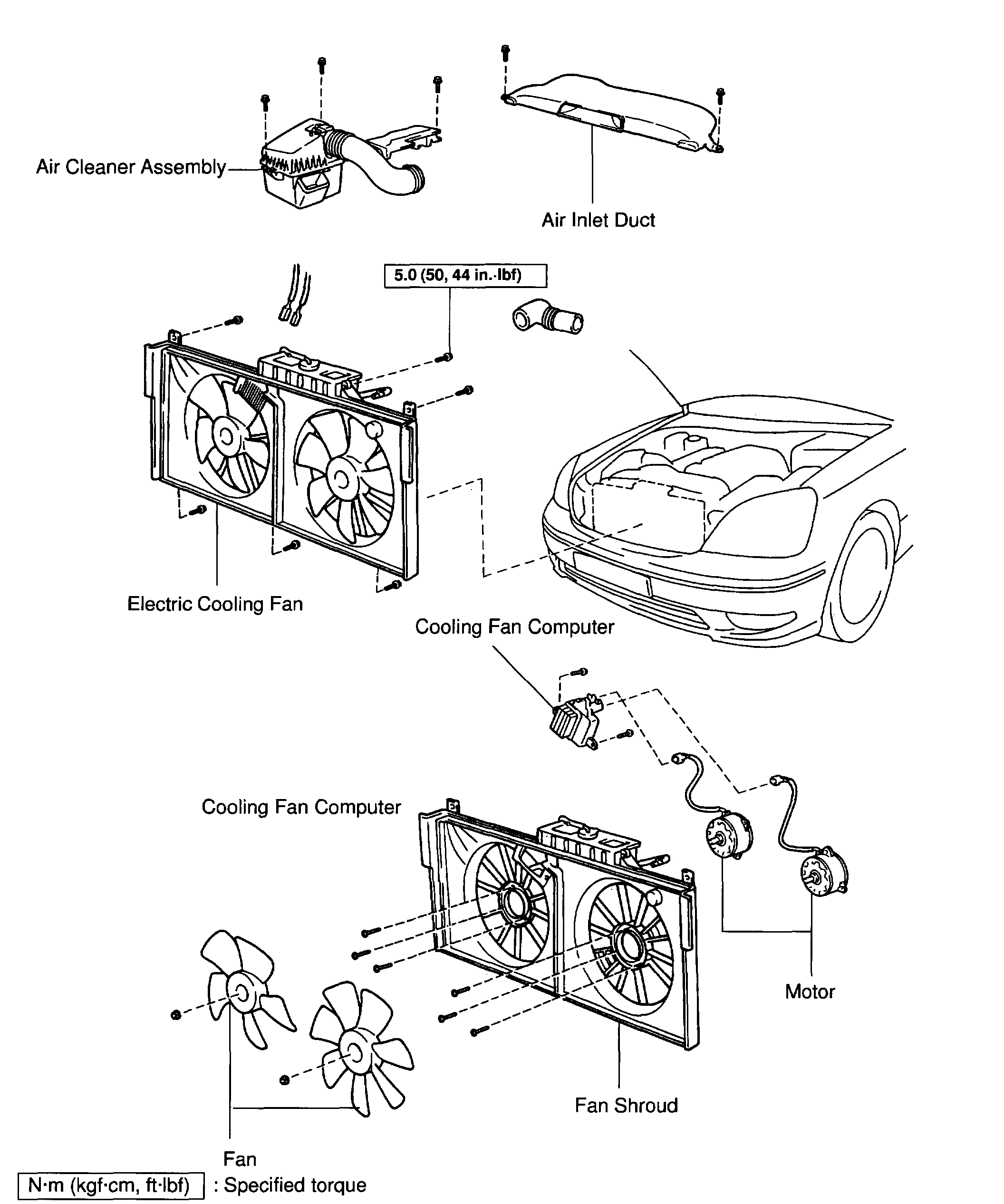

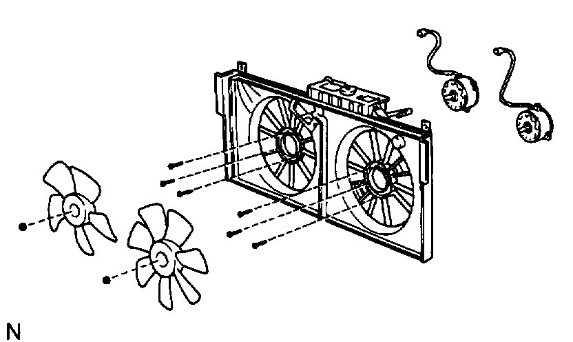

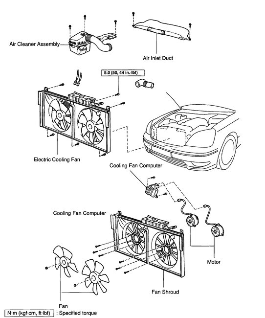

No problem. Here are the directions. The attached pics correlate with the directions.
Procedures
Vehicle Engine, Cooling and Exhaust Cooling System Radiator Cooling Fan Radiator Cooling Fan Motor Service and Repair Procedures
PROCEDURES
pic 1
REMOVAL
1. DRAIN ENGINE COOLANT FROM RADIATOR
HINT: It is not to drain out all coolant.
2. REMOVE AIR INLET DUCT
3. REMOVE AIR CLEANER ASSEMBLY
4. DISCONNECT RADIATOR UPPER HOSE
pic 2
5. REMOVE CONDENSER FAN
a. Disconnect the connector.
b. Remove the 6 bolts and fan.
Torque: 5.0 Nm (50 kgf-cm, 44 inch lbs.)

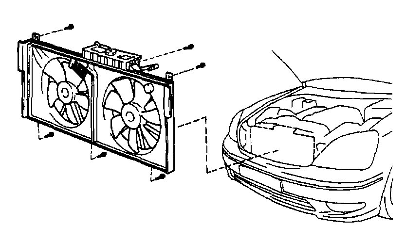

DISASSEMBLY

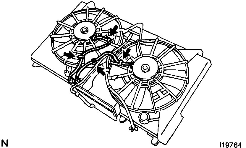

1. REMOVE COOLING FAN COMPUTER
pic 3
a. Disconnect the connectors.
b. Remove the 3 screws and computer.

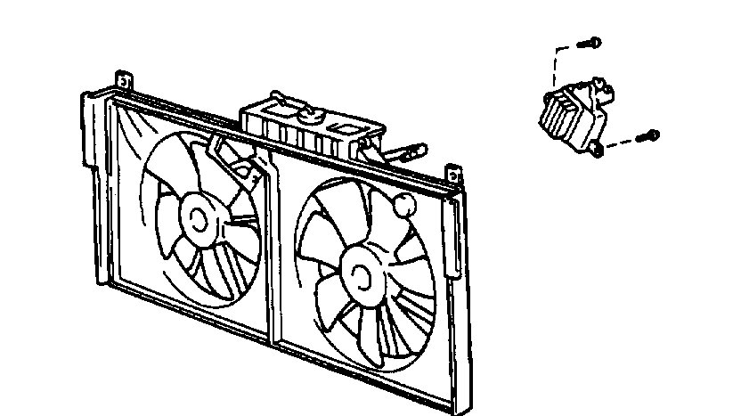

pic 4
c. Disconnect the connectors.
pic 5
2. REMOVE FAN AND MOTOR
a. Remove the 2 nuts and 2 fans.
b. Remove the 6 screws and 2 motors.
REASSEMBLY
Reassembly is in the reverse order of disassembly.
INSTALLATION
Installation is in the reverse order of removal.

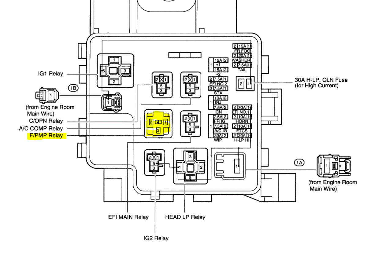

to continue (darn computer) we tried drying out the connecters with a spray can that uses Freon. Finally, we injected starting fluid into the air intake and the car started. So we believe the fuel relay/ system is not running correctly. Fact is before we replaced the fan motor the car ran just fine.
Another friend suggested there might be 3 identical relays (one being the fuel pump relay) so we could try switching one of them to see if that makes a difference.
Right now the car is sitting in a garage with the hood open, and I was planning to get back to it later this evening.

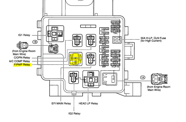

Could you send me a picture showing the location of the fuel relay and the other two relays? Finally, we're open to any other suggestion.
Thanks again as usual.
Jon
Oct 23, 2020 at 6:12 AM
  • 110,244 POSTS
I attached a pic of the fuel pump relay location. Which other two are you referring to?

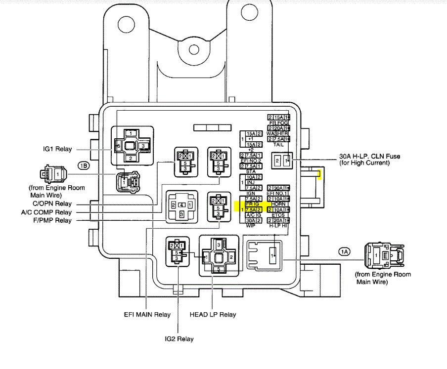

Oct 24, 2020 at 10:36 PM
JONSOLOW13
  • 133 POSTS
My mechanic friend did some research and thinks we may have blown a fuse to the ECU. Could you send a diagram for the 2001 Lexus LS430 showing the location of the fuse for the ECU? Thanks so much.
Oct 25, 2020 at 3:47 AM
  • 110,244 POSTS
Take a look at the attached pic and let me know if that is what you needed.
