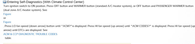

car has been parked for two days. I went outside and fan motor is running with car not running. I disconnected the battery and when I plugged back in the fan comes back on.
Jun 13, 2016 at 6:10 AM
HMAC300
  • 48,601 POSTS

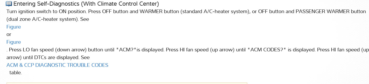

you can pull the fuse or relay for the blower on heater as I assume that is what you are talking about then have heater scanned for codes or do self diagnostics if you have auto temp control which most did.. you can check relay
