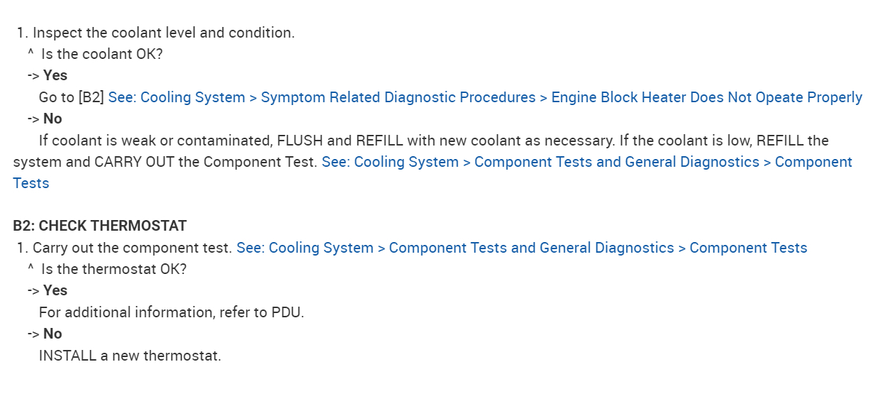

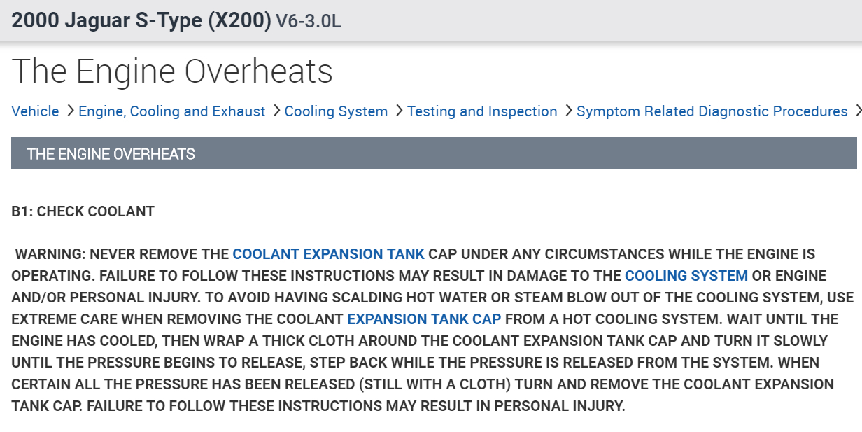

Just replaced the cylinder head over temperature sensor and now the fan is not coming on and the car is overheating
Feb 21, 2019 at 8:01 AM
SCGRANTURISMO
  • 4,897 POSTS
This could be a problem with your thermostat. I have included for you in the diagrams down below a factory troubleshooting flow chart for engine overheating. Please go through it and let us know what you find out.
