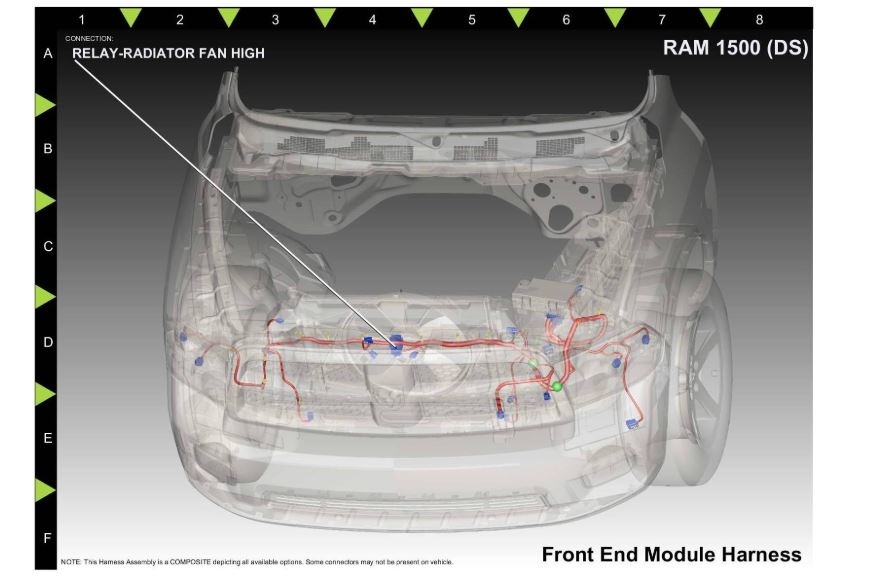

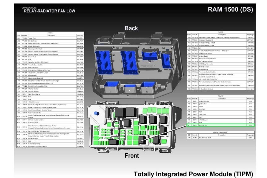

Where is that located? Seen one video where it's by the grille and another up in the fuse relay box.

Good morning,
Yes, they were correct. There is a relay at the front grille and one on the fuse block. They are for high speed and low speed operation.
I attached the locations for you of the relays.

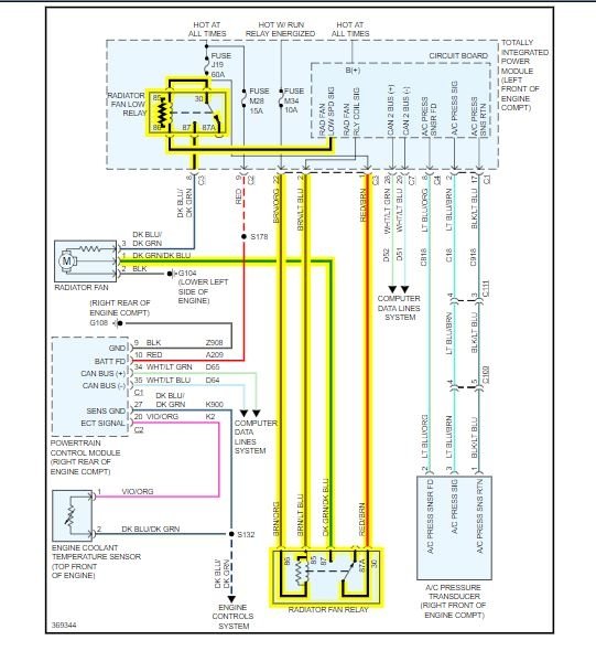

What is the issue? I also attached a wiring diagram for you for testing. If you have a test light or voltmeter we can do some testing.

Thank you found it and fixed it!
