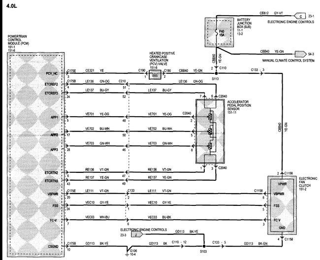

Fan clutch wire harness diagram needed.
Jun 22, 2018 at 6:54 PM
STEVE W.
  • 15,351 POSTS
This might help.
Pin 1 - Empty.
Pin 2 - Yellow with green trace = Power feed from battery for clutch.
Pin 3 - Blue with black trace = Fan control from PCM.
Pin 4 - Black with green trace = Ground.
Pin 5 - Gray with yellow trace = Fan Speed sense to PCM.
Pin 6 - Violet with green trace = Power feed from PCM for control circuit.
Jun 24, 2018 at 5:38 AM
  • 55,433 POSTS
Hi John,
Thanks for re-posting. Here are the fan clutch wiring diagrams which are in the engine wiring diagrams. Let me know if you are not on the phone and cannot enlarge the diagrams.
Here is a guide that can help:
