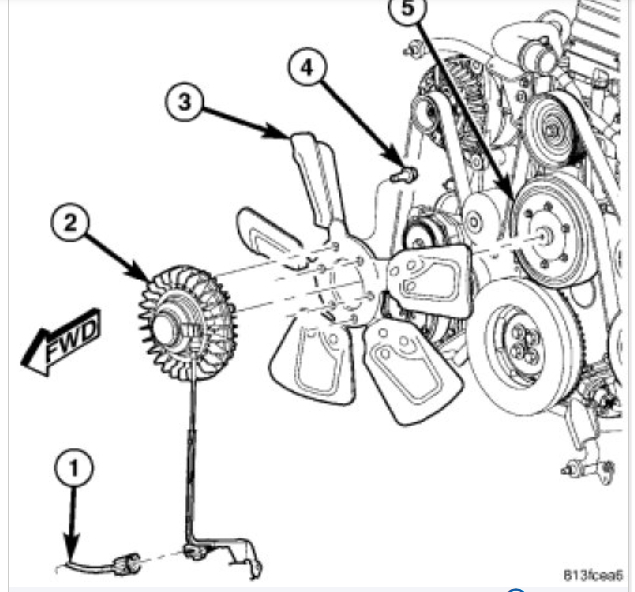

I'm trying to replace my fan clutch, but can't seem to figure out how to separate the connector from the wiring harness. What is the trick to getting it apart?

So the wiring going to the fan clutch is suppose to stay on the fan clutch as its own wiring harness. You disconnect the wiring further down the wiring, here is an image of what you need to know. Check out the images (below). Let us know how it goes
