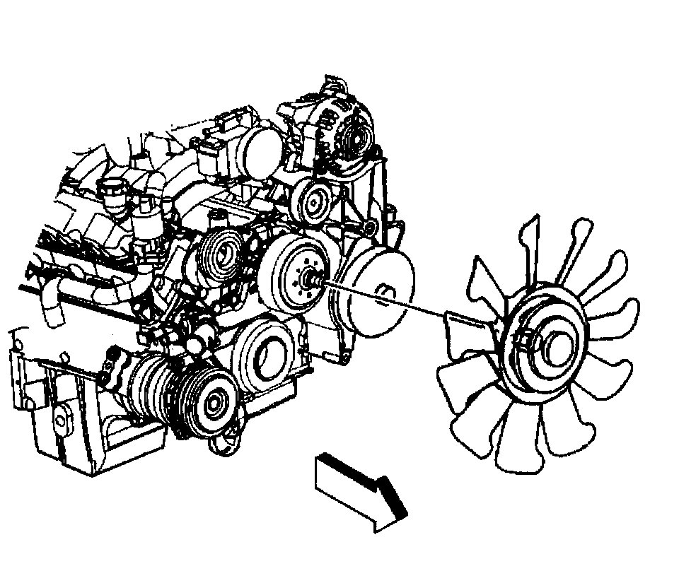

Changed the thermostat housing, coolant temperature sensor and did radiator flush.
When driving and the AC is turned on, after a short period of time especially going up a hill, vehicle starts to over heat. I need to turn off the AC and turn on the heat to bring down the temperature also when driving for awhile without the AC and making multiple short stops, when turning off the vehicle and turning back on the vehicle passing middle on the temperature guage then settles within seconds.

First, it is normal when the vehicle is hot, turned off, and then restarted for the gauge to be higher. That is because circulation in the cooling system has stopped and the coolant heats up.
Now, if the car doesn't overheat at highway speeds, then I would suspect the fan clutch. Here is a link that shows how it works:
https://www.2carpros.com/articles/how-an-electric-cooling-fan-works
With the engine off, see if it is easy to turn the fan. Do this when it is warm under the hood. It should be somewhat difficult. There should be a good drag when turning it. If it turns freely, replace it.
If you determine the clutch is bad, here are the directions for replacement. The attached pics correlate with these directions.

Removal Procedure
picture 1
1. Remove the upper fan shroud. Refer to Fan Shroud Replacement - Upper (IMIO M74) or Fan Shroud Replacement Upper (WIM74).
2. Install the J 41240 to the fan clutch.

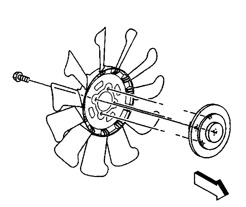

picture 2
3. Remove the fan blade.
4. Lay the fan blade face down on a workbench.

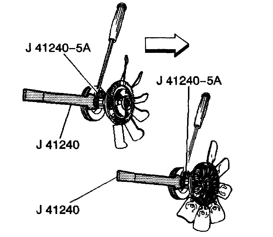

picture 3
5. Remove the fan clutch bolts from the rear of the fan blade.
6. Separate the fan clutch from the fan blade.

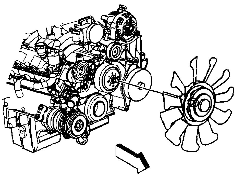

Installation Procedure
picture 4
1. Install the fan clutch bolts.
2. Install the fan clutch onto the fan blade.
Notice: Refer to Fastener Notice in Cautions and Notices.
3. Install the fan clutch bolts.
- Tighten the bolts to 23 Nm (17 ft. lbs.).
