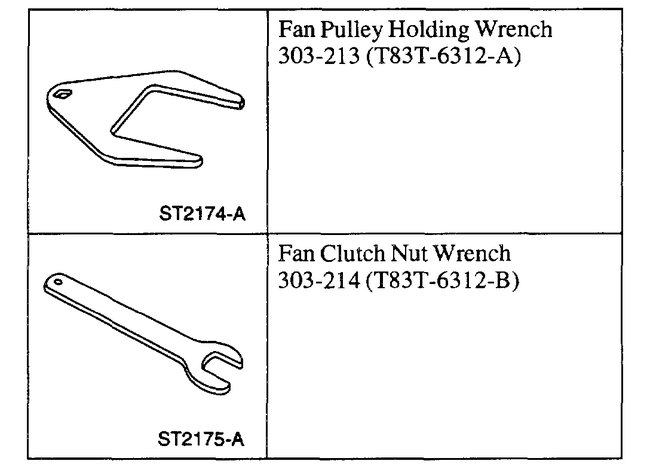

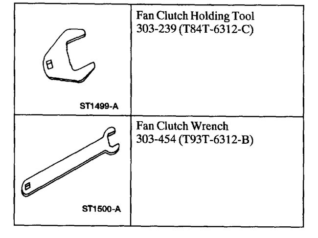

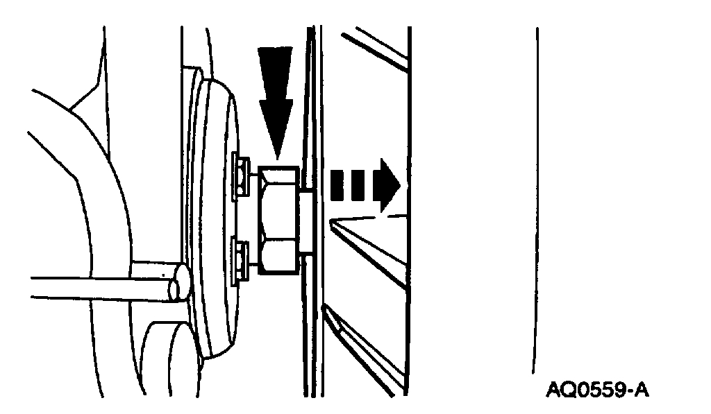

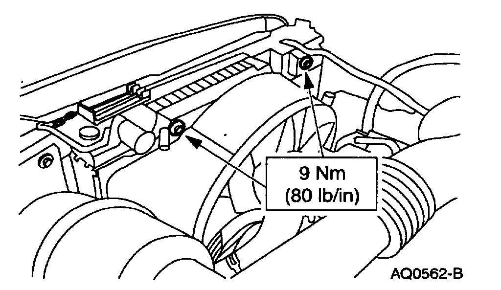

If you find it needs replaced, here are the directions. The attached pictures correlate with these directions. The special tools required are usually available from a parts store. Most will lend them to you.
Special Tools
Removal
CAUTION: Do not mix Standard (green) Coolant with Extended Life Coolant (orange). If this contamination occurs the service change interval on Extended Life Coolant will be reduced from 6 years/150,000 miles to 3 years/30,000 miles.

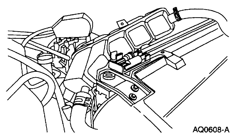

1. Remove the three bolts and position the degas bottle out of the way.

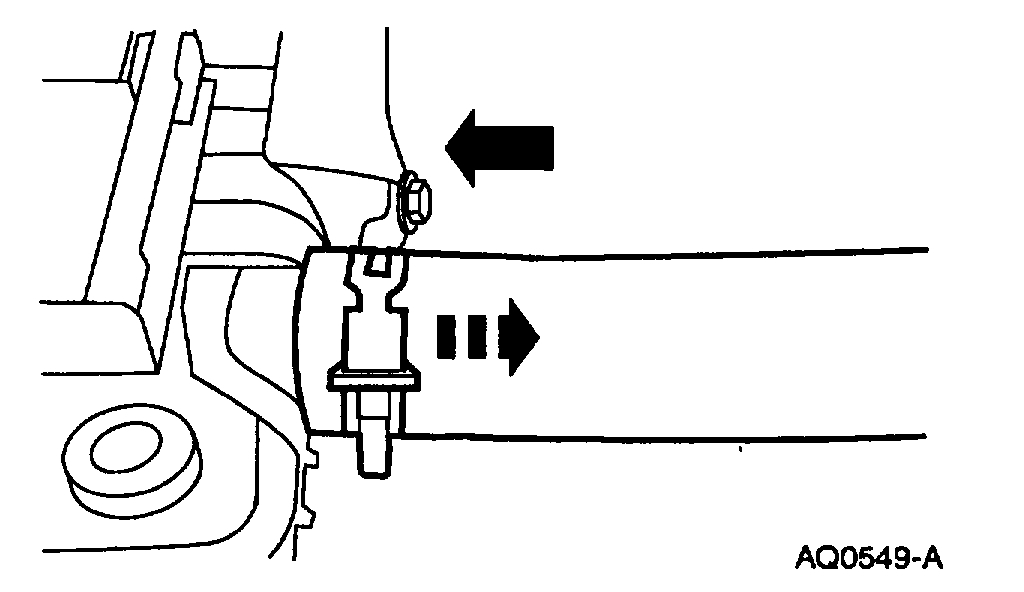

2. Squeeze the clamp, pull the hose off and position the upper radiator hose out of the way.

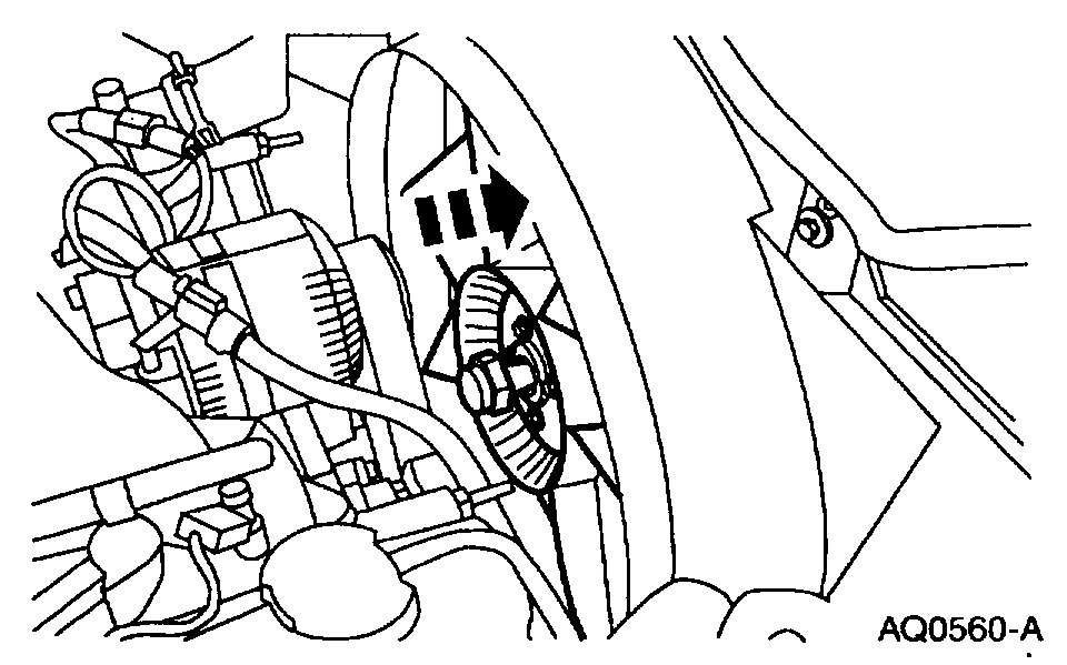

3. CAUTION: The large clutch assembly nut has a right-hand thread and must be rotated counterclockwise to remove it.
4. Carefully position the fan and the fan clutch into the shroud.

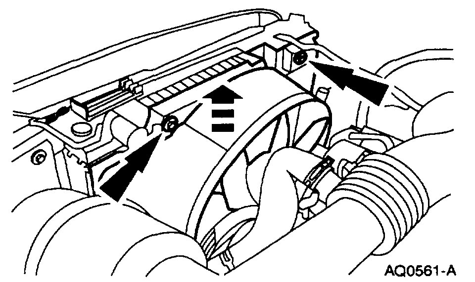

5. Remove the bolts, the shroud, fan and clutch.
