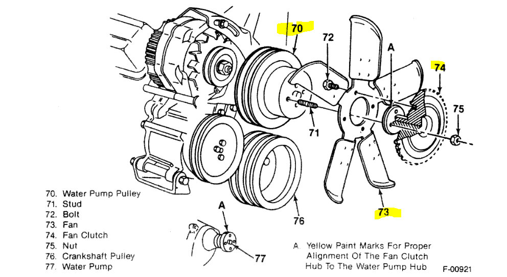

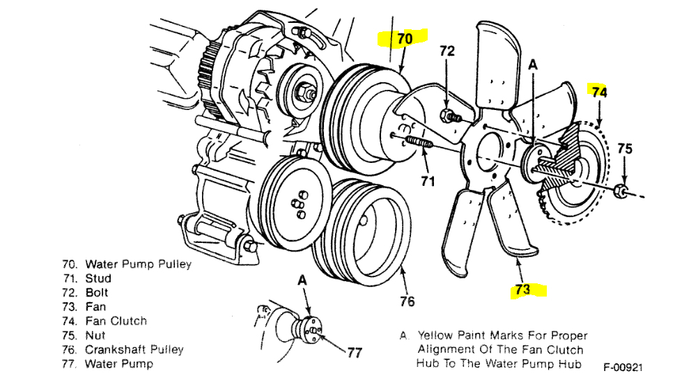

Does the fan clutch rotate the same direction as the water pump?
9JHL4
MEMBER
1989 CHEVROLET 1500
5.7L
V8
2WD
AUTOMATIC
190,000 MILES
Fan clutch rotation.
Saturday, October 28th, 2023 AT 9:19 PM
MECHANIC
110,176 POSTS
Yes, it is connected to the water pump pulley. I attached a pic below of the fan. It's an exploded view showing the different components.
