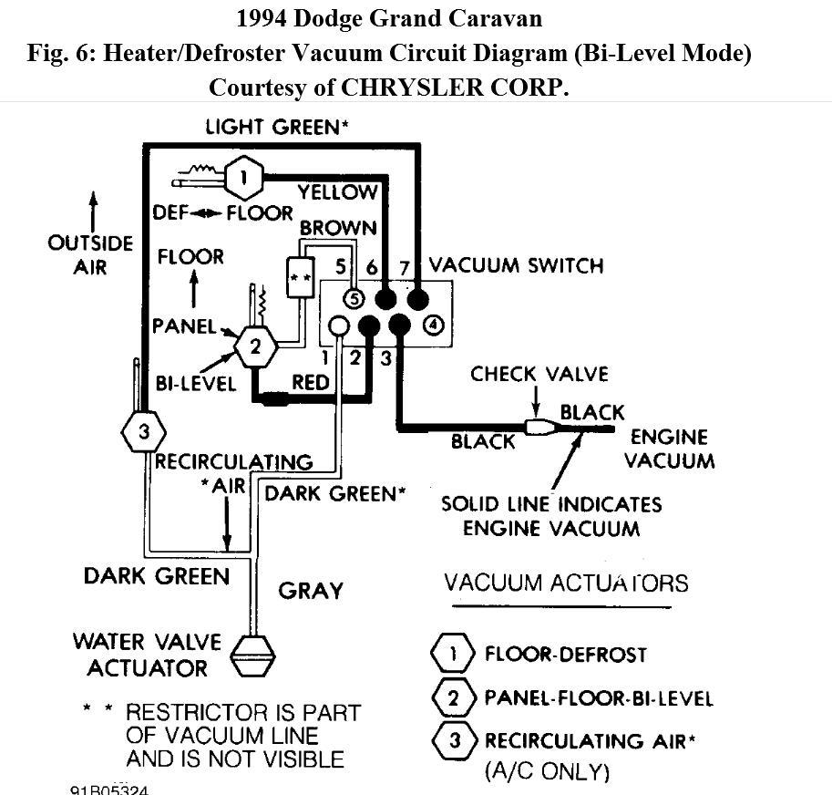

I just replaced the heater core in my 1994 dodge caravan 3.0 base, however, regardless of the fan/switch position, the fan only blows to the windshield and side front windows. No face or foot air only windshield. I missed something but what could that be? Thanks.

The mode doors are not working correctly. Check the vacuum lnes and ensure they are correctly and securely installed.

Do you have vacuum at the vacuum lines? Did you start the engine while testing the mode flow?

No vacuum at the vacuum lines while engine running and non-start mode, only the windshield and windows defrost vents received air while engine running and non-start mode. I pulled the control and disconnected the vacuum from the switch and test the lines, no vacuum.
Connected the lines again, still no vacuum, no vacuum at valves by the driver's gas paddle at the hvac box or at the switch nor the two line from the hvac box leading to the engine compartment.

Check vacuum at engine side. Hose could be dislodged or kinked.

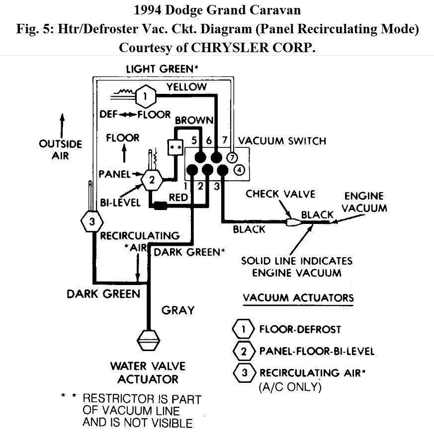

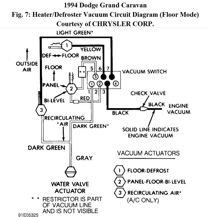

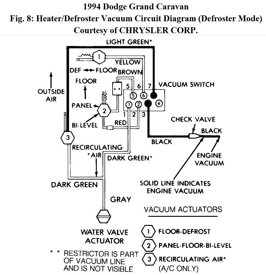

The various diagrams shows how vacuum flows in each mode. From the brake booster, there must be vacuum going to the HVAC system. If you do not have any vacuum from the brake booster, the vacuum line is either kinked or dislodged.
If any of the vacuum lines providing engine vacuum is leaking or dislodged, it would affect the others.

Thanks for your continuous response. This's where I'm now, when I disconnected the vacuum line (black line ) coming from the HVAC system to the Blake booster connecter, (vacuum check valve?), With a finger placed over the booster hose, my finger get sucked -in by the Blake booster side, but not from HVAC line side.
You said "From the brake booster, there must be vacuum going to the HVAC system.
Why then the blake booster line is sucking air inside the booster but not pushing air/vacuum to the HVAC system? Is the blake booster suppose to work like that?
If it's designed to work like that, then there is vacuum there at blake booster?

The brake booster works on vacuum and the HVAC system piggy backs on the system. You need to check the hose leading from booster to HVAC system. There is a checkvave in betyween, ensure it has not been reversedly installed, which would result in a no vacuum situation.

Success, it was exactly as you said, the check valve was reversely installed. Corrected it and all is good. Thanks. Please send link so I can increase my donation a bit.
