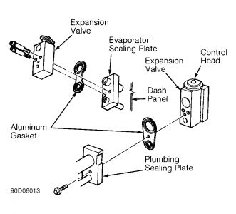

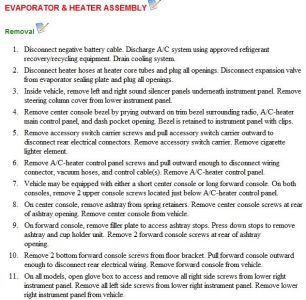

Thinking seriously about removing the heater core to inspect its condition. Windshield fogging, serious bad smell coming from the vents and giving me a serious headache, antifreez not leaking, nor on the carpet tho.
Do I need to remove the steering from the steering column in order to remove the heater core?

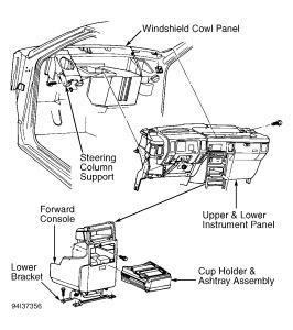

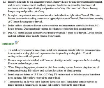

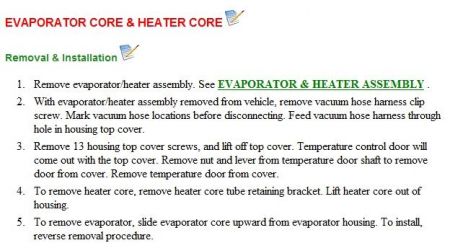

No the steering wheel does not need removed. Alldata should include all steps necessary for removing and installing the heater core, but just in case you didn't get it all I will post Mitchell1's version for you. .

Thanks, your email received and successfully printed.
Now looking forward to take the van to AC guy to
discharge the system and order a new a Auminum Gasket before I start the task. Refrigerant oil?

Just started this monter job today, (heatercore/ac evaporator removal), the way I see it, the whole dash has to come out unless I'm wrong.
I'm having difficulties locating "right and left panel silencer"under the dash. What do they look like?
So far about 50% or more of the dash panel removed, I need help regarding the above questions. Anyone? Thanks

The silencer panels are the plastic trim pieces that sit beside the driver's legs. The right trim will be to the right of the driver's right leg and visa versa for other. It's just plastic paneling that is held on by several plastic clips in the back of it and maybe a few screws.

Thanks for the response, I'm sure I over did it, almost every panel is removed except the airbags and speedometer. The instructions are not detailed enough for me espercially without more pictures.
Well I managed, the ac and heater core housing is removed, antifreeze leaks are all over inside the housing.
