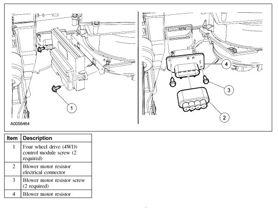

Fan blower only works on three and four.
May 1, 2018 at 6:36 PM
  • 110,194 POSTS

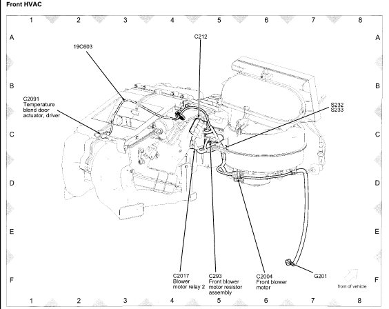

The blower motor resister is bad. It is located under the dash on the passenger side of the vehicle. I attached a picture to help locate it. It will be held in with two screws. Simply disconnect the wiring plug, unscrew it, remove, and reverse the order to replace.
