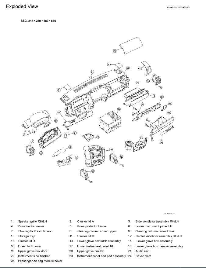

I need to clean or eventually replace the fan blower on the vehicle listed above T31. I cannot find any information on the location of the equipment. I would appreciate any help. thanks.
Jun 25, 2022 at 3:16 AM
SQM
  • 6,383 POSTS

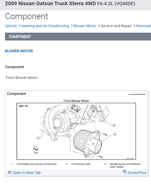

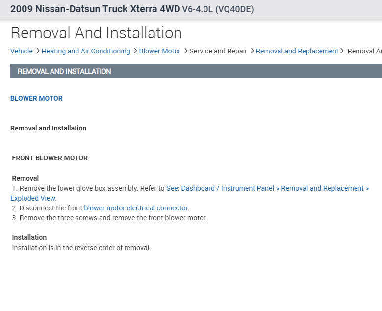

Please note that the Xtrail is not offered in the United States, so we don't have manuals specifically for the Xtrail.
However, it is similar to the Xterra that is sold in the United States.
And on that vehicle the blower fan is located behind the glove box.
The glove compartment has to be removed in order to access the fan.
I have attached diagrams below for your reference.
Let me know of any questions.
