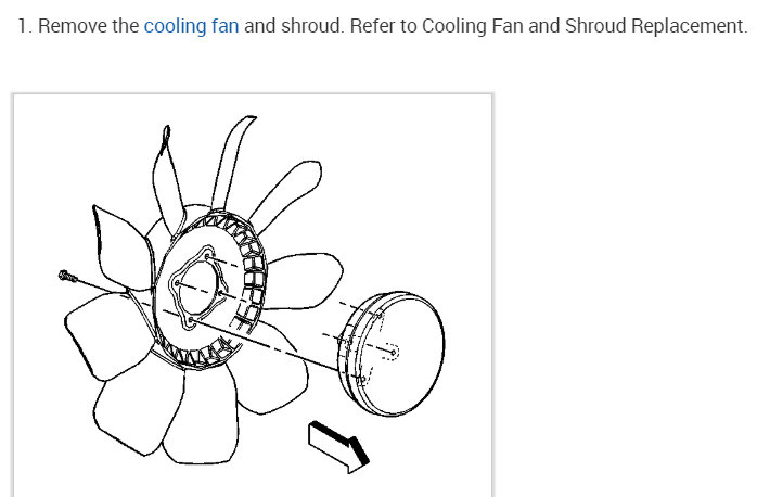

Fan blade loose.
May 9, 2020 at 7:43 AM
DANNY L
  • 5,648 POSTS
Hello, I'm Danny.

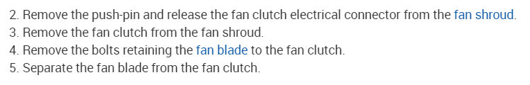

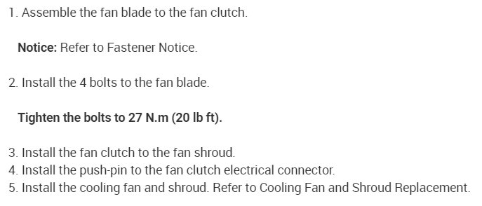

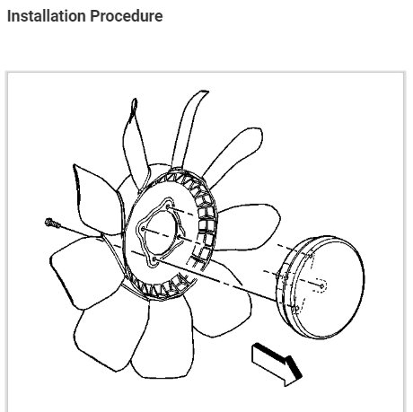

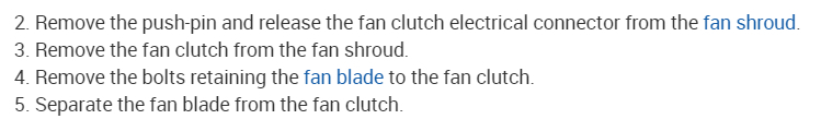

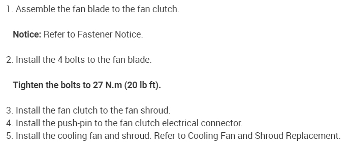

Your fan blades are bolted to the fan clutch assembly.Here is a tutorial for you to see about removal and replacement.After removing you will have access to the bolts to tighten.Here is a tutorial showing what is involved:
https://www.2carpros.com/articles/fan-clutch-removal
I've attached picture instructions below for your Trailblazer.Hope this helps and thanks for using 2CarPros.
