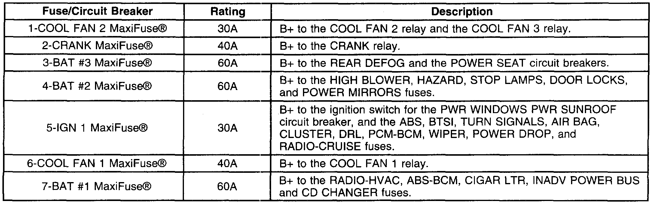

Now, if the electric fans are not turning on, the first thing I need you to check are the fuses in the under hood fuse box. There is a 30 amp fuse there that provides power to the fan relays. I attached the fuse box legend relevant to this fuse.

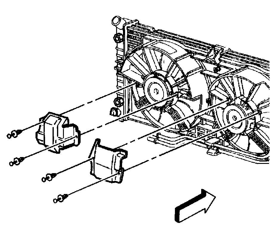

2. Remove the cooling fan heat shield(s).

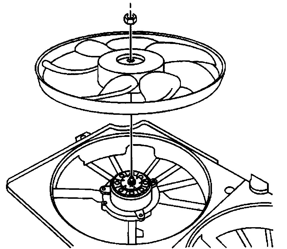

4. Remove the cooling fan blade nut.
5. Remove the cooling fan blade.

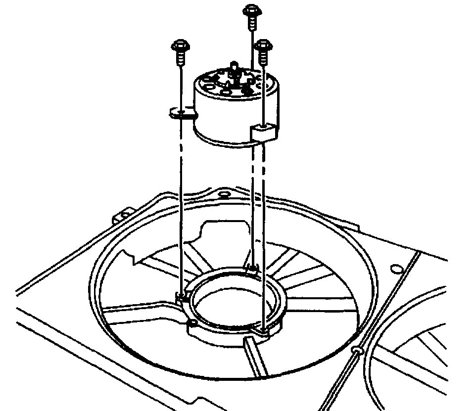

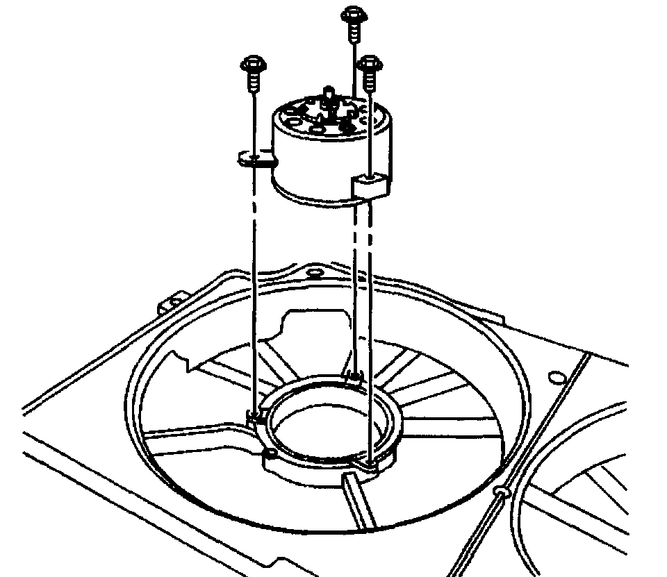

7. Remove the cooling fan motor bolts.
8. Remove the cooling fan motor.

1. Install the cooling fan motor.
2. Install the cooling fan motor bolts.
^ Tighten the cooling fan motor bolts to 6 Nm (53 inch lbs.).

3. Install the cooling fan blade.
4. Install the cooling fan blade nut.
^ Tighten the cooling fan blade nut to 6 Nm (53 inch lbs.).

6. Install the cooling fan heat shield(s)
