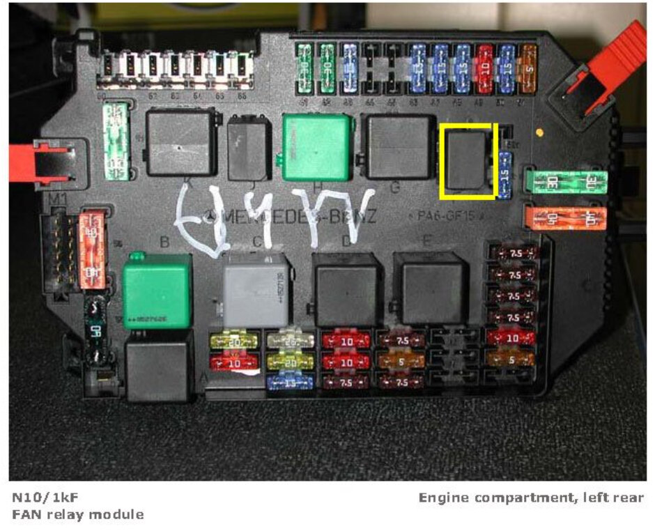

Cooling fan continuously running at high speed?
2011 MERCEDES BENZ S550
130,000 MILES • 5.5L • V8 • AUTOMATIC
LEAHD54321
Fan continuously running at high speed and takes a significant amount of time to turn off after the car is off. Ruined my battery
Apr 11, 2025 at 1:15 PM
  • 55,412 POSTS
Yes, this happens when the fan control module goes out or the engine coolant sensor goes out.do you have a check engine light on? If not, here is the location so you can change the control module out to fix the problem. You might want to do a CAN scan to help confirm the failure.
https://youtu.be/u-4syLc-ifQ
Check out the images (below). Let us know how it goes.
