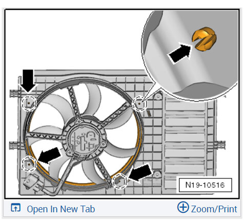

Cooling fan staying on when I start the car all the time.
Oct 8, 2024 at 4:57 AM
  • 55,691 POSTS

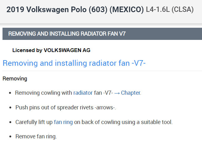

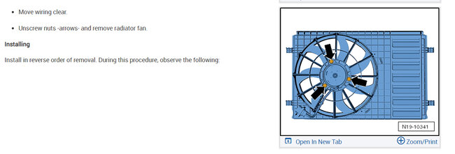

Yep, this happens, when the radiator cooling fan module goes out which is incorporated into the cooling fan motor itself. Here is how to change it out to help fix the problem. Check out the images (below). Let us know what you find.
