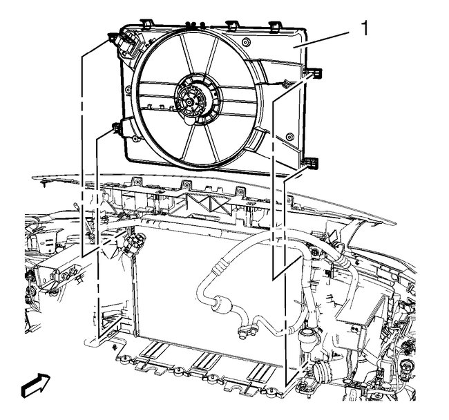

My fan is making a noise and is very wobbly when running.

If the mount is tight and the fan is wobbling, then the bearing in the motor is likely bad. Is it possible for you to record and upload it so I can see and hear it?
If you agree that it needs replaced, here are the directions for removal and replacement. The attached pics correlate with the directions,

Removal Procedure
1. Unclip transmission cooler lines from shroud if equipped.
2. Unclip radiator surge tank outlet hose from fan shroud.
3. Disconnect the engine coolant fan wiring harness.
pic 1
Note:
You stand against driving direction.

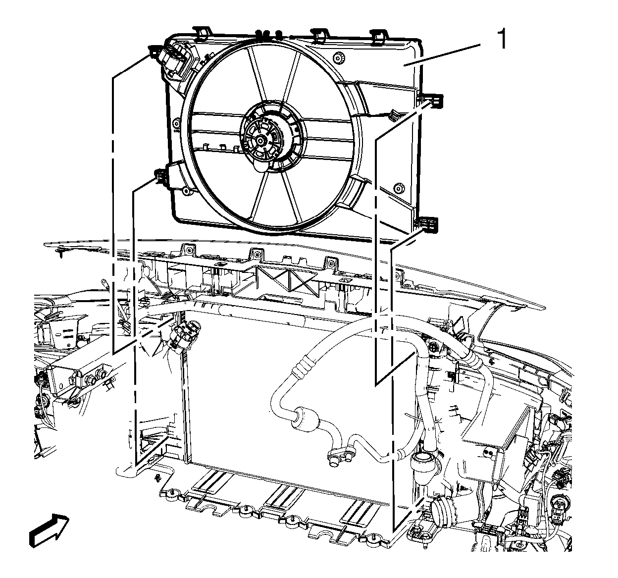

4. Unclip the engine coolant fan shroud (1) at the shown four mounting points.
5. Remove the engine coolant fan shroud (1).
pic 2

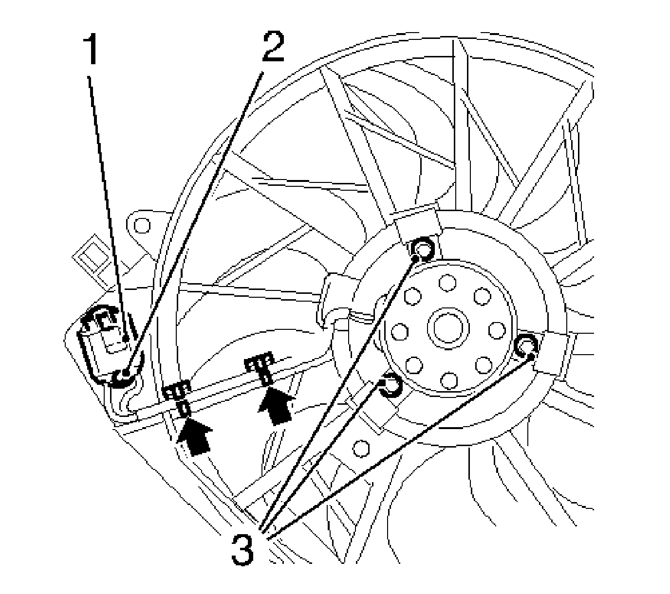

6. Remove the engine coolant fan resistor (1) by unclipping the retainer clip (2).
7. Unclip the engine coolant fan to engine coolant fan resistor wiring harness (arrows).
8. Remove the 3 engine coolant fan engine bolts (3) from the engine coolant fan.
9. Remove the engine coolant fan.

pic 3
1. Install the engine coolant fan.
Caution:
Refer to Fastener Caution See: Vehicle > Technician Safety Information > Fastener Caution
2. Install the 3 engine coolant fan engine bolts (3) to the engine coolant fan and tighten to 4 Nm (35 lb in).
3. Clip in the engine coolant fan to the engine coolant fan resistor wiring harness (arrows).
4. Install the engine coolant fan resistor (1) by clipping the retainer clip (2).
pic 4
5. Install the engine coolant fan shroud (1).
6. Clip in the engine coolant fan shroud (1) at the shown four mounting points.
