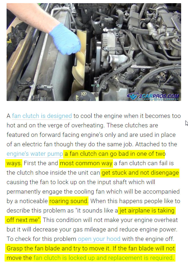

Here is a guide that goes through the detail about why a clutch will cause the roar of the fan:
https://www.2carpros.com/articles/fan-clutch-symptoms

It's a clutch fan. also has electric o e in front of A/C pump on radiator. I read the article i just do not understand. it says if it doesn't turn easily it's locked up, but if it turns to freely it's bad and not going to work. it doesn't make sense because it turns easy by hand but is engaged and sounds like a "jet plane" all the time.
Feb 15, 2020 at 8:11 PM
Okay. The article does not cover 100% of the types of failures, just the most common. So in most cases if the fan doesn't spin easily then the clutch is stuck on.
It could be the fan clutch but we have to rule out everything else first since yours doesn't match this description.

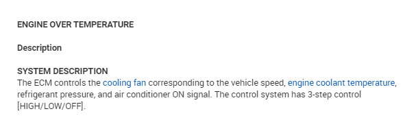

You said your fan was easy to spin and felt free and not locked up. This would point to the fact that the clutch is not locked up and holding the fan on when the engine is running. Take a look at the attachment. That is what I meant by turning the fan. When you turn it by hand with the engine off, it should spin freely and not be hard to turn.
The fact that your clutch does not sound like it is locked up we need to find out why it then engages when the engine is turned on. Usually this is because it is commanded on by the engine controller. This means either the engine controller is the issue or something is telling the controller to do that when it shouldn't. The only thing the engine controller looks at to determine this is the ECT so let's just turn the key on after sitting overnight and see what the ECT temperature is reading. It should be very close to the ambient temperature and intake temperature. Let me know what each three are after it has been sitting for a while and we can go from there. Thanks

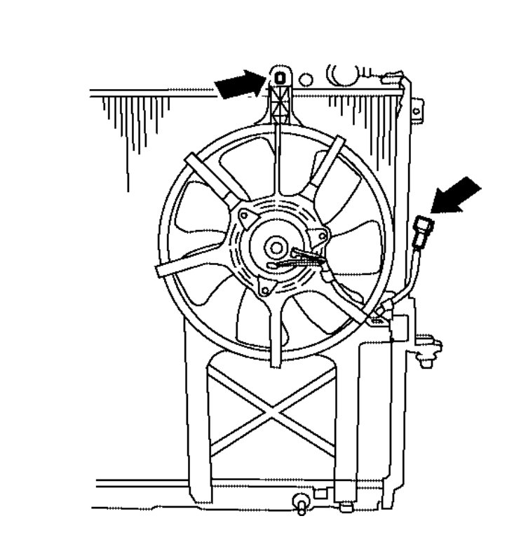

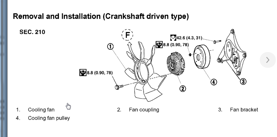

Sorry. The service info for this vehicle says that your vehicle has the electric fan on the radiator for the AC condenser and then has the cooling fan as an electric clutch (see attached). That means then ECM would apply the clutch and remove it.
If yours has a viscous clutch then that explains the issue you are seeing.
The non ECM controlled are the two types you are mentioning. One is spring controlled. As the spring heats up it begins to engage the clutch until it is fully applied.
The other is fluid filled or a viscous clutch. These too have a spring which allows the silicone to leave the reservoir in the front of the clutch and engage the blades. The spring moves as it get hotter.
Here is a video that gives more detail on this:
https://youtu.be/UwM4OqsLek4
Since you are able to spin the clutch by hand, that shows the spring inside has stopped moving which opens and closes the opening for the silicone to engage the clutch. That means when the engine turns on, the centrifugal force causes the silicone to engage the clutch then when you shut the vehicle off, the silicone drains back and disengages the clutch allowing you to spin it by hand.
Long story short. It needs to be replaced.
