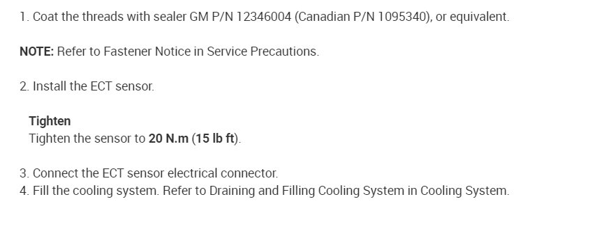

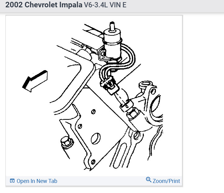

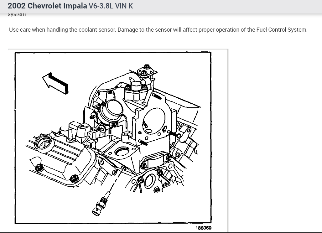

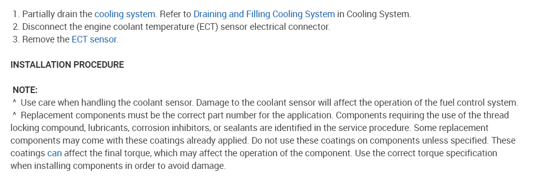

Yep, it sounds like the engine coolant temperature sensor is stuck at the upper range. here is the coolant sensor location so you can sway it out, let me know how things go. Check out the diagrams (below). Please let us know what you find. I left location for both the 3.6 and 3.4.
