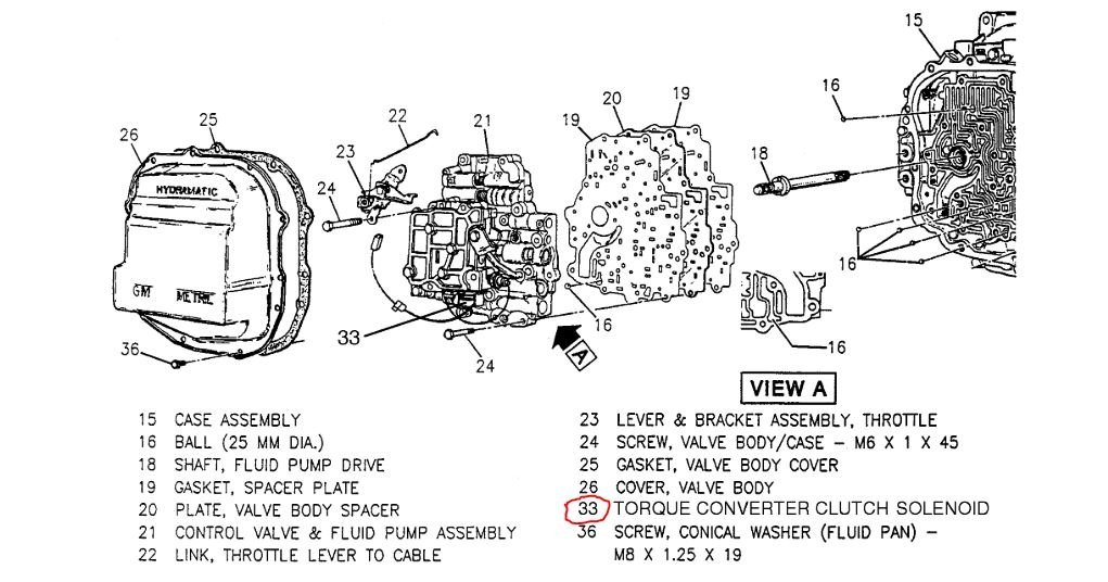

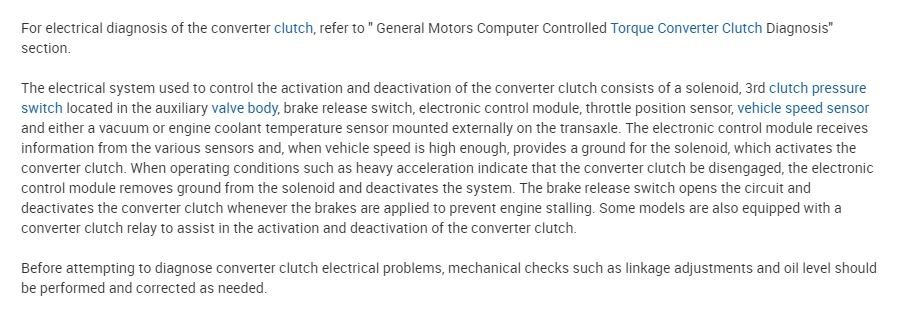

Good afternoon,
This sounds like the torque converter is locked up causing it to stall at idle whether in drive or reverse.
Is the check engine light on? If it is, I need the code to see if one of the solenoids has set a failure code.

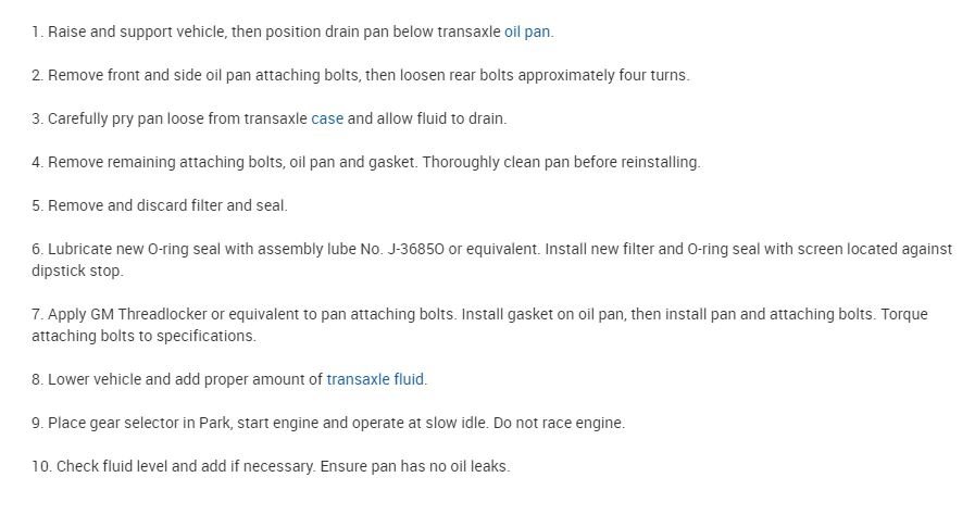

When was the last time you changed the fluid and filter?
Feb 17, 2020 at 6:11 AM
TOSHIAANN1
The check engine light only comes on after it shuts off. The fluid and filter were checked about 6 months ago.
Feb 17, 2020 at 6:13 AM
Okay, that was 6 months ago. You need to do it now to see if there is any metal in the pan on the magnet.
