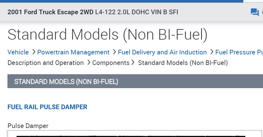

I replaced fuel pump fuel filter and relay. But when I get to a stop it sometime shuts off! It will crank up after one or two attempts. This didn't start until I replaced those parts. What's up?

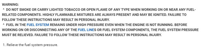

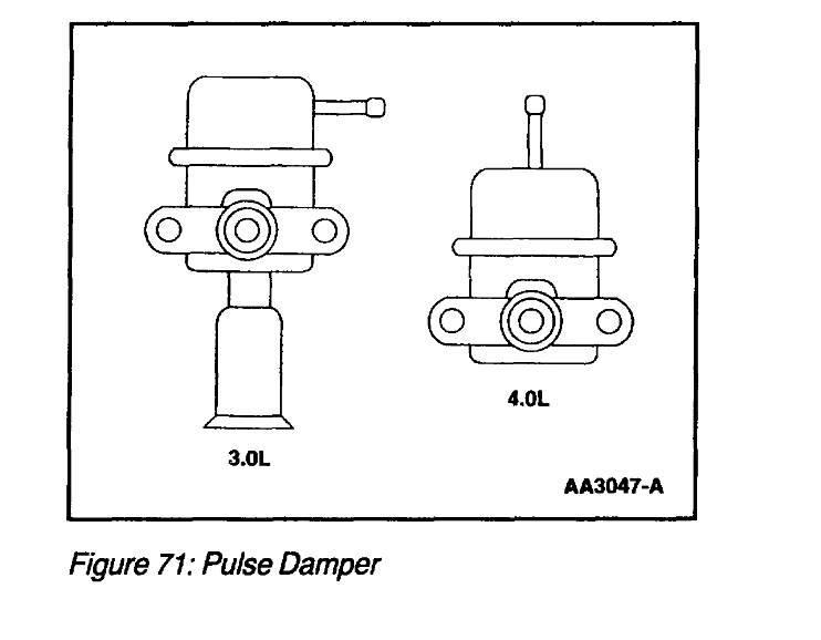

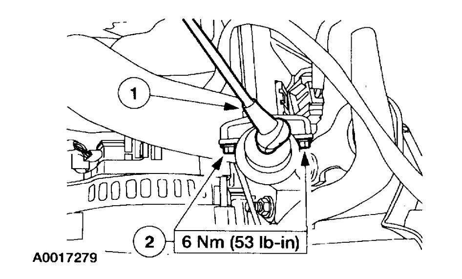

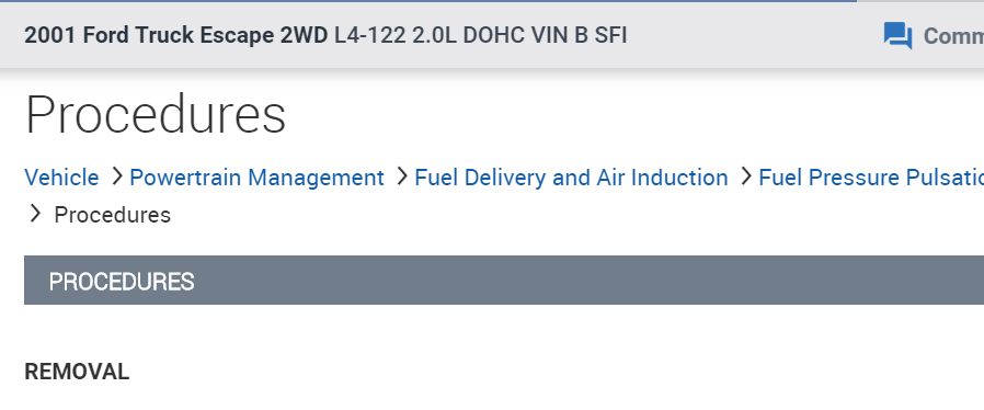

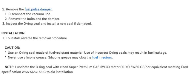

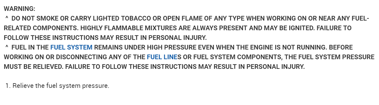

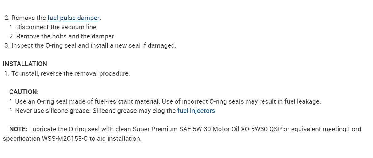

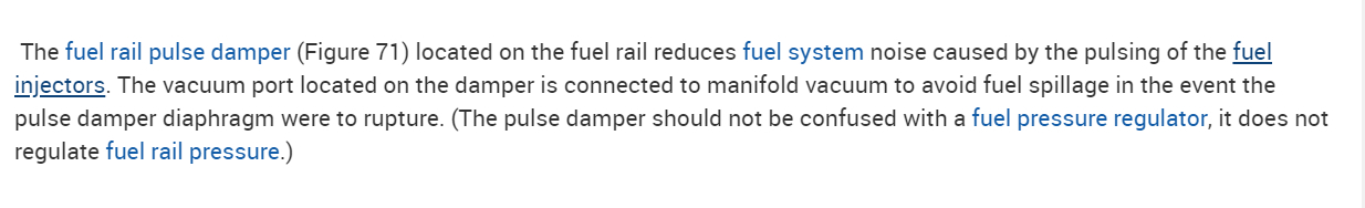

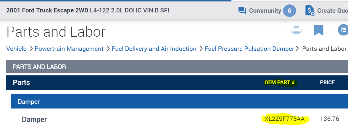

This could be a problem with your vehicle's fuel rail pulse damper. In the diagrams down below I have included a description of the fuel rail pulse damper, Original Equipment Manufacturer (OEM) part number, and the removal and installation guide for the fuel rail pulse damper for your vehicle. Please go through these guides and get back to us with what you are able to find out.
