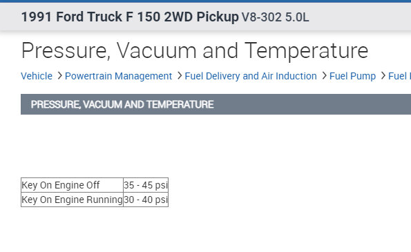

Is it possible for you to borrow a fuel pressure gauge from a parts store? Most will lend one to you at no charge. Also, here is a link that explains how it's done:
I attached the manufacturer's fuel pressure specifications below. Keep in mind, if the pressure is 20 PSI, it will spray out of the Schrader valve, but it isn't enough for it to run properly.

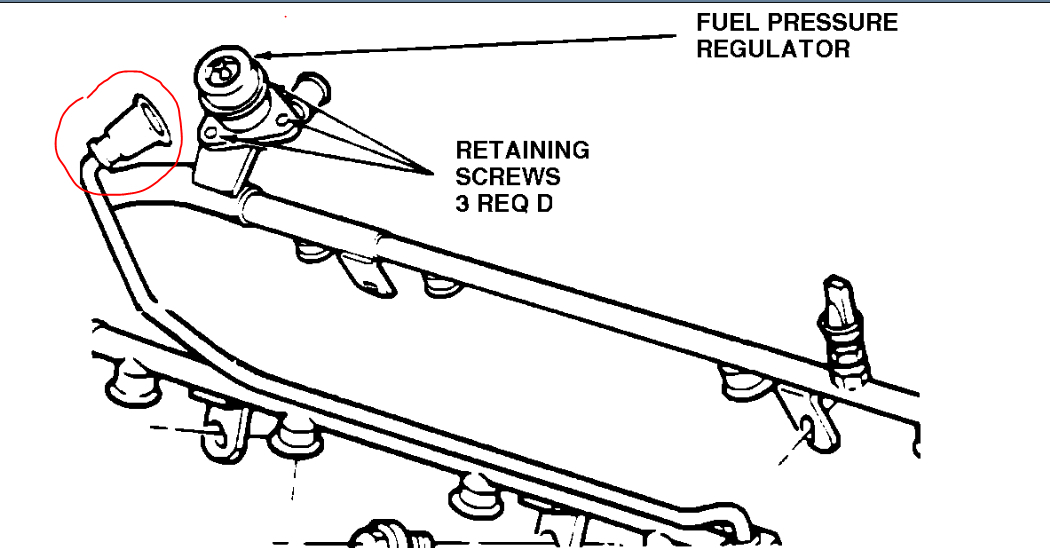

Also, disconnect the vacuum hose from the fuel pressure regulator on the fuel rail and make sure there is no evidence of fuel being drawn into it. See pic 2.
