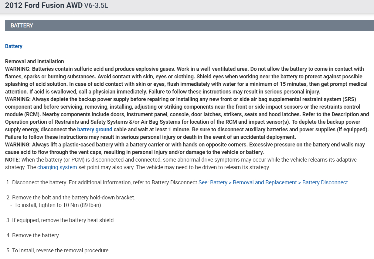

Parked the car at night came out in the morning and it won't start. It has power when I turn the key to start it only makes a clicking noise.

This is common when the battery needs to be replaced but to be sure please go over this guide:
Here is a generic guide to help you step by step with instructions in the diagrams below to show you how on your car:
https://www.2carpros.com/articles/how-to-replace-a-car-battery
Image (Click to enlarge)
