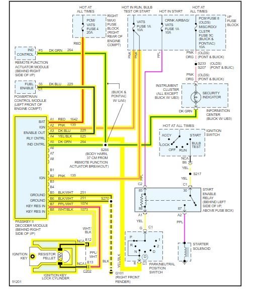

Security light flashing car won't start.
Oct 20, 2020 at 5:40 AM
Good morning,
I attached a guide for you to reset the security system. Try this and let me know if it helps.
https://www.2carpros.com/articles/how-to-reset-a-security-system
Beyond that, there may be an issue with the security system itself. I attached a wiring diagram of the system for you as well. We will need some checks if the reset does not work.
