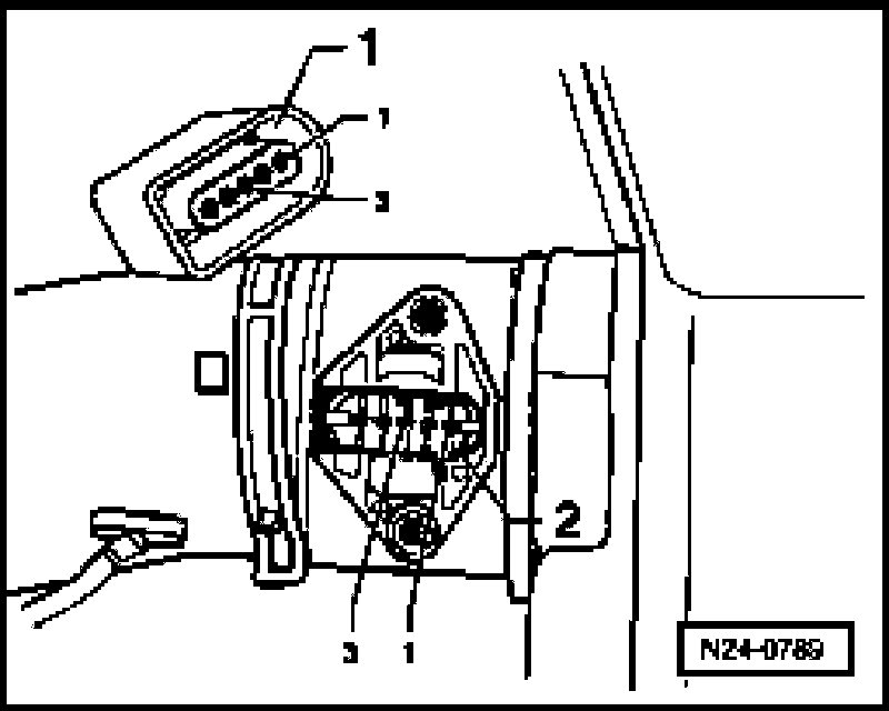

Testing power supply to Mass Air Flow (MAF) sensor
Picture 1
- Pull 5 pin connector -1- off Mass Air Flow (MAF) sensor -2-.
- Connect multimeter to measure voltage on connector contact 2 and engine Ground.
- Start engine and run at idle speed.
Specification: 11 to 15 V

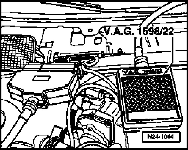

Testing signal and Ground wires for Mass Air Flow (MAF) sensor
Picture 2
- Connect test box VAG 1598/22 to control module wiring harness.
Picture 3
- Check wiring between test box and 5 pin connector for open circuit using wiring diagram.
Contact 5 + socket 13
Contact 4 + socket 11
Contact 3 + socket 12
Wire resistance: Max. 1.5 Ohm
- Additionally check wires all for short to one another.
Specification: Infinite Ohm
- Additionally check the wiring for short to battery positive or Ground.
If no wiring malfunction is detected:
