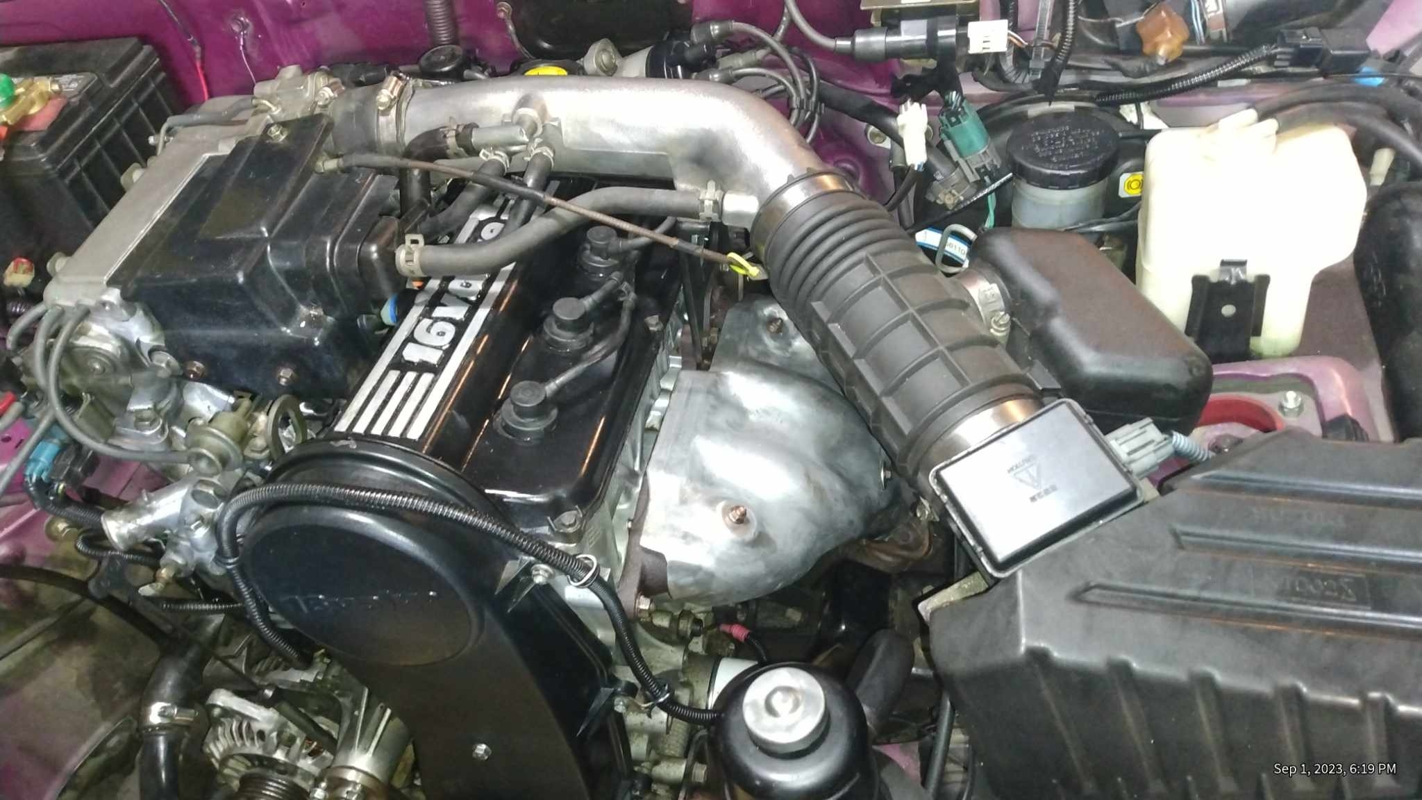

Over the last six weeks I have tried to get my vehicle to pass smog. I am close after all the repairs I have done.

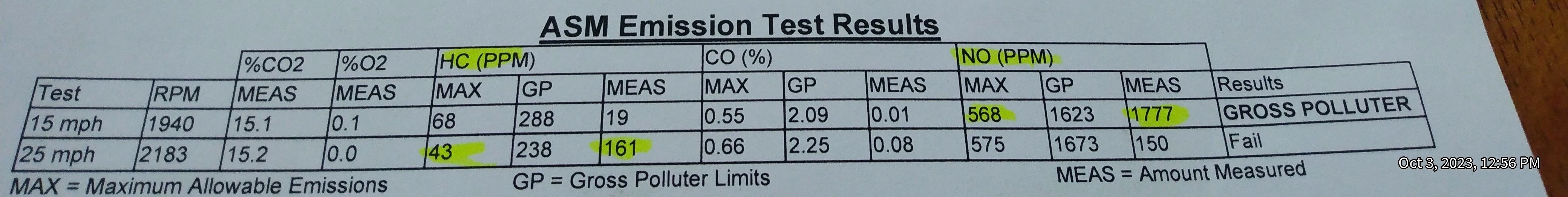

Now I am baffled. On the dyno at 15mph my HC is only 19ppm, but at 25 MPH it shoots to 161ppm (max 43). The opposite on NOx. At 15mph it is very high (Gross Polluter) at 1777 but at 25mph drops to 150ppm (max allowed 575.)
I have changed and fixed everything I know to. Baffled.

High HC is indication of incomplete combustion (rich fueling).
NOx is a product of high combustion temperatures (check timing advance).
How is the O2 sensor doing? Is it responding quickly and showing a change from rich to lean quickly?

That is an odd one. The significant changes in hydrocarbon (HC) and nitrogen oxide (NOx) emissions between 15 MPH and 25 MPH during a dyno test can be indicative of various possible issues.
The drop in NOx at 25 MPH could indicate that the catalytic converter is working better at higher speeds. Also, a malfunctioning oxygen sensor can lead to incorrect fuel mixture and affect emissions. Differences in speeds may cause variations in sensor readings. Have you checked the oxygen sensor voltages? Are there any engine vacuum leaks or exhaust leaks?
There are many other possible causes.
What has been done at this point? Are there any diagnostic trouble codes stored or pending? Do you have a live data scan tool that we can use to check fuel trims, Oxygen sensor voltages, and other data? If you have a live data scan tool, check what the short-term fuel trims are at operating temperature. Also, note each oxygen sensor's voltage readings and let me know.
Let me know. Also, let me know what has been done to date.

Hi Joe. Great feedback. I must admit I have gotten in over my head at this point.
Do not have enough diagnostic tools for this fine tuning.
Engine rebuilt 50,000 miles ago. I took the head taken off last month and replaced valve seals and lapped the valves. 195-200 PSI compression on all cylinders.
Cleaned And checked EGR for correct function per FSM as well as EGR regulator.
Not many vacuum lines on this engine. They all appear good.
New 02 sensor, catalytic converter, gaskets on intake and exhaust.
Runs absolutely great. Idle is smooth. Timing is dead on. Evap system checked.
Fuel pressure regulator is the only system I have not checked.
New oil 5w30 synthetic. New air filter.
No fault codes show up in OBD1 blinking check engine light test.
Test results have gotten better each of the three times as I go through each system.
Need to study up on fuel trims and checking O2 sensor voltage. There is a vacuum actuated fuel pressure regulator I have not touched.
