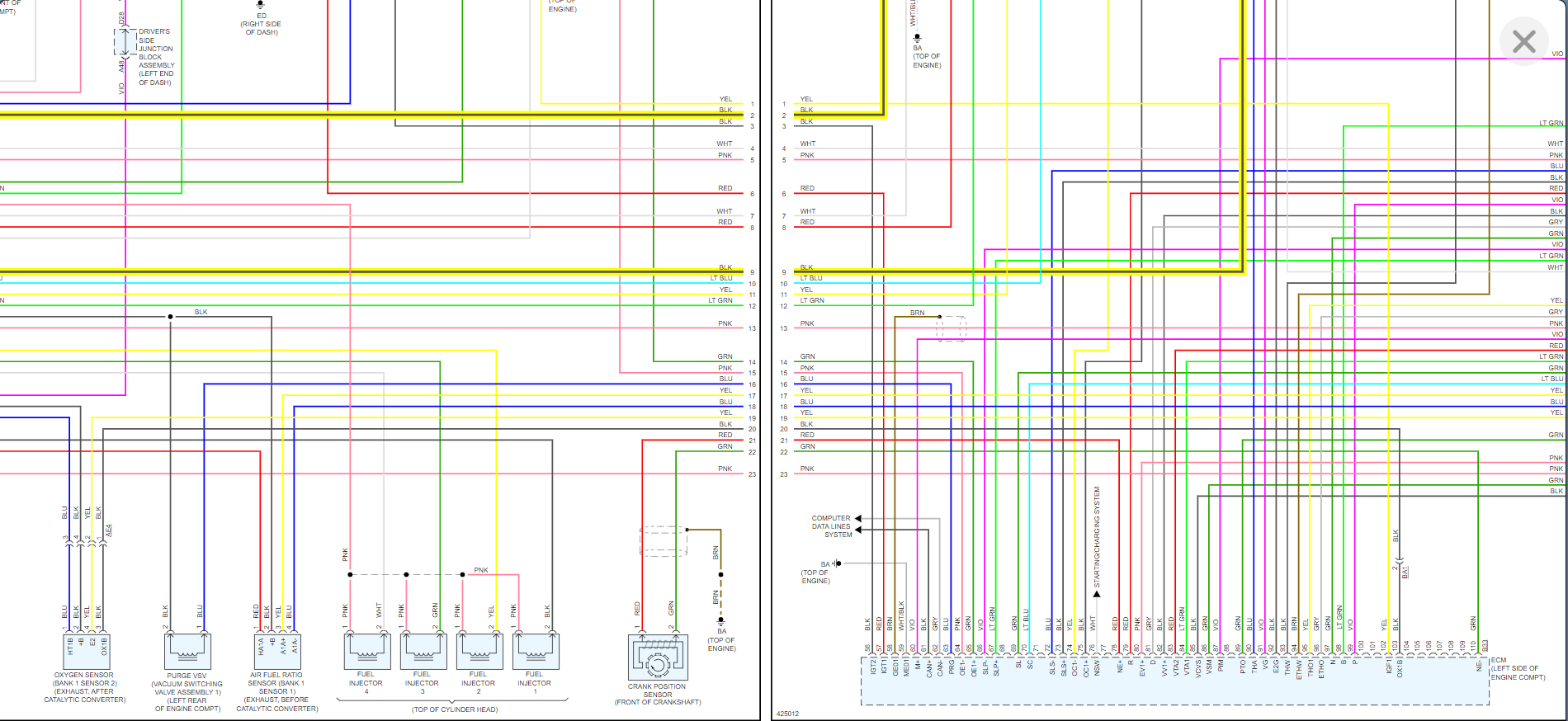

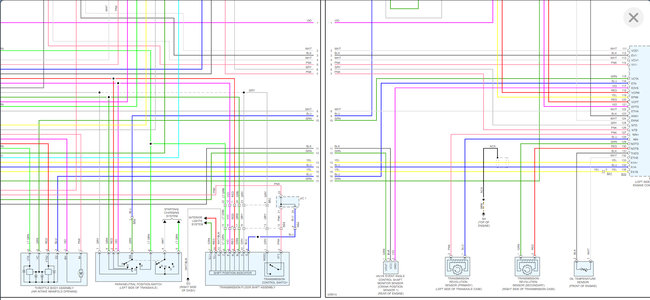

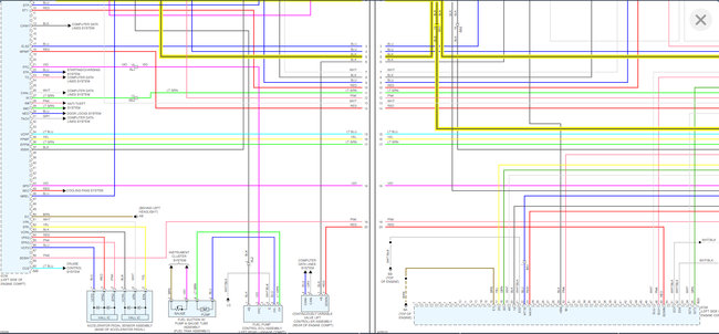

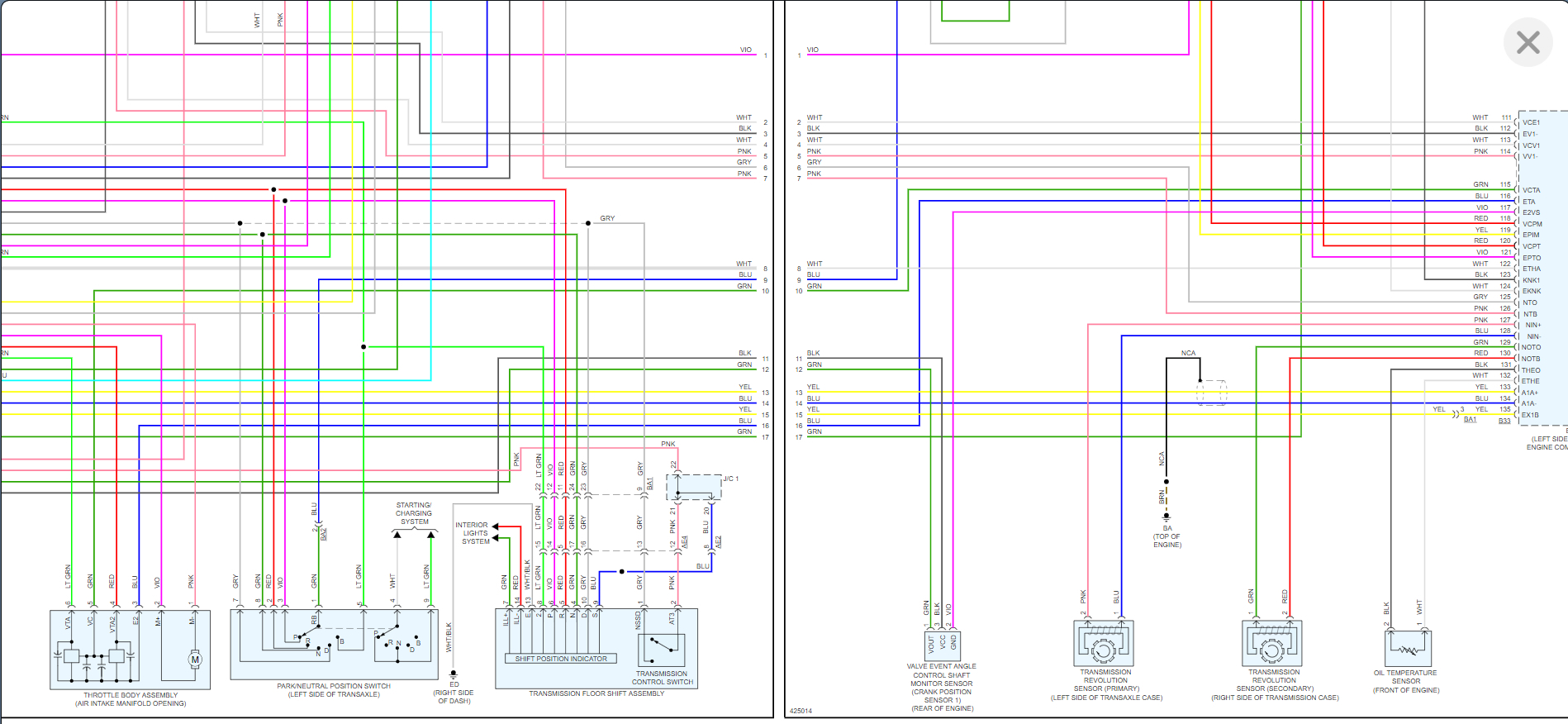

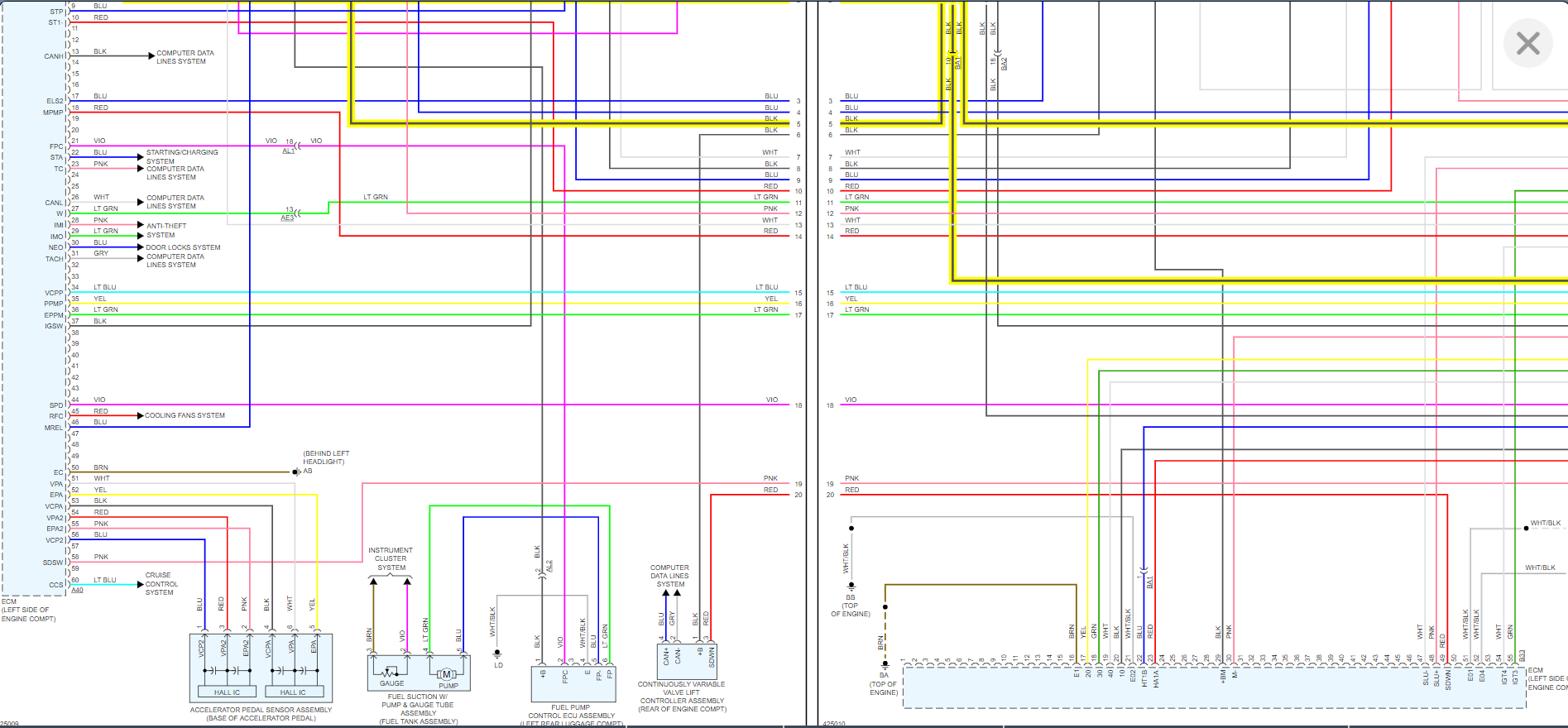

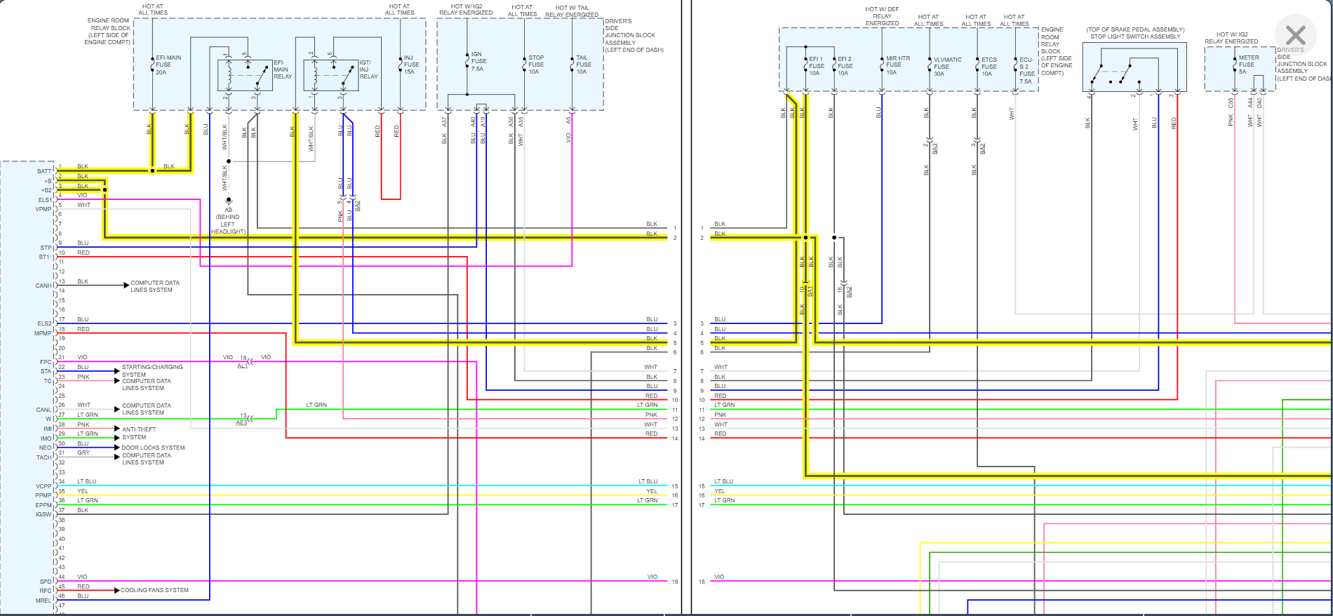

fail to start
2014 TOYOTA COROLLA
90,000 MILES • 0.6L • 4 CYL • RWD • MANUAL
SAMUEL OLEFILE SIBIYA

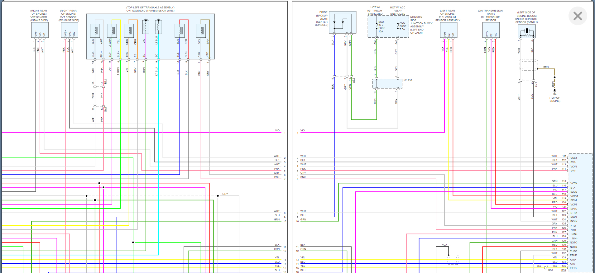

no communication with PCM, security not flashing. I do I check for communication issues?
Aug 11, 2016 at 8:51 PM
Good morning,
Does the check engine light work?
What kind of scan tool are you using? Try using it on another car to see if it works. A lot of times, it is a scan tool.
Did you check for spark or fuel? That will tell me if the ECM is working.

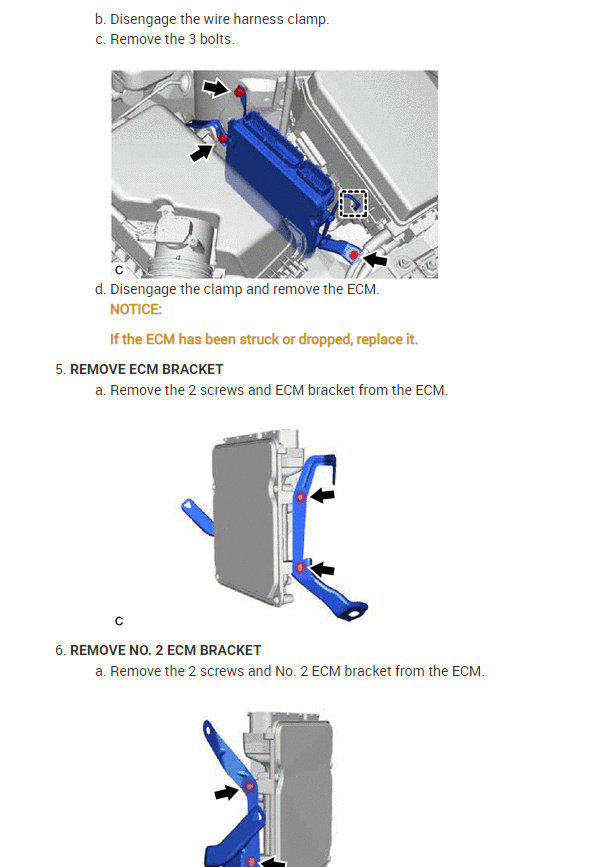

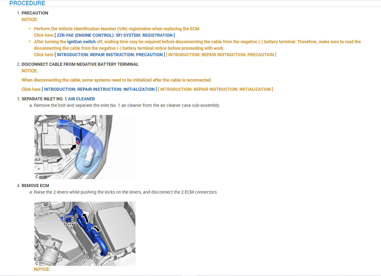

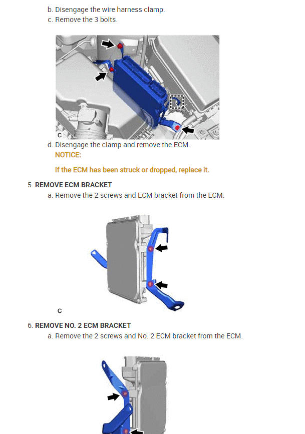

I attached the procedure for the ECM. Make sure the fuses are good with power on both sides.
