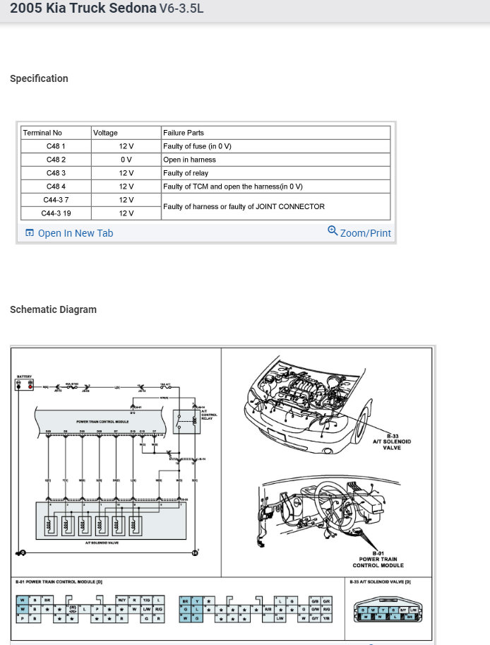

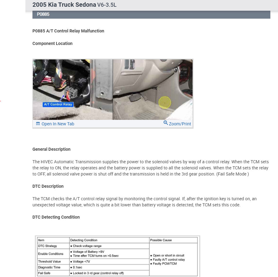

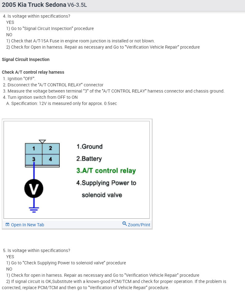

Got subs put in my car and now it’s stuck in third gear. gets the code p0885 which is transmission relay opened. I would like to know where it’s located and if there could be other solutions.
Aug 10, 2022 at 10:25 PM
SQM
  • 6,383 POSTS

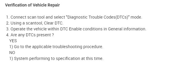

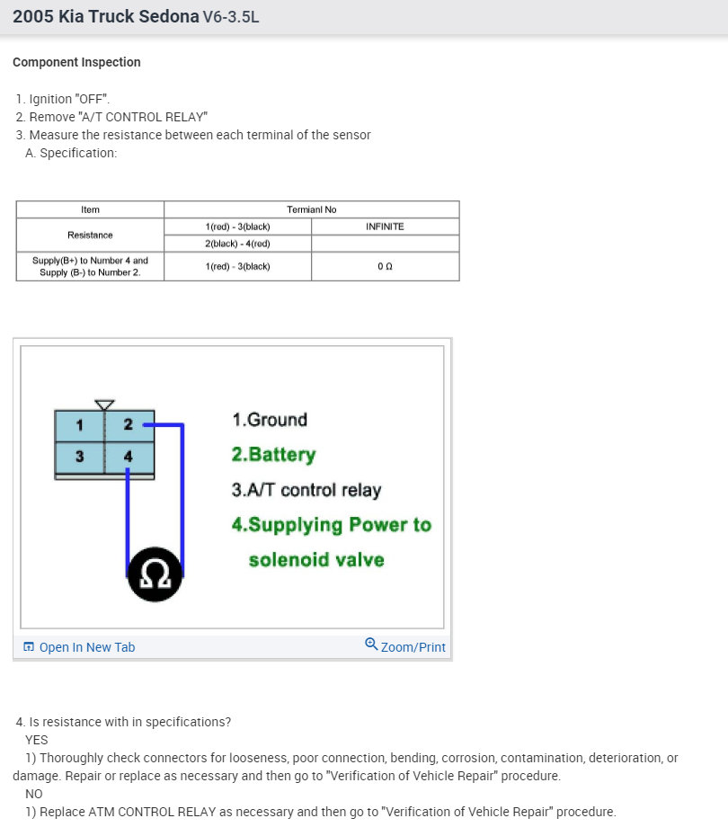

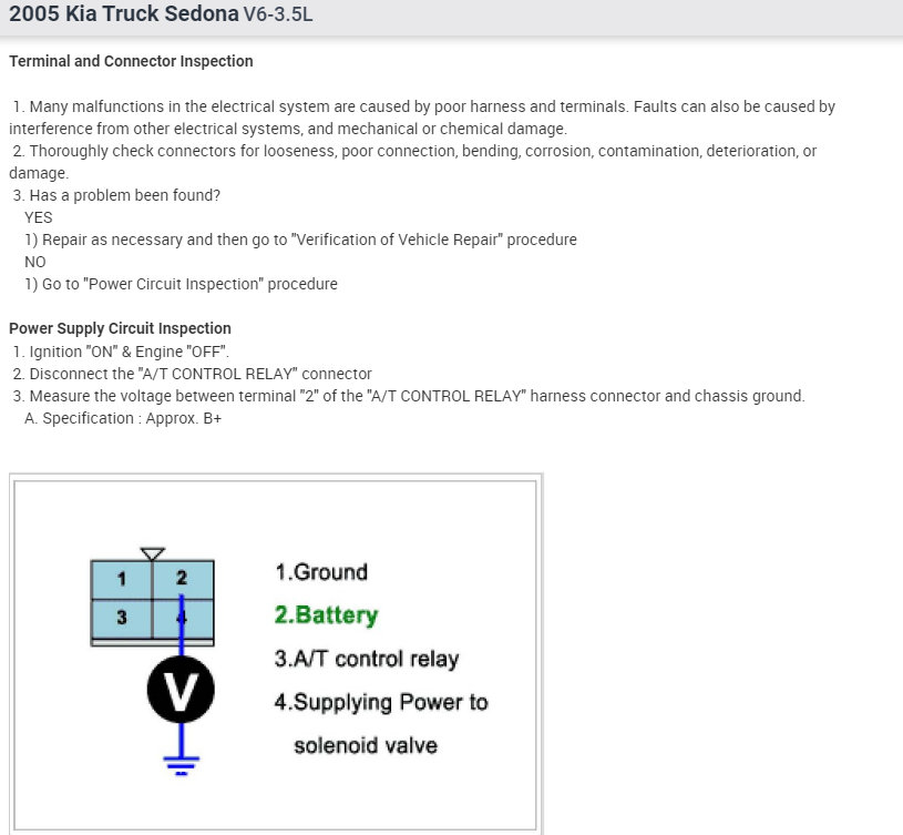

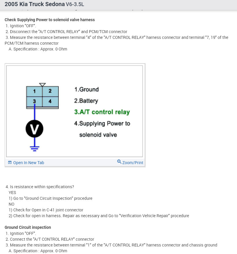

The relay is located under the driver side dash (see diagram below).

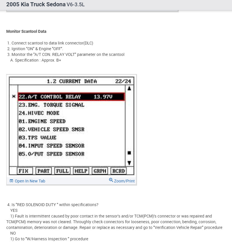

The code P0885 can get triggered due to a bad relay, wiring issue or it could also be the TCM (transmission control module).
I have attached the troubleshooting guide for the code below. Follow those steps as it can help you determine the issue.
Let me know of any questions.

CALEB KELLERBAUER
It’s a minivan, would it still be the same location?
Sep 6, 2022 at 1:45 PM
SQM
  • 6,383 POSTS
Yes. The diagrams does show it for the Sedona.
