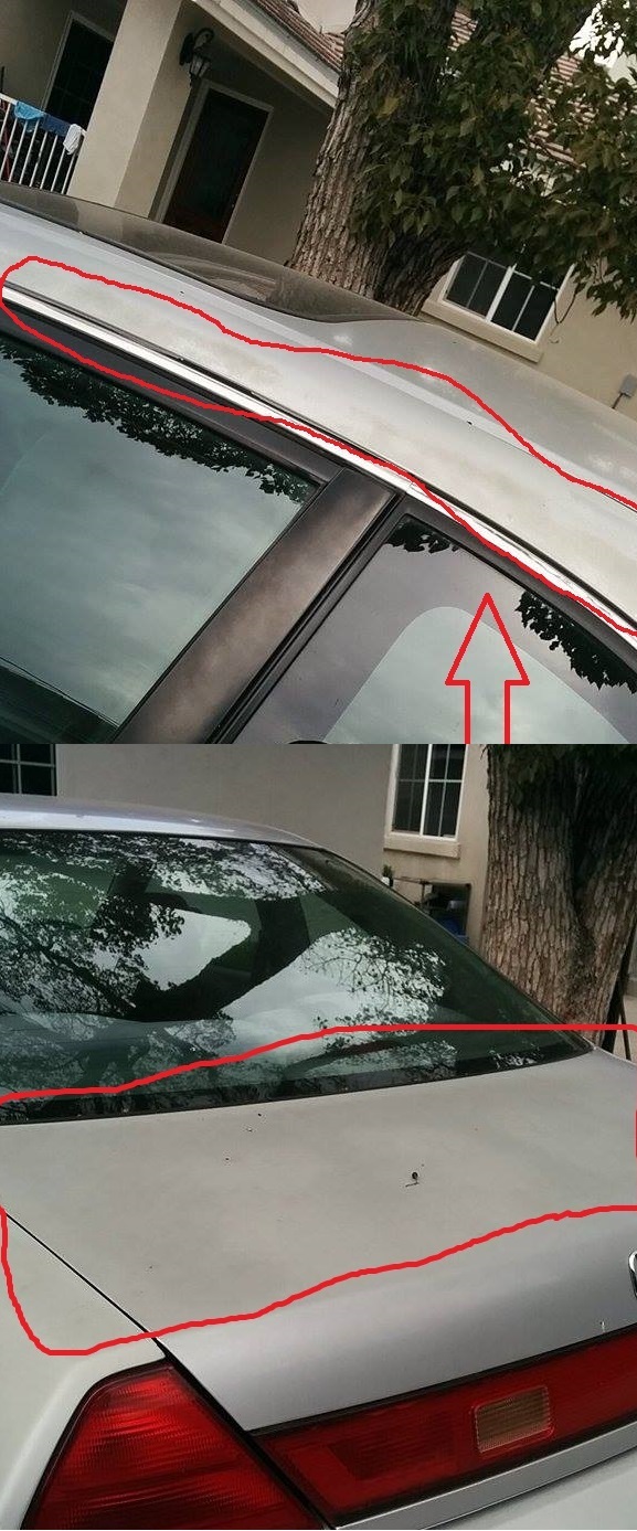

Hello, I am a new teen driver and I recently got a 2001 Honda Accord coupe from another family member as my first car. I was never interested in cars before, I have no experience with cars. I wanted to know what can be done to fix the discoloration on the trunk and the top of the sides of the car. The parts circled in red are not as shiny and smooth as the rest of the car. The pictures should explain a lot. I need to know what products to be bought, please help!

THIS IS THE "CLEAR COAT" PEELING OFF
THESE NEWER RIGS ('80s ON UP) HAVE A "BASE COAT" (USUALLY SORTA DULL WHEN APPLIED) AND THEN IT'S "CLEAR COATED" (WHICH MADE IT SHINEY)
SOMEBODY WITH NOTHING TO DO CAME UP WITH THIS SYSTEM!
WELL, YOU SEE WHAT IT DOES OVER TIME AND IN THE SUN
IF IT HAD GOT A DEEP SCRATCH IN IT WHEN IT WAS YOUNGER, IT MIGHTA TORE THRU THE CLEAR COAT AND DOWN INTO THE BASE COAT, BUFFING WOULD NOT AND COULD NOT HAVE FIXED IT

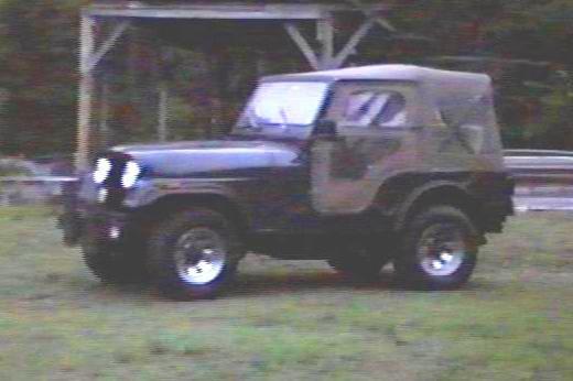

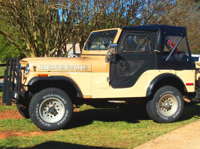

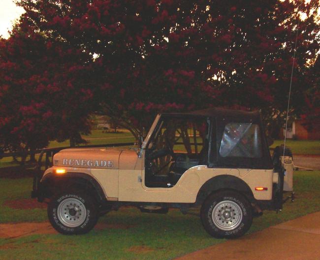

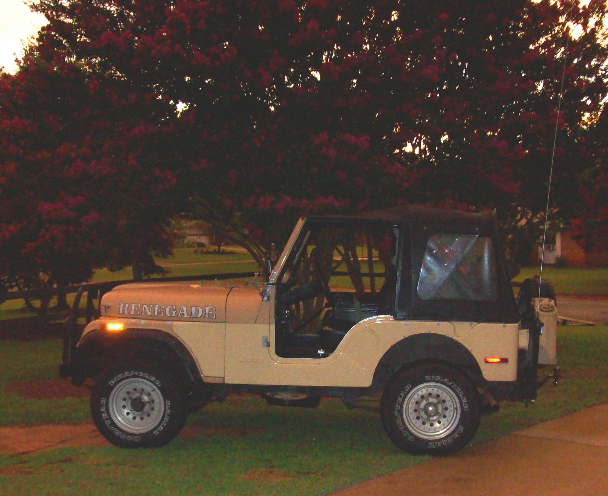

ON MY JEEP, I WAS DOING WHAT I COULD AFTER WORK, WITHOUT MAKING A BIG MESS, AND IN THE GARAGE. BELOW, YOU WILL SEE THE LIGHTER COLOR ON MY CJ-5, EVERY BIT OF THAT WAS AIRBRUSHED ON, THE COLD CAUGHT UP WITH ME, I STILL HAVE TO DO THE DARKER COLOR WHEN IT WARMS UP AGAIN!

Thank you for the quick reply Medic! I'm sorry but I am extremely new to all of this car terminology. Is there an alternative option that I could possibly buy and do myself? It is rather inconvenient for me to go to some type of auto shop. I have a bottle of Meguiars Ultimate Compound and some wax, what would happen if I polished it out with those two things?

WELL IT SORTA LOOKS LIKE THE CLEAR COAT IS COMING OFF PRETTY GOOD!
TO SAVE SOME ELBOW GREASE
TAKE IT TO A DO IT YOURSELF CAR WASH WITH A HIGH PRESSURE WAND
IF YOU'LL GET IN CLOSE AND HAVE A ABOUT $4 IN QUARTERS HANDY, YOU MIGHT STRIP OFF THE ALREADY LOOSE STUFF (AIN'T NO TURNING BACK WITH THE STUFF ALREADY FLAKING OFF)
THEN LET IT DRY AND DO THE COMPOUND AND WAX IF YOU WISH
IT WILL STILL SLOWLY OVER TIME BUBBLE MORE OFF, OCCURRING MOSTLY AT THE EDGE OF WHERE THE CLEARCOAT ALREADY TURNED LOOSE
PARKING OUT OF THE SUN WILL ALSO SLOW DOWN THE FLAKING PROCESS
