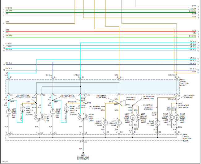

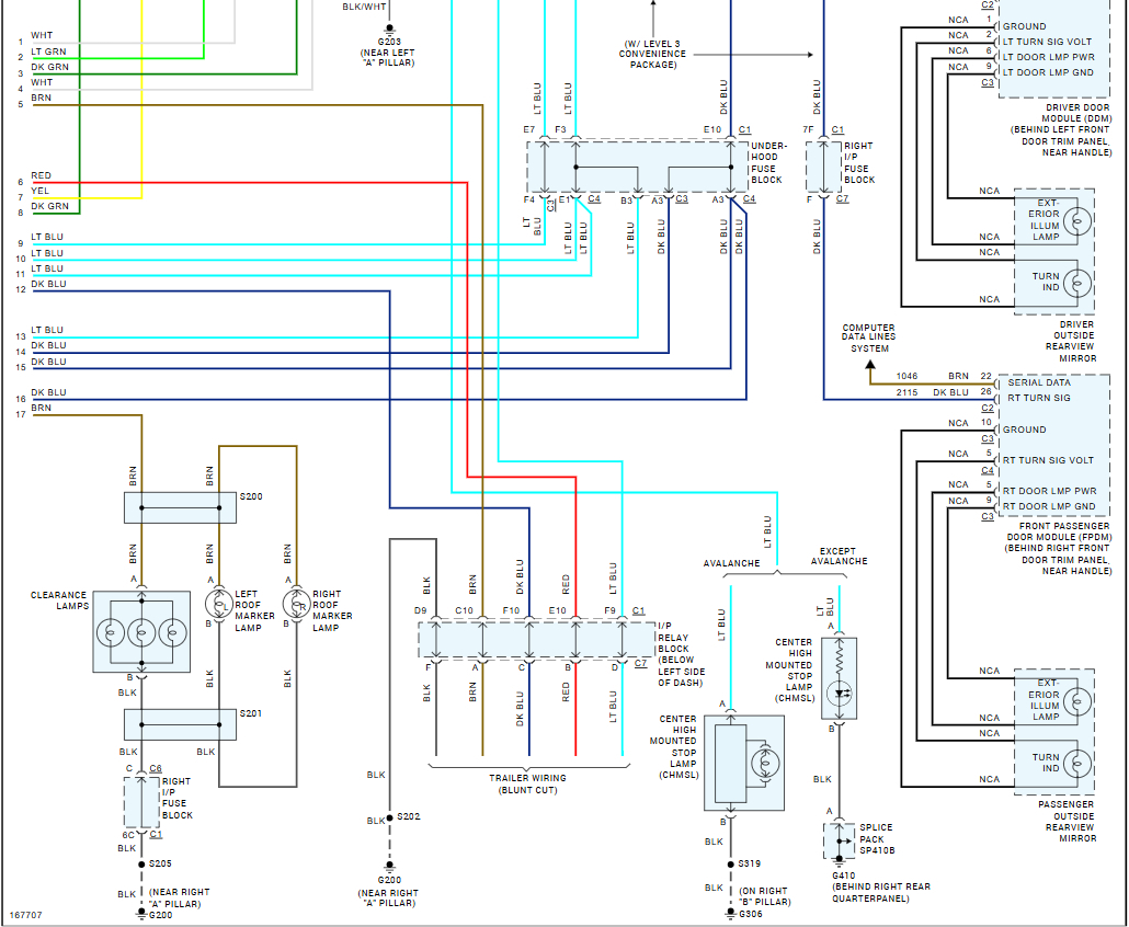

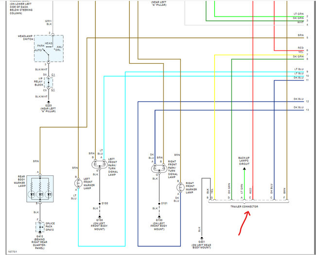

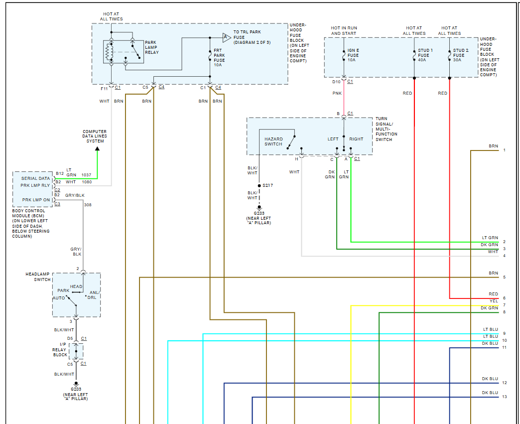

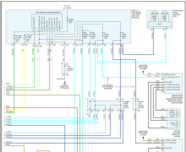

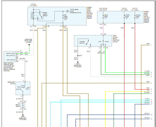

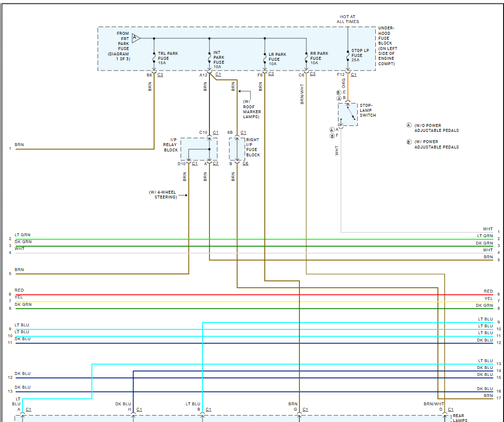

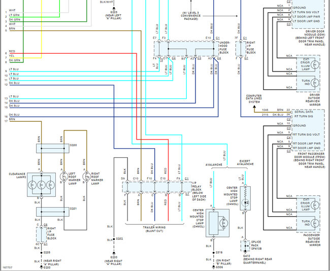

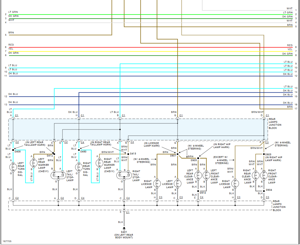

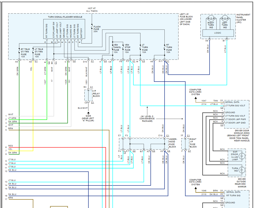

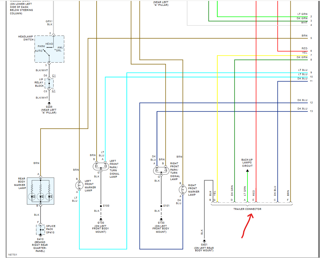

Looking for factory wiring color diagram for 7 pin trailer lights plug for the SUV listed above that doesn't contain a white wire.
Dec 12, 2024 at 8:43 AM
Experienced Mechanic
55,616 POSTS
Sure, here are the trailing plug wiring diagrams for the 7-pin connector:
blk - ground
yel - left stop/turn
drgrn - right stop turn
lt grn - reverse lights
red - power
drkblue - trailer brake power (if used)
brn - running lights
Check out the images (below). Let us know if you need anything else.
