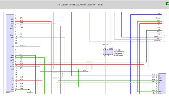

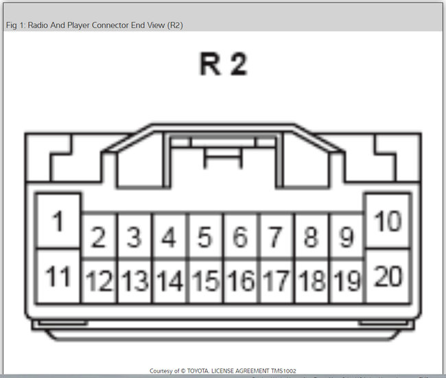

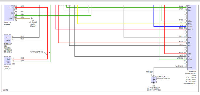

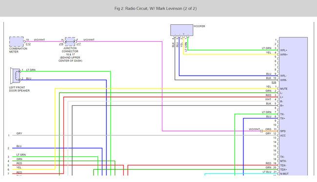

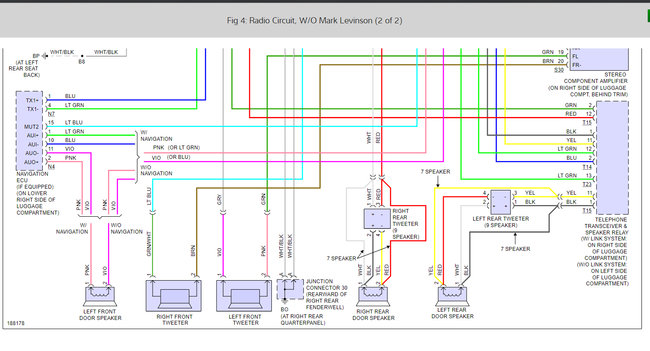

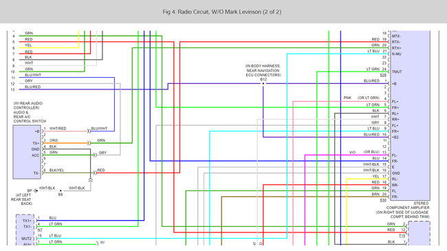

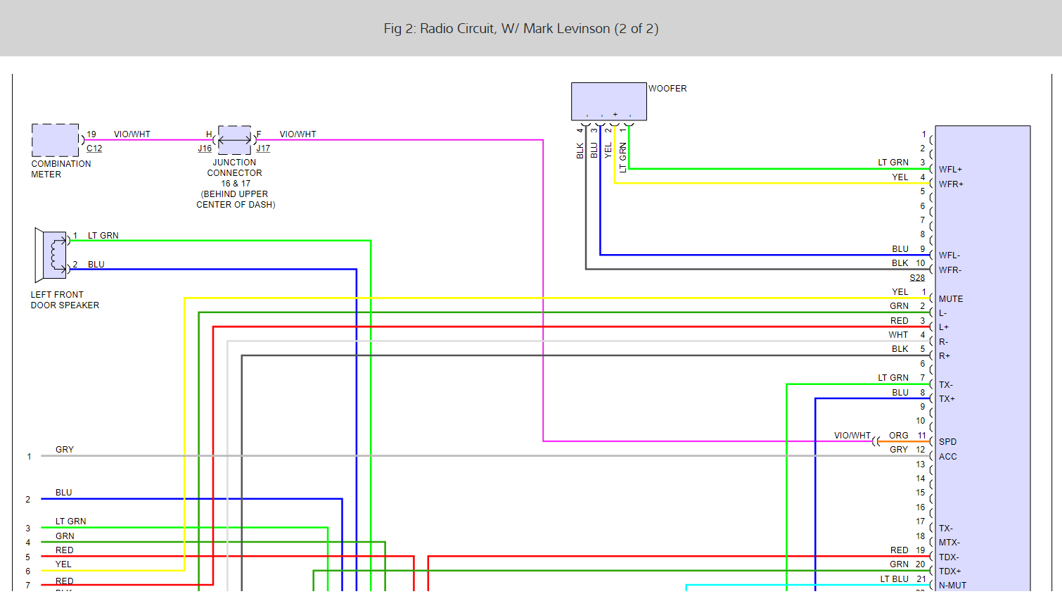

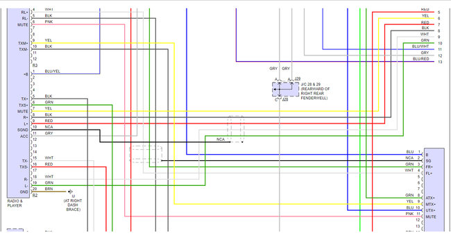

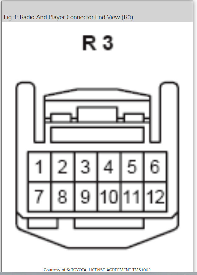

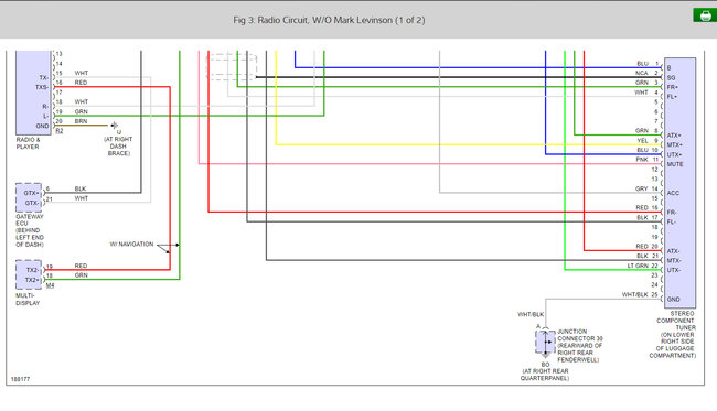

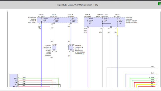

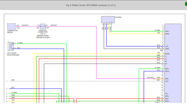

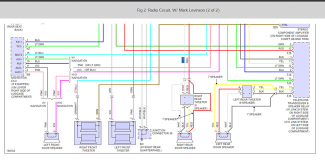

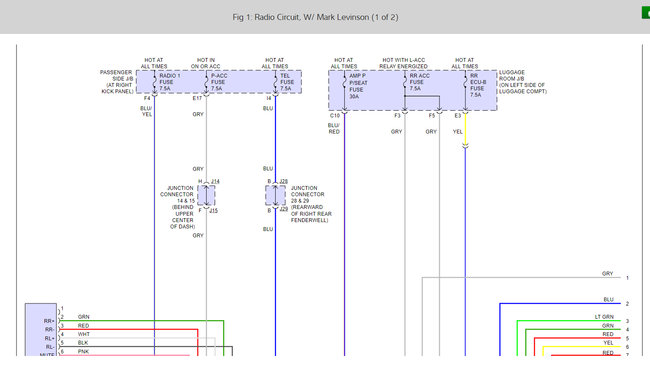

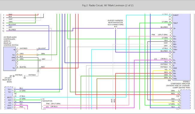

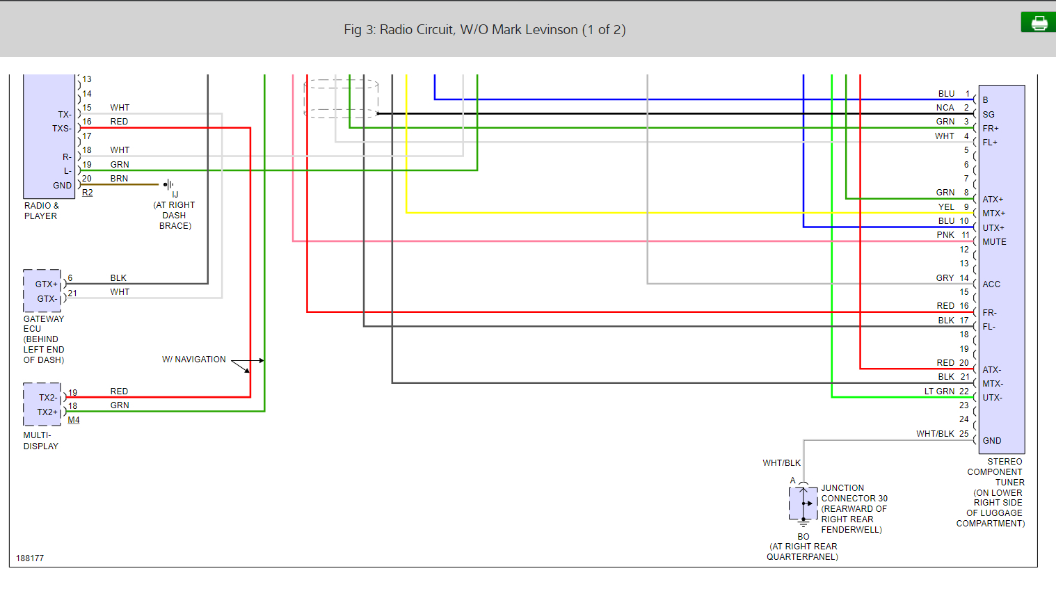

Someone cut out factory harness. I have aftermarket harness that fits clip but color codes are different. Need pinout diagram.
is the diagram presented in an early feed regarding this exact question but for 2002 the same for my 2004.
Mar 1, 2019 at 9:33 AM
SCGRANTURISMO
  • 4,897 POSTS
I have included all the information that you requested in the diagrams below. To use the information, look at the wire on the wiring diagram. Match the number on the wiring diagram to the pin location on the connector end view diagram to figure wire location in the connector. Please let us know if there anything else we can do to help.
Thanks,
Alex
