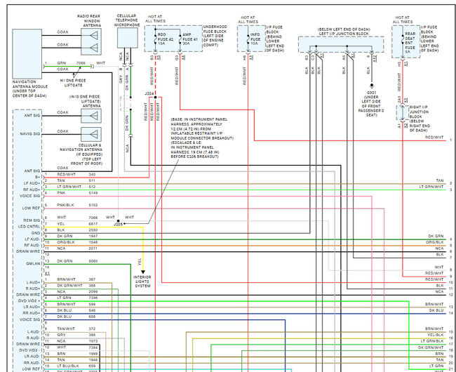

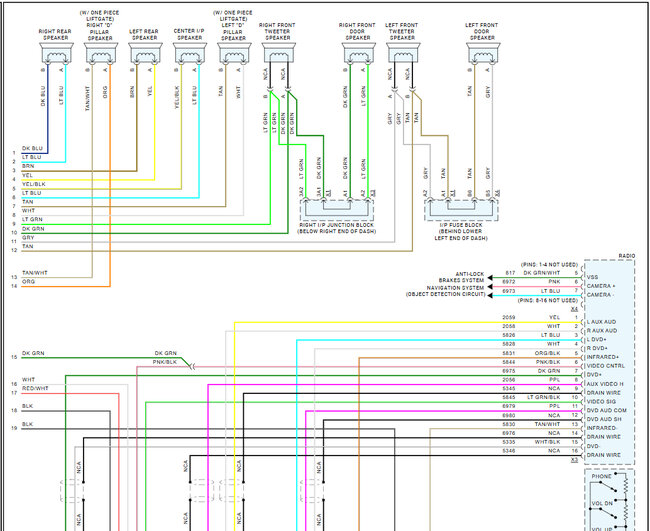

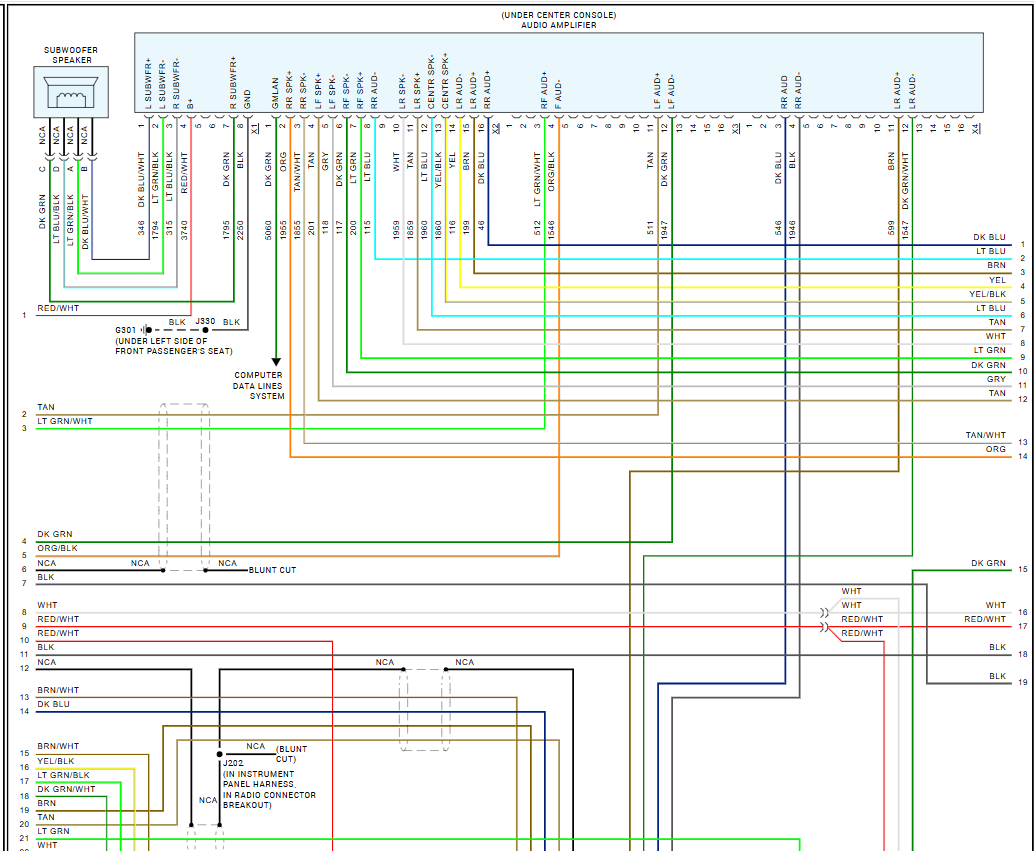

Factory Bose radio wiring diagram needed from the head unit to the harness to the speakers?
2008 CHEVROLET AVALANCHE
215,000 MILES • 5.3L • V8 • 2WD • AUTOMATIC
BRANDON DENNY

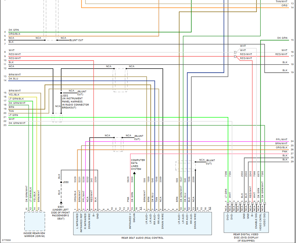

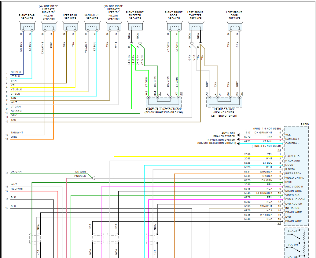

None of the wiring diagrams I’m finding contain the same color wires as the wiring I have in the truck. I just want to make certain I have it all correct.
My truck is the LT model with the basic Bose Radio/CD player. It does not have the screen with the Nav in it.
I’m upgrading the stereo in the truck with a new double-din head unit from Kenwood-DMX957XR. I will also be replacing the 6.5” Bose door speakers. The front will be replaced with the Alpine R-S65C.2 component speakers replacing both the tweeter in the pillars and the 6.5” speaker in the front doors. The rear speakers will be replaced with the Alpine R-S65.2 coaxial speakers.
Thanks for any pictures and or diagrams you could provide.

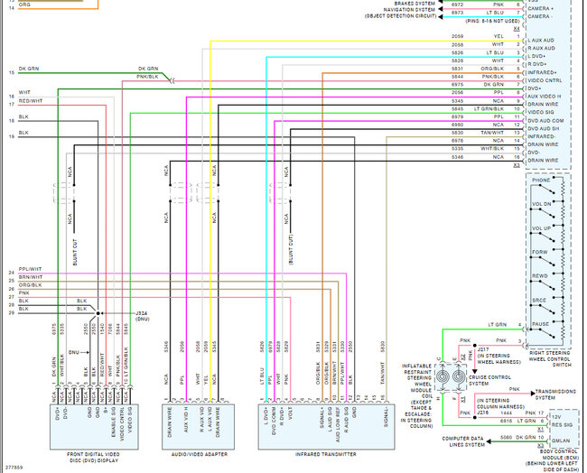

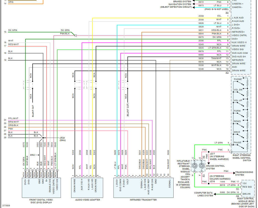

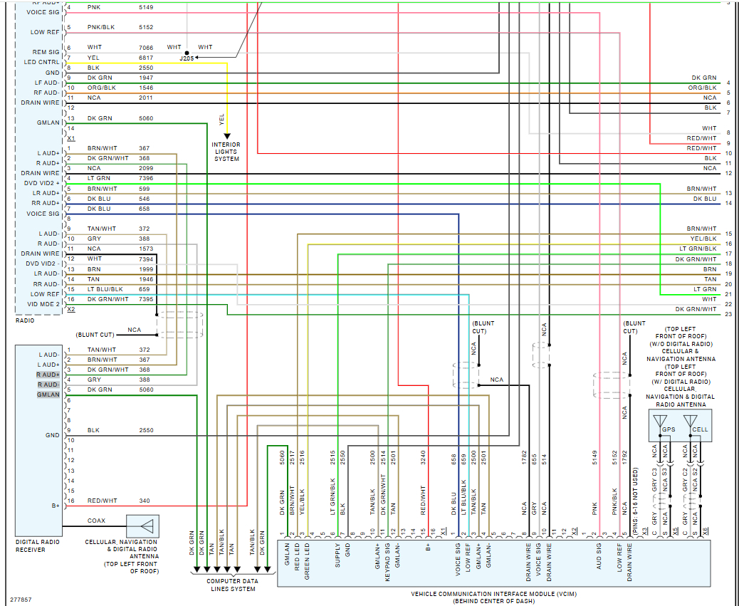

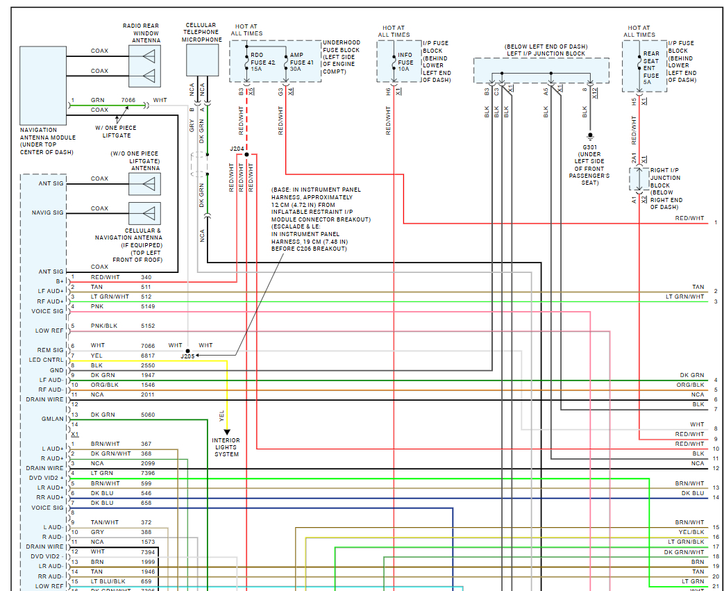

Yep, there are 6 different radios that go in these trucks, l here is the one I think you need, please go over it to see if it works. Check out the images (below). Let us know how it goes.
