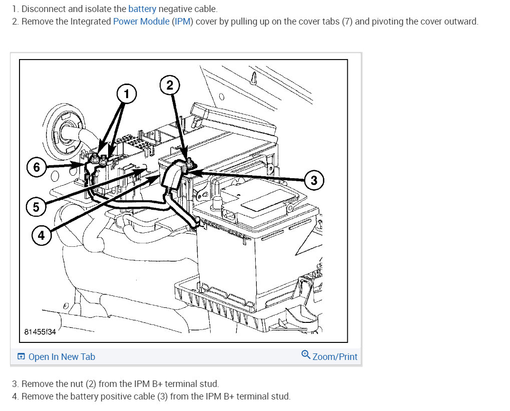

It has a recall on my key ignition and got it replaced and had replaced the vehicles battery I still couldn't get vehicle to turn over. It ran for a couple seconds then turned off. Then it wouldn't start again. I have now replaced and reprogrammed everything from the PCM, Immobilizer, another key ignition and key fob to finally get the vehicle to start and run. But now I cannot get my factory anti-theft alarm to shut off. I have pulled the fuse for the horn so you cannot hear it right now. But when I get in vehicle and start it up and drive down the road, my outside headlights, and all exterior security lights flash for the whole trip. When I park and shut the vehicle off and get out of the vehicle the security alarm will go for about maybe 3 minutes then shut off. How do I get my lights to stop flashing while I drive? Help
Aug 31, 2022 at 6:03 PM
  • 55,732 POSTS

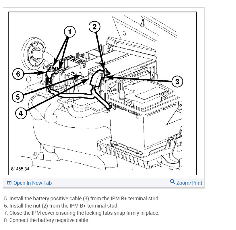

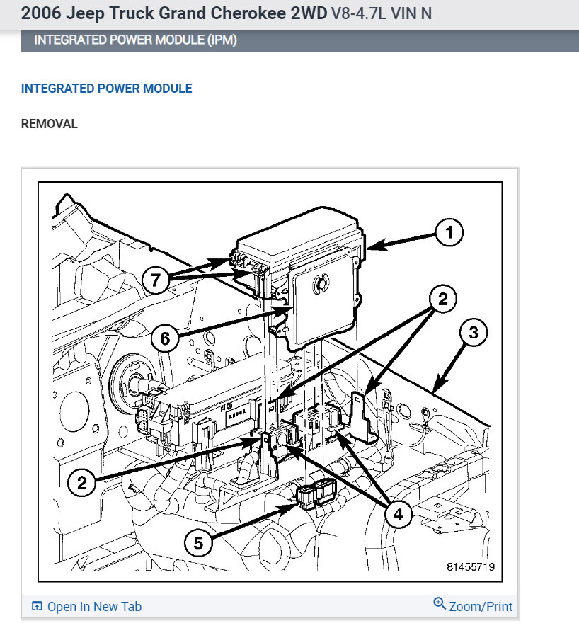

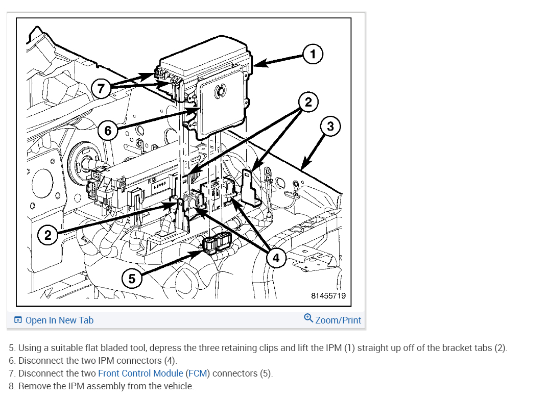

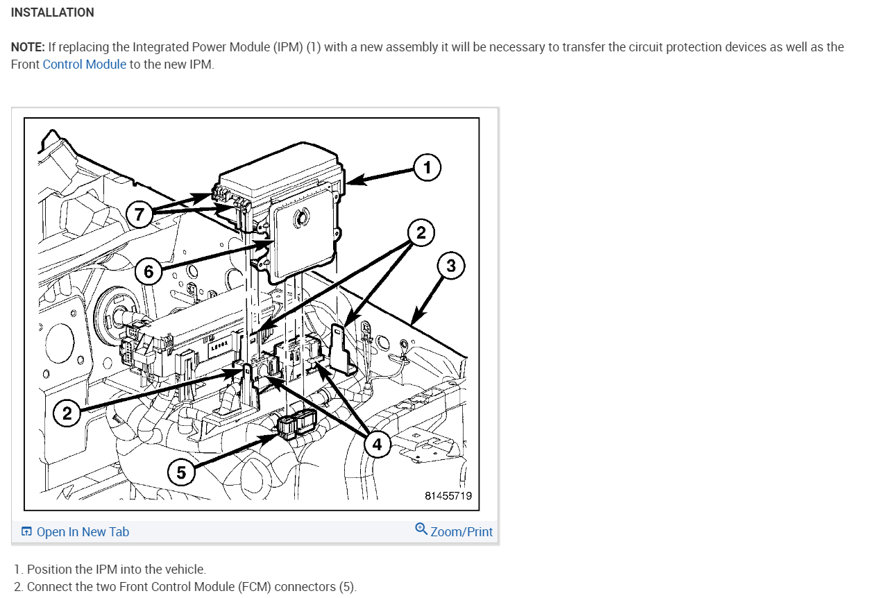

There is an integrated power module that has gone bad which needs to be replaced which is easy to do because it itself-initializes, here is the location and how to replace it in the images below. Check out the diagrams (below). Please let us know what happens.
